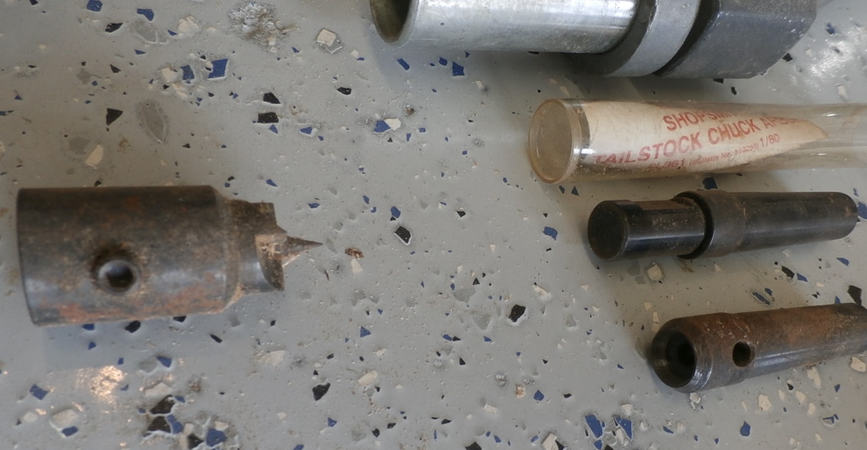

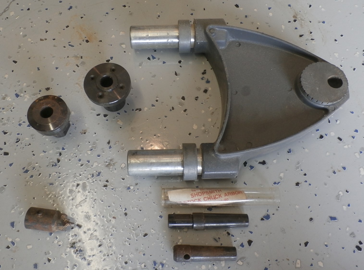

I have the pointy thing that would attach to the head stock, but I'm confused what happens at the other end? I found a couple pictures online of tail stock parts and found a couple likely looking candidates in the totes of parts that came with the rescued ShopSmith. Does anyone have a picture of what the tail stock should look like with a blank mounted?

In your pictures the head stock drive spur is on the bottom left. The dead center that goes in the tail stock is on the bottom right. The stock goes between the two.

The pointy thing at bottom left is your drive center, and it goes on the spindle. The thing at bottom right is your cup center. It mounts to the tailstock, and supports the other end of your workpiece.

The thing at bottom right is missing it's point. You will need to correct that before it will become useable.
Re: Lathe and Molding Head questions
Your dead center, (bottom left, correction should read bottom right ), is missing its point,
Probably better to buy a live center to replace it. The mounting hole in the tailstock is #2 Morse Taper, which is very common on lathes.
rpd wrote:Your dead center, (bottom left), is missing its point,
bottom right
Right you are.jsburger wrote:rpd wrote:Your dead center, (bottom left), is missing its point,
bottom right
