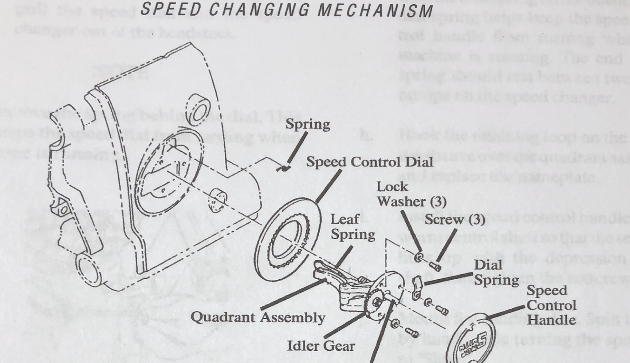

Your sequence and procedure puzzles me.
The high speed adjustment does not require pre setting the belt position on the motor pulley except as a rough initial setting.
Setting the high speed stop is performed with the speed control installed into the headstock.
"Fingers wrapped around the outside of the dial thing" makes no sense. The knob should be turned, not the speed indicator ring.
The speed indicator ring is NOT directly connected to the speed controlling parts. It is merely rotated by an idler gear that is rotated when the knob is turned.
You DO have a KNOB?
Perhaps some pix will reveal something that is amiss.
As for filing the quadrant gear teeth, when done you should be able to easily turn the 1/4" shaft with finger pressure(out of the headstock). The worm gear does need to be centered on the quadrant gear.

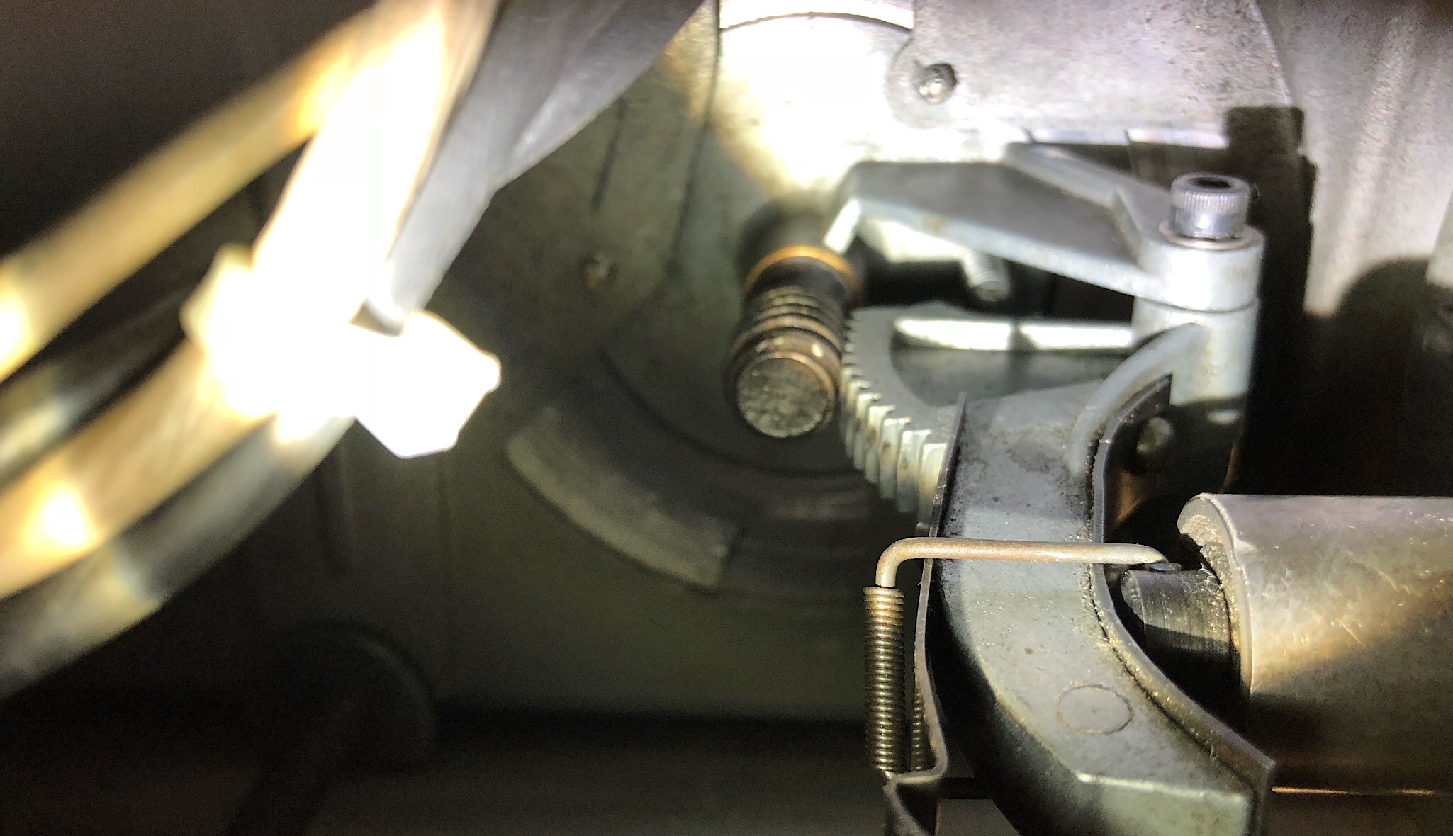

Please recall I rebuilt this machine and all the shafts are smooth and the bearings turn freely. This pic (see the last one below) is from a Shopsmith document, Appendix E, Maintenance and Troubleshooting and is my reference.
When I said I wrapped my fingers they were wrapped around the Speed Control Handle not the Speed Control Dial. It took so much force to turn I was afraid to use the little knob for fear I’d break it.
See below for some pics.
About filing the quadrant- initially when I removed the unit and hand-turned the worm shaft there was some slight binding at the point where the mechanism would be positioned for the lower speeds. With the filing the mechanism now hand-turns smoothly. So while the teeth are now filed the SS binds up just like it did before they were filed.
I’ve gone through this repair seven or eight times with the same result. I’ve used a tach and I’ve used the manual process to adjust the speed control. The last time which I described was done manually. I set the drive belt at the 1/8” point and the quadrant at the high speed stop as part of this manual process. Since I had had the speed control out to clean it, I set the quadrant against the stop per the same Shopsmith document (para 28f).
Unless I loosen the belt by spreading the motor sheaves allowing the idle sheaves to close the speed control will not lie flat against the casting so I can fasten it.
Is there any more info I can give you that may help this process? Thank you for responding.

I notice you have installed the tension pin fix/bent legs. The worm gear appears to be centered on the quadrant gear.
Since you indicated that filing the teeth made the control easy to adjust(out of the headstock), I have to assume the hard to turn is being caused by something else. Do realize a very miniscule interference between the worm gear and the quadrant gear teeth will create this problem.
I would remove the belt and check for binds etc. with the control installed with only the motor belt missing.
I would also make sure the floating sheave is free to move(pull it out by hand, but do not let it slip and bang the sheaves together).

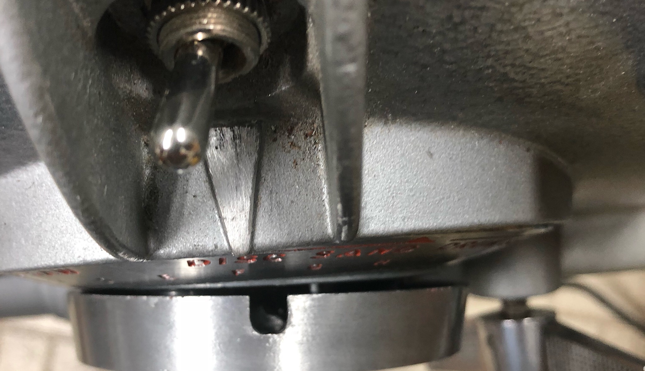

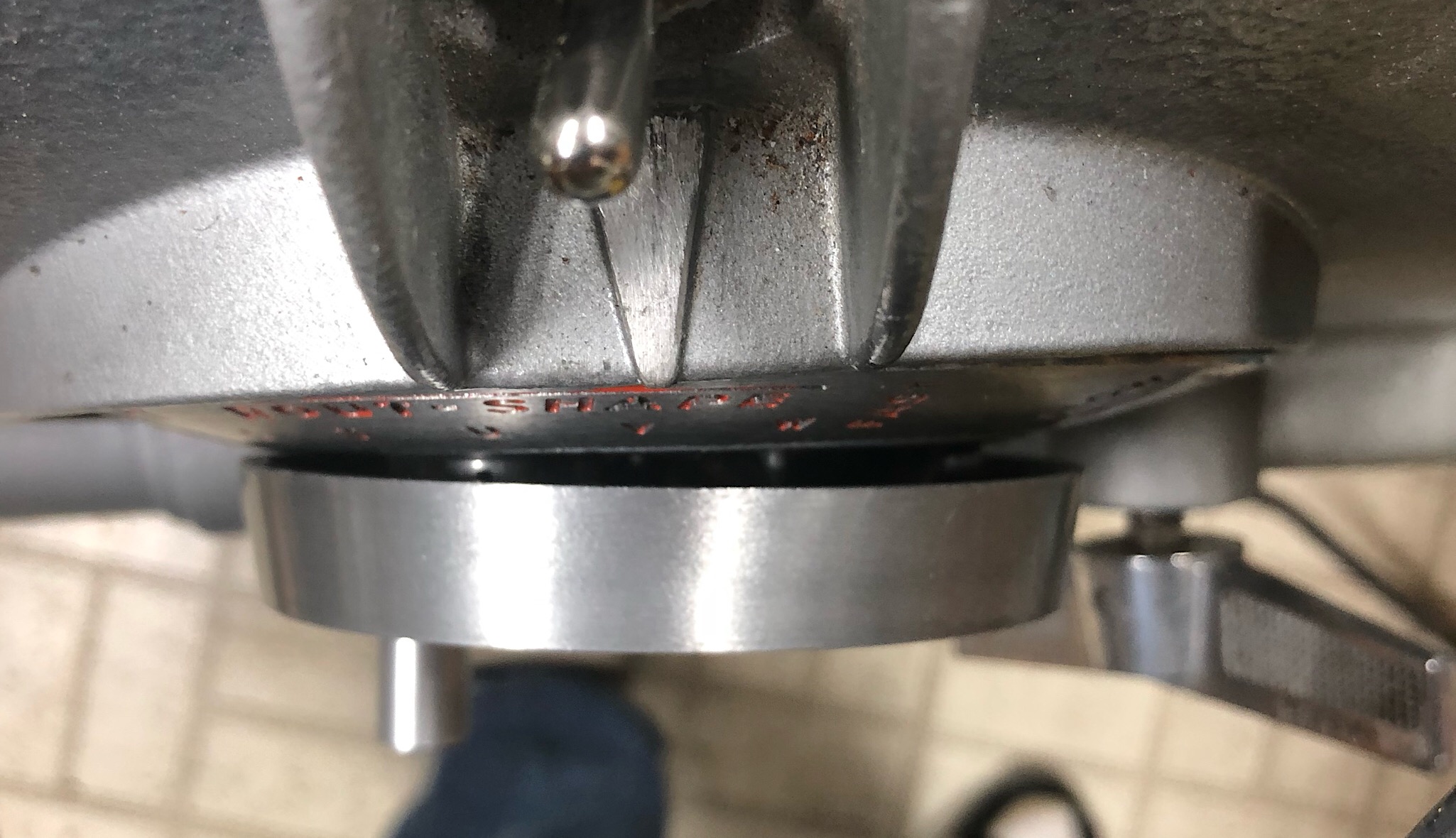

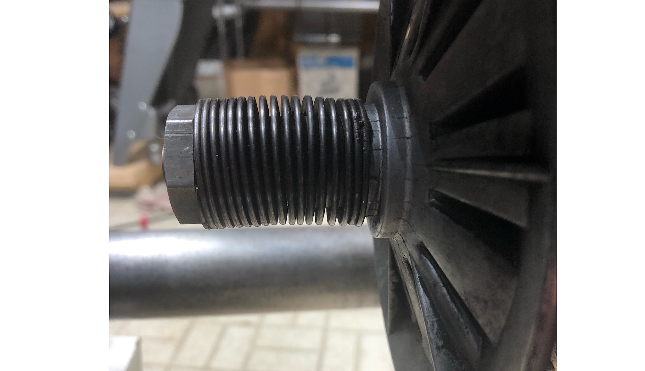

Just for fun the following pics show the physical alignment of the speed control handle at “V” and “F”.
I can pull the motor sheaves apart with my hands and the spring appears to compress and expand without any problems.

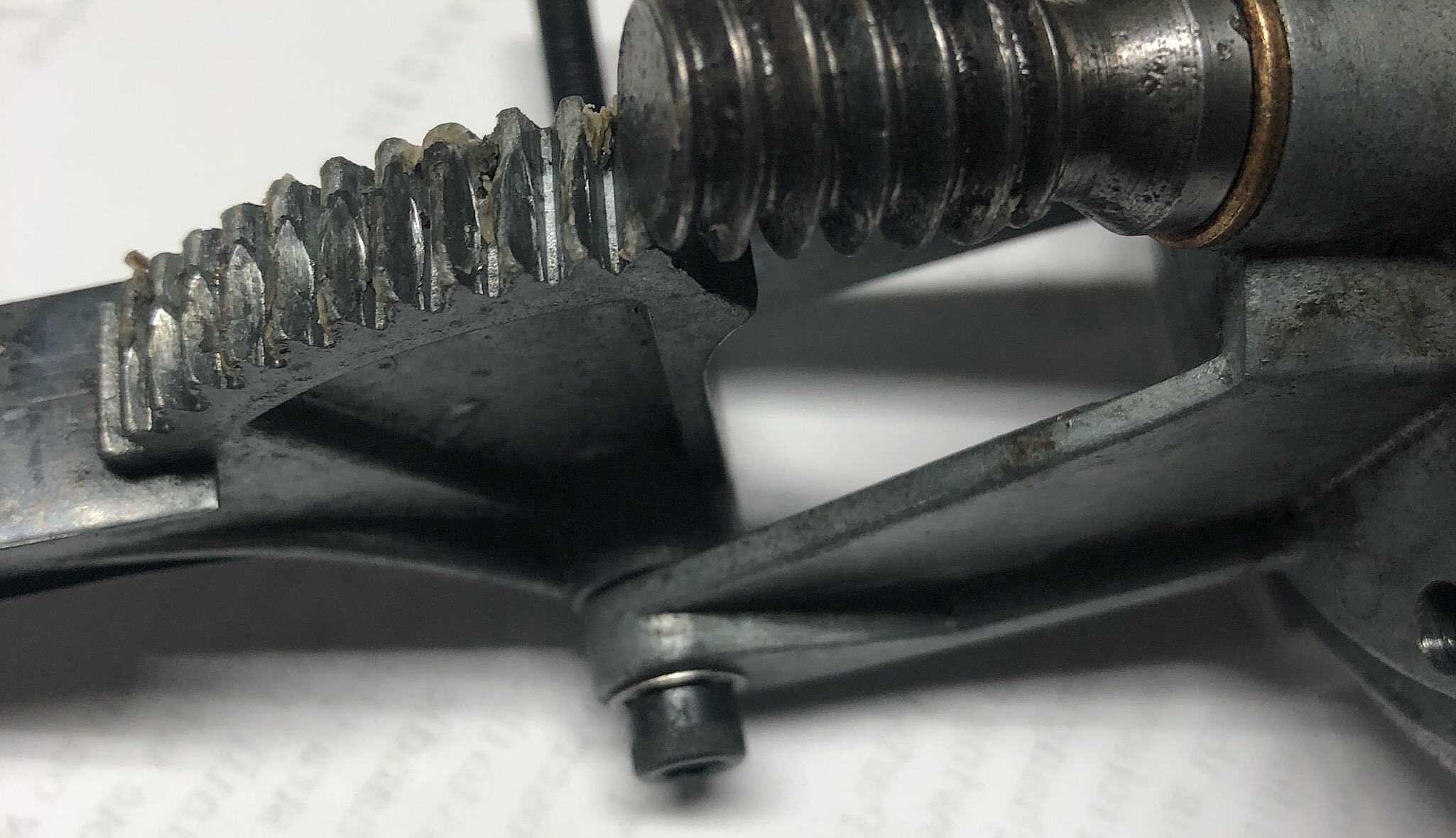

I still believe the quadrant is part of the problem. The worn marks on the teeth go from center to one side and if now re-aligned so the worm gear travels down the center could be causing the bind. In the new pictures I am wondering why the Control Handle is not mounting even. Is something else bent?
Re: Request Help with Speed Control Issues
We need to determine why the knob is crooked. Is the worm gear shaft bent? Is the speed control base mounting to the headstock correctly(not skewed).
I think a pix face on with the knob removed may provide clues. Also pix of the quadrant gear and the control sheave match up.

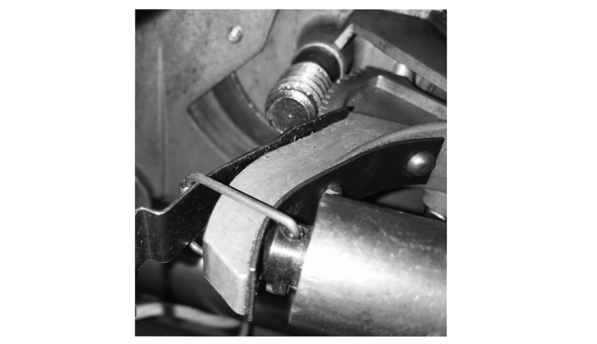

Before I talk about the pics I must tell you about the latest development. I’ve had the speed control off and on so many times I’ve stripped the screw hole at the 3:00 position. I’ve repaired it and put in new screws. I don’t know if this issue played any part in my original problem.

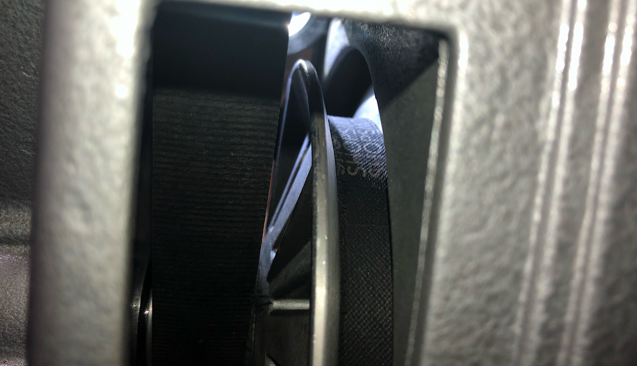

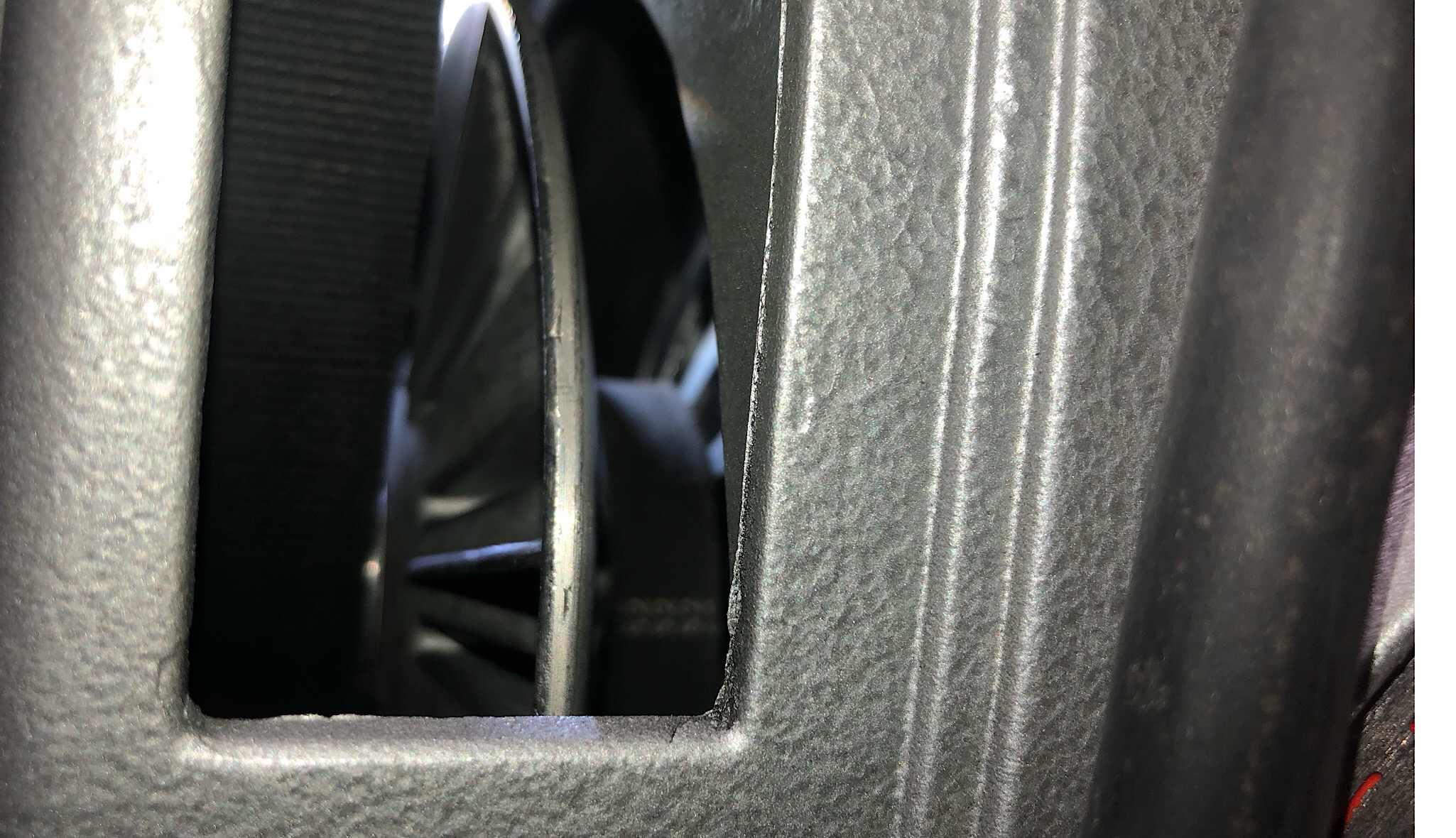

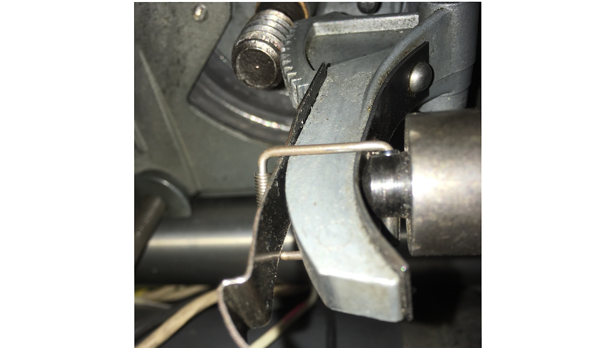

The first pic shows the parts in the high speed position. The second pic is from the slow speed position.(see below)
The third pic shows the spring in the slow speed position. The next two pics show the belt position on the idler sheaves at the high and low speed positions. Please remember the “slow speed position” is at about “F”. (see below)

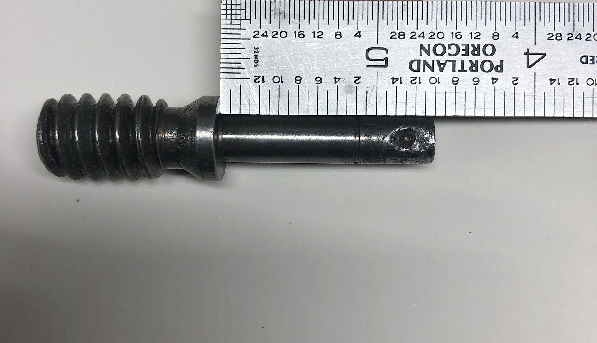

The sixth pic shows the worm shaft which appears straight. (see below). I rotated the shaft several times with the same result.
I’m sending a second post showing the quadrant.
