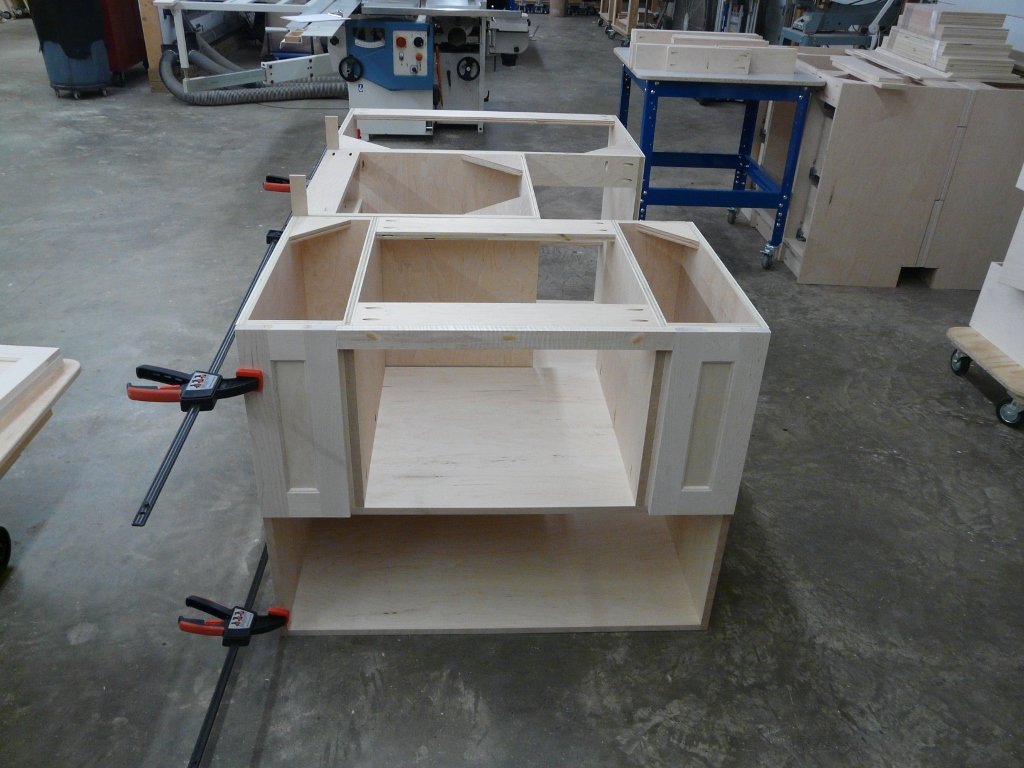

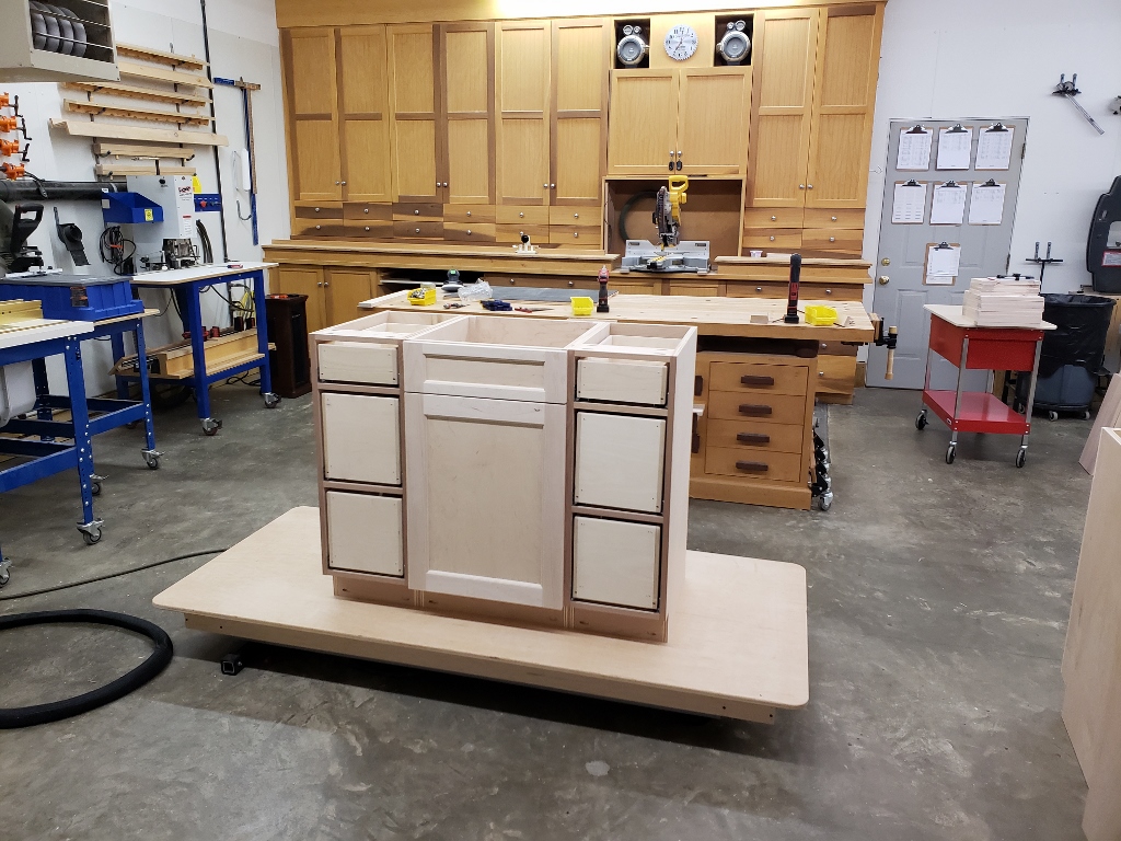

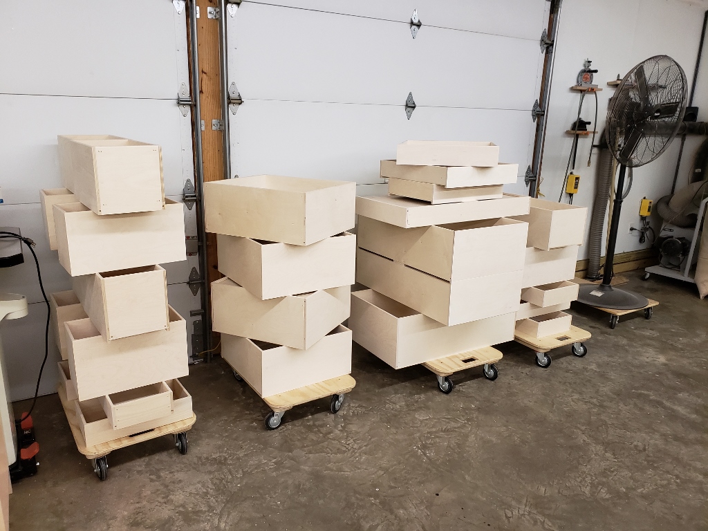

- 20181025_164928 (1024x768).jpg (399.97 KiB) Viewed 17494 times

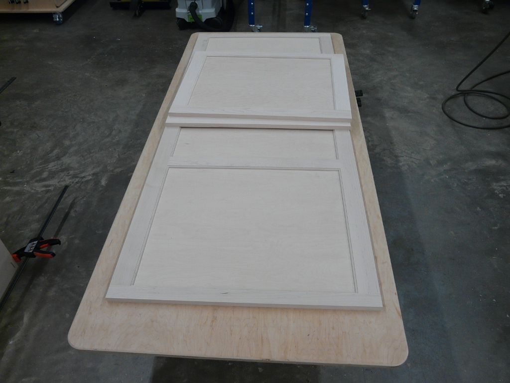

That's a lot of drawer boxes!
- 20181025_190052 (1024x768).jpg (463.53 KiB) Viewed 17494 times
I'll get rid of 12 of them on two vanities.
- 20181025_190101 (1024x768).jpg (294.42 KiB) Viewed 17494 times
But that's it for today. I'm on overtime!

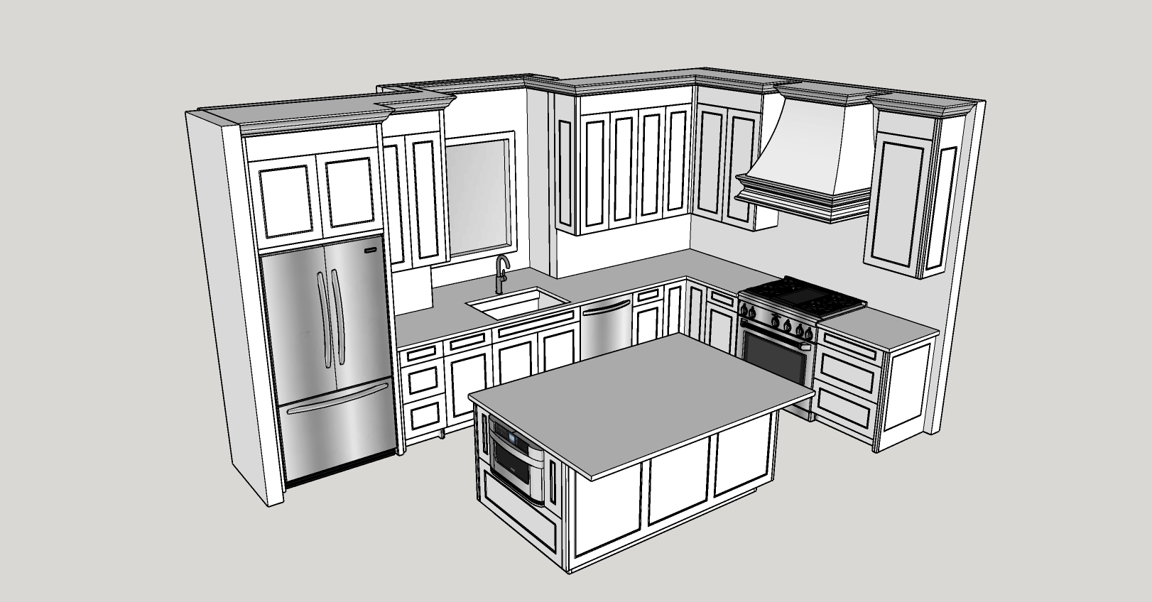

I am about a week into this project but that includes design and Sketchup modeling time.

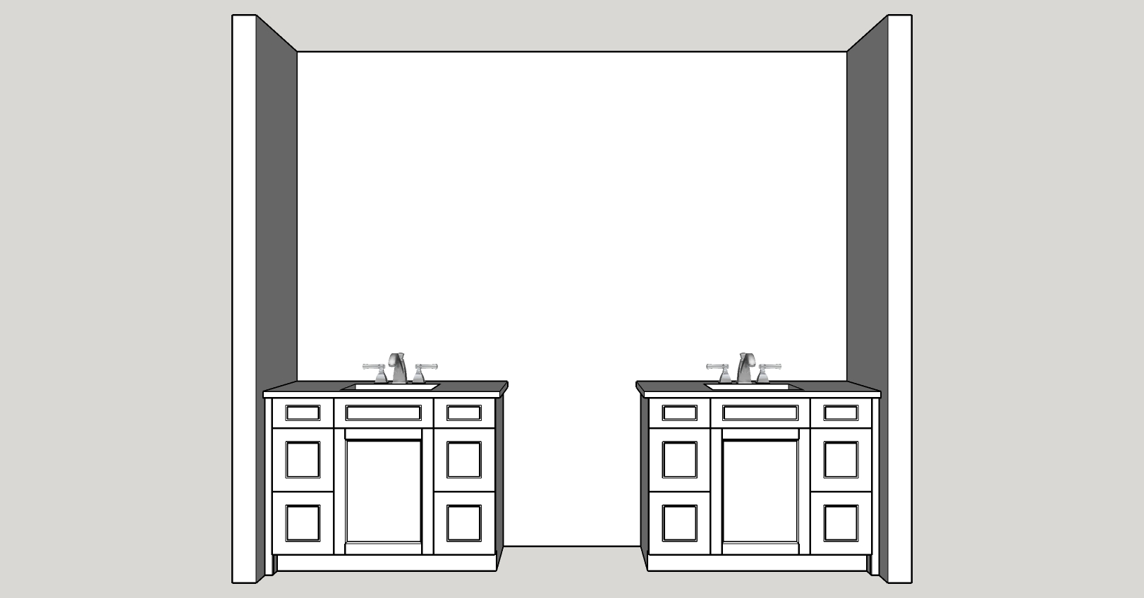

- Bath Vanities.jpg (101.46 KiB) Viewed 17427 times
- Kitchen.jpg (406.9 KiB) Viewed 17427 times

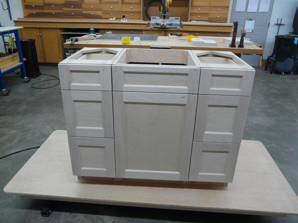

- 1.jpg (394.64 KiB) Viewed 17369 times
Finished up the 2 vanities.

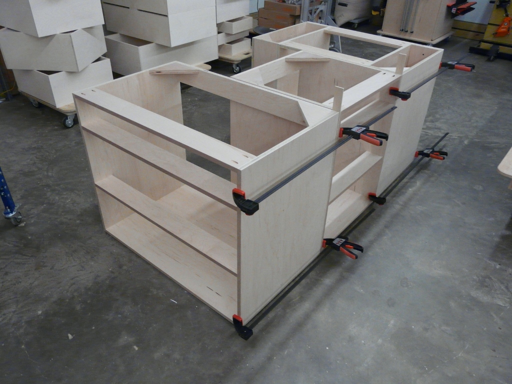

- 2.jpg (383.61 KiB) Viewed 17369 times
Started on the island.
- 3.jpg (422.33 KiB) Viewed 17369 times
- 4.jpg (342.26 KiB) Viewed 17369 times
Time to make up the back and end panels.

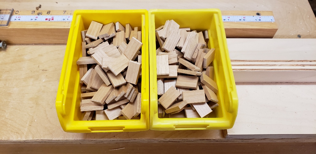

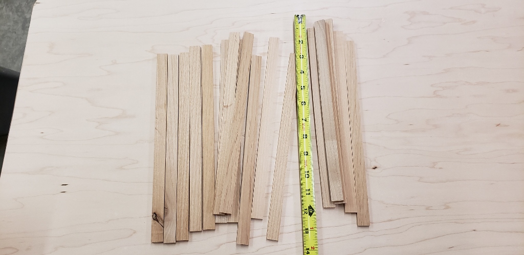

I use a lot of Festool domino's in my shop and a lot are basically for alignment when attaching face frame components to cabinet components. The traditional domino is great invention but with one major design flaw. That being that they are blunt on both ends making alignment of some parts difficult especially when trying to align something 4 feet long or longer. Also at close to $100.00 per box I have taken to making my own.
- 1.jpg (234.62 KiB) Viewed 17319 times
I start with stock that I have run to 5mm thick x 5/8" wide. Length is not that important but I find something around 12" works best.

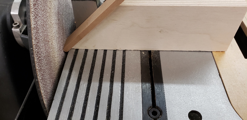

- 2.jpg (357.93 KiB) Viewed 17319 times
I have this miter gauge set up with a simple block cut at 45 degrees. I lock it down into the miter gauge slot on the Mark 7.

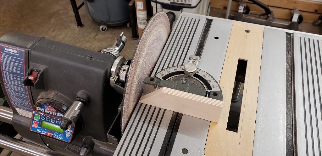

- 3.jpg (336.71 KiB) Viewed 17319 times

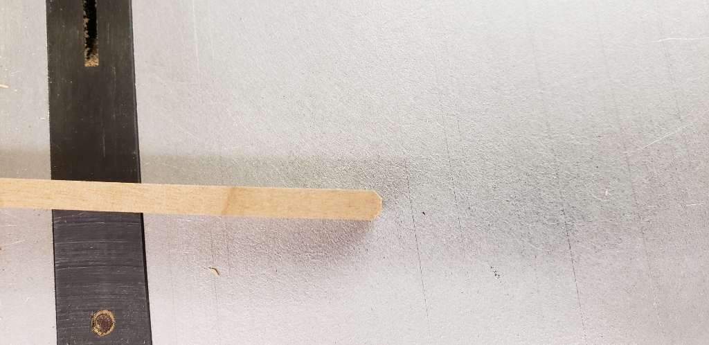

Then spinning at 500 RPM's i chamfer both sides and both ends.
- 4.jpg (325.62 KiB) Viewed 17319 times
The result is an end that looks like this.

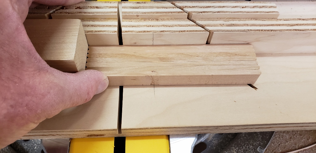

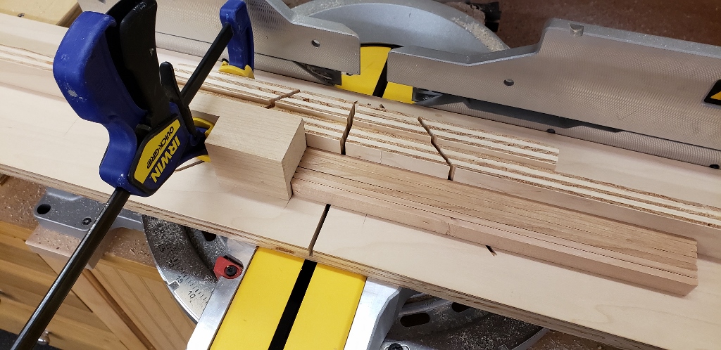

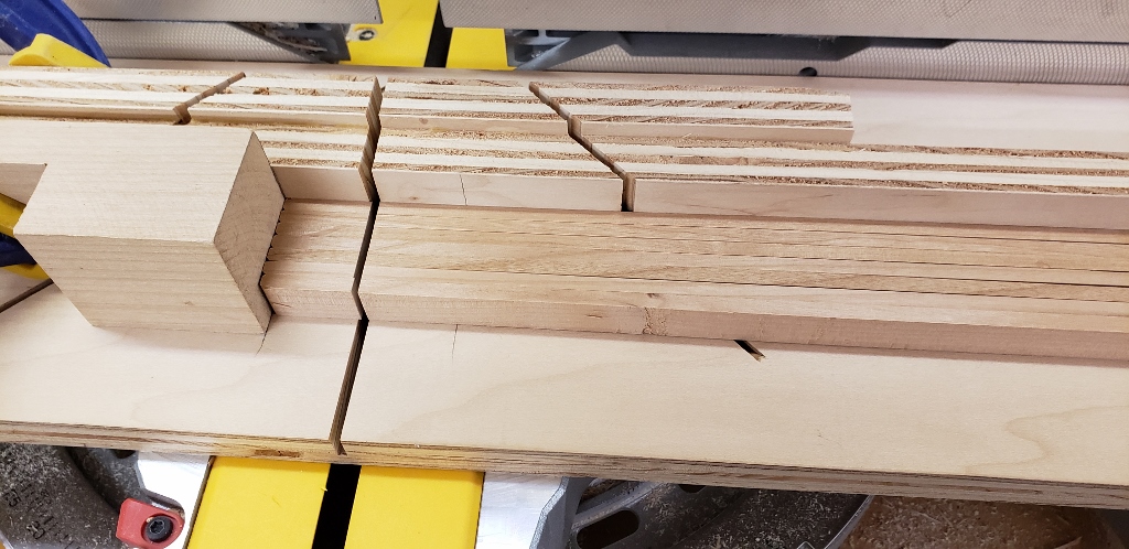

Then using a zero clearance jig on the chopsaw I cut them to length 7 at a time.
- 6.jpg (296.12 KiB) Viewed 17317 times
There isn't any room for error when holding them tight to the fence.

It doesn't take long to make up a few hundred. They are blunt on one end but chamfered on the other. I install the blunt end into the work piece first and the chamferd end really helps the alignment process.
