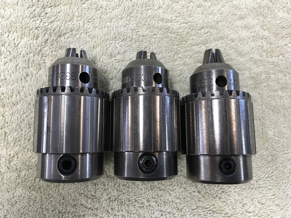

Shopsmith Drill Chucks 101
Depending on how you count them there has been 5 different drill chucks supplied with the Shopsmith Tool dating back to 1947. The first was the Jacobs 33B which required an adapter to attach to the spindle since it attaches with 1/2" threads. It was replaced by the Jacobs 3326 which has a 5/8" smooth bore to attach directly to the Shopsmith spindle. All following Drill Chucks for the Shopsmith have the same 5/8" smooth bore attachment. The 3326 first came with a 3/8" set screw hole than later a 5/16" set screw hole, sometime after the introduction of the Mark 5 in the 1950's. Since that time all drill chucks have had the 5/16" set screw. The Jacobs Multi-craft chuck was the one supplied starting in the 1970's and was replaced, for a short time by the Cushman chuck in the 1980's. The first reference I have found to the current Drill Chuck was the Fall 1988 Catalog. This chuck that looks like the Jacobs Chuck 3326 has been the one supplied since.
As John said
There is only one caveat with the Jacobs chucks discussed here. The 33B, 3326 and the Multicraft are all 1/2" capacity but they all only go down to 5/64". If you really regularly need precise holes at 1/16" (unlikely) the Jacobs won't work.
The Cushman chuck has the same capacity as the Jacobs chucks. Only the current chuck has a capacity that is less. I use one of the current chuck regularly with out issue, not because of the small capacity, it is just the one I use. I have at least one of each of the Drill Chucks supplied for the Shopsmith's. One additional thing to consider if you use a Mortising attachment than the Jacobs 33B on the adapter will not work and neither will any of the ones for sale at the online auction site using adapters.
As I said at the beginning there are 5 different Drill Chucks depending on how you count them. Below is the 3326 Jacobs Chuck, note the set screws for the three variations.
3326 Chucks.jpg (355.12 KiB) Viewed 14638 times
This is probably more information than you wanted to know about the Drill Chucks supplied with the Shopsmith over the years. Consider how you will use your drill chuck and pick the one that does the job the best. If they all do the job pick the one you like.

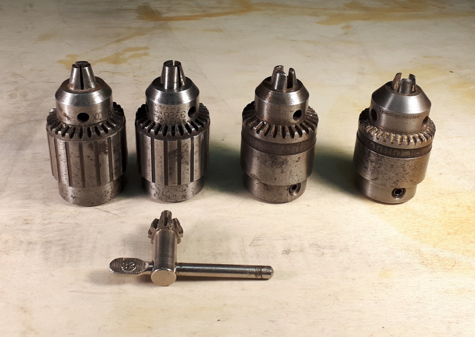

The MC8K26 chuck is the one on the right in this picture.
drill chucks.jpg (319.94 KiB) Viewed 14610 times
I understand supplying a chuck with a unit that you are selling.
I do find that having more than one drill chuck is handy when doing different operations on a project. Like drill then counter sink. It is faster to just swap chucks with different bits than to change the bits. :cool:
