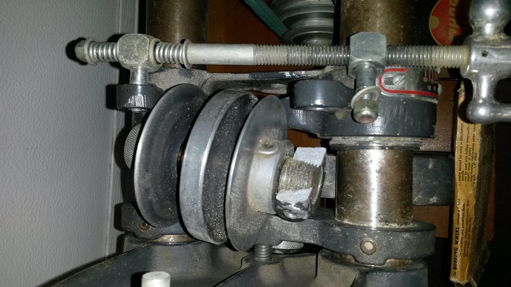

Here's some photos of the Speed Changer. The post on the left was welded on to the ring. And the outer ring with the post was completely replaced. Someone did a pretty good job on the repair. The problem is there is some slop between the replaced outer ring and the existing inner ring.

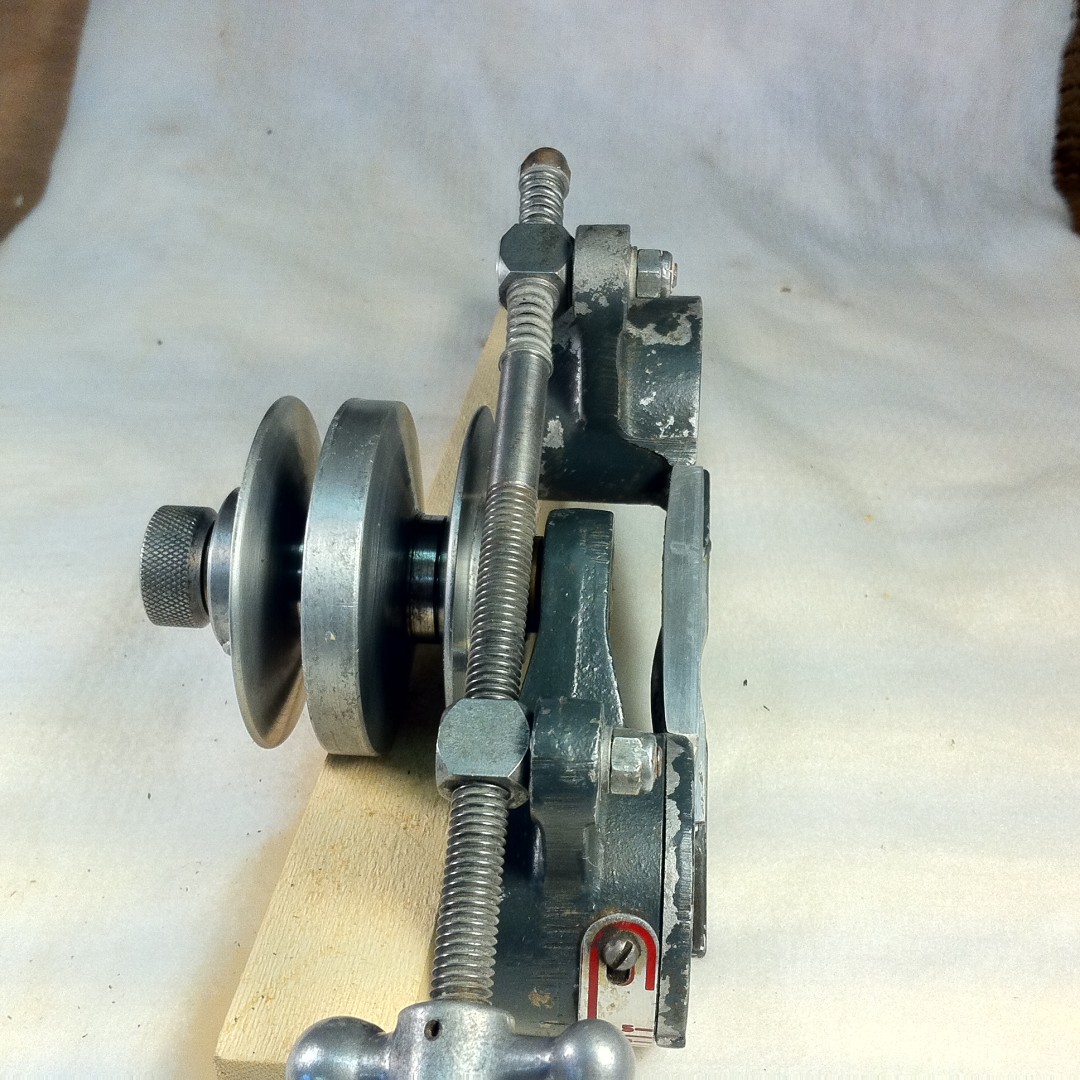

Someone machined a whole new pulley arm besides "welding" the "dog ear" back on the base. It makes me wonder what the broken pulley arm looked like. The "dog ear" breaking off and the base broken in half are the most common damage I have seen on the speed changer. The dog ears are broken by turning the screw assembly to far. The base is broken in half by over tightening the nut that holds it to the headstock and it not moving with the headstock when re-positioned on the way tubes. I have had one broken pulley arm but do not know what caused the damage. The person I bought it from didn't know as he had bought it that way.

Someone had skills to remake that part. :cool: I wonder if the slop could be taken out with a thin shim, (pop can aluminum maybe)
Also, although the early speed changers were shipped with the crank mounted on the right side of the ears, on the later ones it is mounted to the left. This gives more clearance between the crank and the headstock lock lever and avoids interference. :)

I was not able to repair it but was lucky enough to find that part for sale and replaced it. It sits in a box with a broken base piece that again I was lucky enough to replace when I bought a 10ER with a speed changer that had a broken ear that had been repaired but also had a replacement base part. I have found with enough patience most parts will show up for sale sometime.
