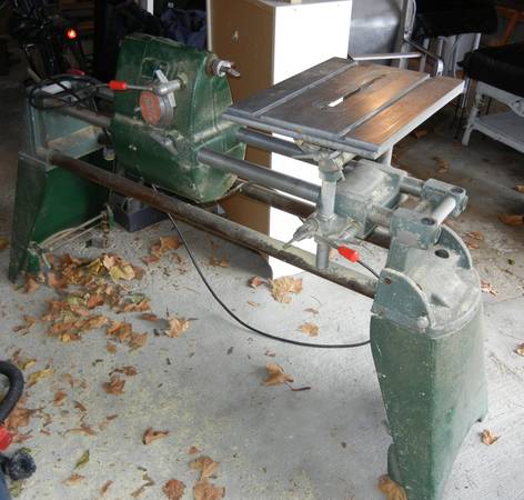

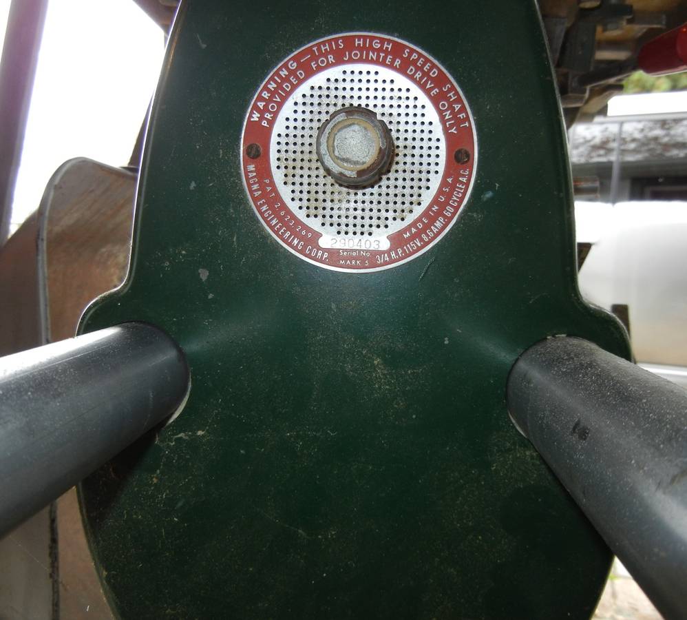

this SS confuses me the serial number says 1979 but the motor says 3/4 hp thought all after 62 were 1 1/8 hp also it is green even though someone could have painted it that way

Serial number is not from 1979..........
1955 288541 - 316978

The Mark 5 Serial Number you show is a Mark 5 "Greenie" made in February of 1955. The one in your picture has had the headstock painted a different green than it's original colors. The "Greenie" as it is commonly known was the first Mark 5 and they were introduced in March of 1954. They continued until the color was changed in 1960 to the Goldie paint scheme. Many changes occurred to the headstock in the early years. The belt and related drive parts changed from the Gilmer to the Poly V drive still in use today. The motor changed from the 3/4 HP to the 1-1/8 HP motor. A few other changes were made to and inside the headstock. More recently new Table/Fence systems have been added to the Mark V. The 510 has a larger table and added floating tables to increase the work space. The 520 changed the fence to the Pro Fence on the larger table system. It is the same Table/Fence system used on the new Mark 7. The original Mark V table/fence system became the 500. The Mark V 505 is the 510 without the floating tables.
Backing up in the Shopsmith tool line to the original Shopsmith the Model 10E followed by the 10ER. They were made from 1947 to 1953. They provide the same functions as the Mark 5 or V. All Shopsmith tools were made to last and will with proper care and maintenance. I have one of the very first Shopsmith Model 10E's I restored and even at 71 years old it runs like new including it's 1940's motor. Find that kind of lasting quality on other tools.
I am not trying to sway you on which Shopsmith to buy. Try to figure out how you think you will use it. What features will work best for you. Look to what you may want it to do in the future. Then check your budget on what you can afford. Remember you can upgrade the Mark V anytime. I have a Mark V 520 that I upgraded to a Mark 7. Even the Greenie in the picture can be upgraded to a Mark 7 but it will cost you more than buying a new Mark 7. You have already taken the best step in buying a Shopsmith - finding out about them.
