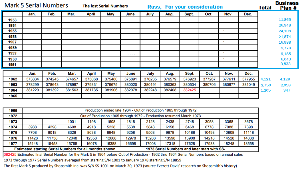

I have been working on estimating the missing Mark 5 Serial Numbers. These include 1962 to the end of production for the Mark 5 in 1964. These Serial Number dates of production are based on the Shopsmith sales by year. Hopefully they are close. The 1973 through 1977 Serial Numbers are simply averaging the number of units made for the time period. They will be less accurate but an approximate for those years.

This would have your Goldie being made in October of 1962. Is that close?
For those who may not have it, below is the Mark 5 & Mark V Serial Number chart Shopsmith had on this site with estimated numbers for the missing months I did some time ago.

I estimated the last Serial Number for the Mark 5 made by Magna American Corporation to be 382425. If anyone has a Mark 5 from the 1960's with a higher number please let me know. It could help make this list more accurate.
Looking at the original list put out by Shopsmith it does not have any Serial Numbers listed before April of 1954 which is 263051. We do not know how many Mark 5 tools were made before that date. I know of no record stating the starting Serial Number for the Mark 5 by Magna Engineering Corporation. The lowest Serial Number I have seen is 260407. That Mark 5 could have been made in February or the very beginning of March (based on the number of units made in April and May).

I have updated the lost serial numbers list. With the information Everett has provided. I changed the starting date of the Mark 5 production by Shopsmith Inc. to March 20, 1973 as found in Everett's research. Remember this is still an estimate of when these units were made and could vary by several months. As before the 1973 through 1977 Serial Numbers are simply averaging the number of units made for the time period.

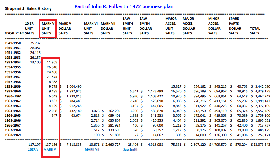

Actually we do have an accounting for machines produced 1953-1954, just not serial numbers. It came from John R. Folkerth's 1972 business plan.
Actually we have production numbers for calendar years 1953 - 1965 for the Mark 5. Not specific serial numbers by month, but total machines sold. In the later years they were building to fill orders, not in anticipation of orders.
From a Post I wrote titled: More Shopsmith History and some more questions.... I may be able to fill in some information.
Within the thread I had the production numbers for the 1972 business plan that John R. Folkerth and his backers submitted in procuring financing for Shopsmith Inc. to resurrect the company and production of equipment. http://www.shopsmith.com/ss_forum/viewt ... 05#p249505
The business plan was very specific in numbers of machines produced in each year beginning 1949. 1947-1948 numbers were not produced suggesting the MAGNA production records prior to Yuba’s ownership were not in their possession, thus not included in the business plan.
We still do not know officially the beginning of the fiscal year for Magna or Yuba. We presume Jan 1 – Dec 31.
That said, here are those numbers which includes all the missing years’ production numbers through the production years in question. If you adapt the interpolation of serial number ranges, biasing them to the machines sold, it may be helpful.
See attached business plan numbers, and a comparison with your missing numbers work, which is excellent by the way.
I realize the number of units produced in a time period will vary some from units sold (1972 business plan numbers), especially when they were building in anticipation of orders in early years, but as sales slowed, production was to fill orders in later years, as they were ramping up Mark VII sales. The Mark 2 numbers were not included in anything I found, but that too had much to do with declining Mark 5 production numbers as Montgomery Ward had the cheaper Mark 2 made for them primarily, even though Magna American sold it too.
The business plan called it a Mark V, but the production was Mark 5 for many years.
Business Plan 1972 John R. Folkerth.png (79.83 KiB) Viewed 24893 times
The lost numbers revised for your consideration.png (103.3 KiB) Viewed 24893 times

I used the business plan chart for the basis of my estimates for the 1962 to 1964 serial numbers. Since the chart lists fiscal year as 1953-1954, as an example, I do not believe their fiscal year would be January to December but looked at it as July to June. It is hard to truly estimate serial numbers by month of manufacture from an annual sales chart. The fact that they started out with more orders than machines built in early 1954 followed by having machines ready to sell and back to making them after ordered only adds to the difficulty. I do consider this a work in progress and will update it as more information becomes available. I plan to take another look at the early sales numbers (1954 to 1961) to compare how they look against the serial numbers by month. I may get some insight there as to the change from built to sell to build for orders. That may get the production month of JPG's Goldie closer to his purchase. Right now I have it about six months apart. JPG if you can recall, did you order it and have to wait for it to be delivered or did you purchase it right from the store? Knowing that will help correctly adjust the serial number dates. If anyone else has a Goldie Mark 5 and knows the purchase and/or delivery date that would be helpful too.
Everett, I did not know that Magna American made the Mark 2. I thought it was out of production before they took over the tool line from Yuba. It is interesting that the Mark 2 could have been the start of the demise of the Mark 5. The Mark VII certainly helped end it.

With that information his Goldie should have been made very close to the order date and not six months apart.
