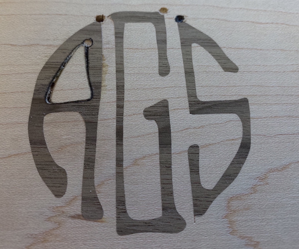

Any scroll saw experts out there?
This is a failed experiment using a tool I rarely use, the scroll saw. I tried to inlay my initials (ASG) using the double bevel method, which I had read about, but something(s) went wrong.
1. After putting the pattern on a piece of walnut roughly 1/8 thick, I taped it on top of a piece of roughly 1/8 maple.
2. I tilted the table 5 degrees (left edge of the table higher) and rotated the work clockwise. I expected this would result in the walnut being the background with the initials in maple. But the reverse happened. The maple letters were far too narrow to stay in place in the walnut background.
3. Trying to salvage the experiment, I tried putting the walnut letters into the maple background. They were very tight and stood proud, but at least could be sanded flush.
4. But the interior of the "A" was far too small. In retrospect, I think I should have reversed the table angle when cutting out the interior of the "A". Is that right?
5. Obviously I need to use a smaller drill to make starter holes and to put them in a less conspicuous place.
6. Boy, I have a hard time follow lines on a scroll saw. The blade seems to wander even though I tensioned it up as much as I could (was using a no. 5 ultra reverse flying dutchman blade). This was on a Mark 5 mounted scoll saw (teal) with the speed set to F.
Feel free to tell me everything I've done wrong here!
Al

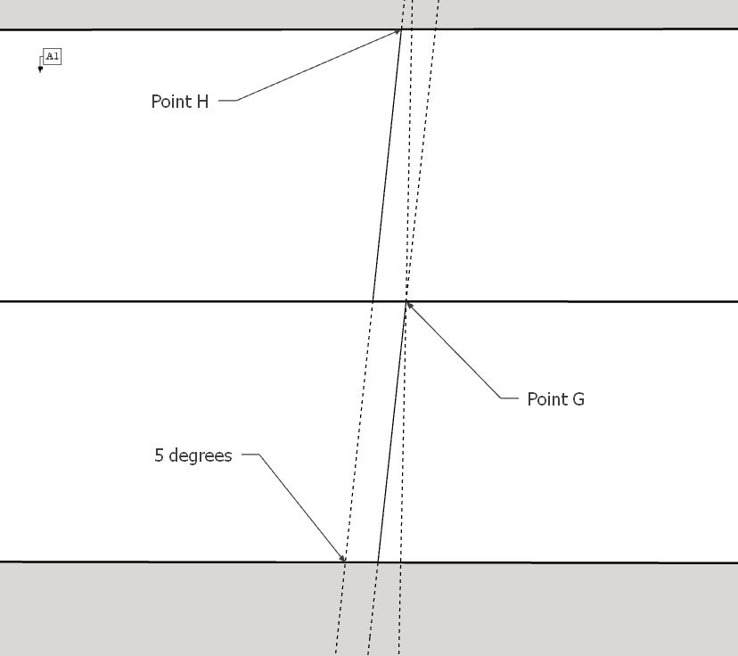

I decided to try my luck at making a drawing to illustrate how this might work or not work.
So in this first image I have the "blade" set at 5 degrees, the blade width is 1/64" and the both pieces of stock are 1/4".
ScreenHunter 124.jpg (37.65 KiB) Viewed 31530 times
The background is on the top and the insert is on the bottom. The background cut line is a line as is the insert cut line that we are concerned about. The vertical guide line shows the location of the cut on the insert and as you follow it up you can see that it is not going to fit.

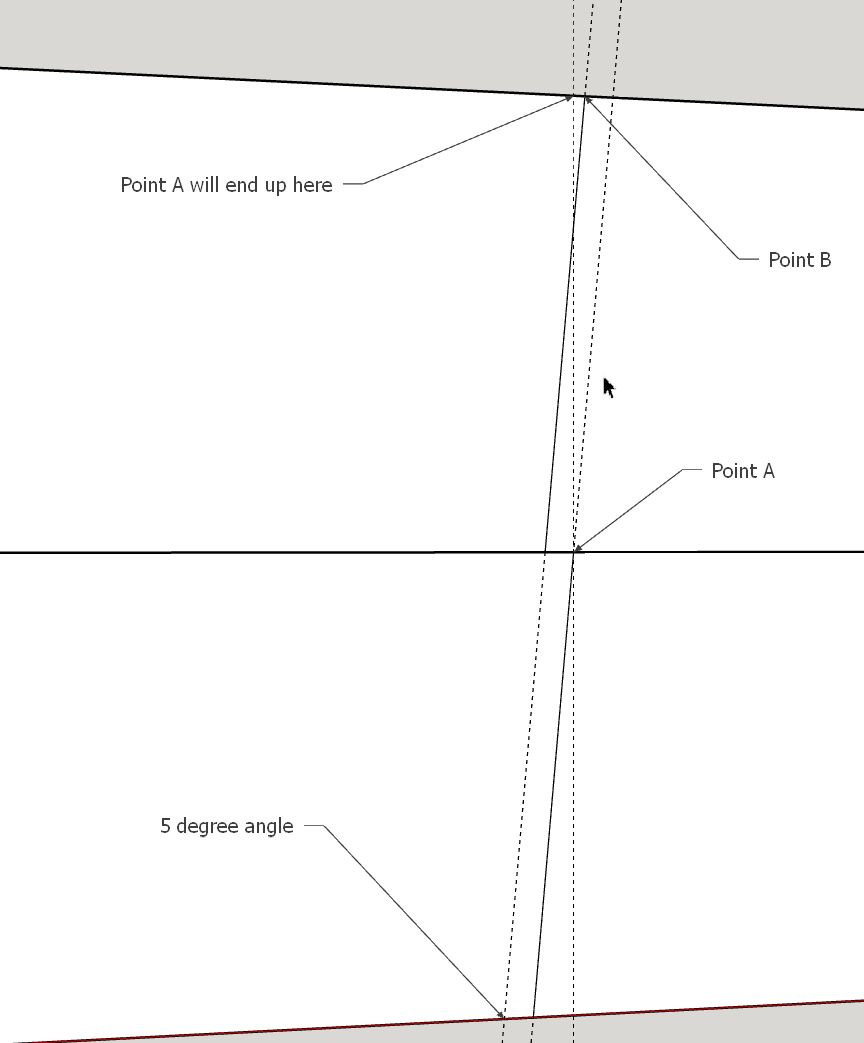

Next we have one at 4 degrees.
ScreenHunter 126.jpg (34.59 KiB) Viewed 31530 times

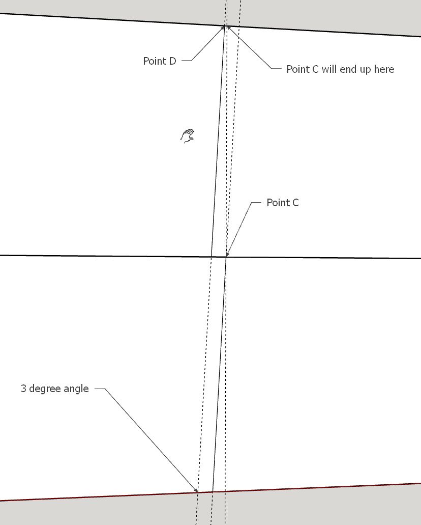

It is closer but it will need some sanding to fit, not a bad thing but we still have to account for the glue. So lets see what happens if we go to 3 degrees.
ScreenHunter 127.jpg (35.32 KiB) Viewed 31530 times
I'm not recommending anything other then the thickness of the material combined with the blade kerf give variability to angles.
Re: Scroll Saw Inlay Question About Double Bevel Technique
Forgot to post the drawing with 1/8" parts, same 5 degree angle and same 1/64" blade thickness. Notice how different that is then the 1/4" parts.
ScreenHunter 128.jpg (23.91 KiB) Viewed 31524 times

Thanks for the sketches, Ed. I think I need to rethink this process and watch a few videos and experiment some more.

Better. Still not following the lines very well. Probably reduced the angle a bit too much. Hole placement suboptimal. But at least the interior of the A fits better and I've got the background/foreground issues sorted out.
