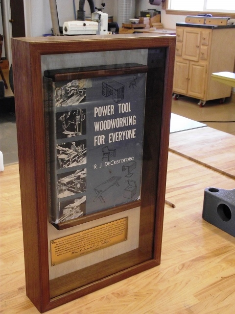

When you say "Shadow Box" is this what you are talking about?rjo946 wrote:I'm using the saw. Trying to make the frame that is in the woodworking system book. Using compound angle cuts. Wood is cut but not put together.

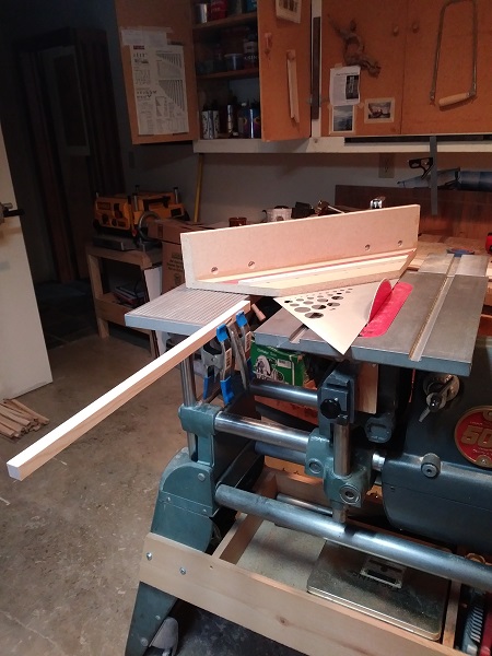

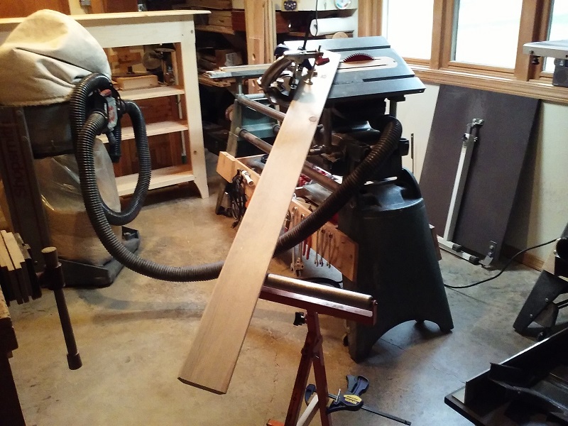

After my last post I remembered that I had taken some pictures of both described processes and thinking that each picture is worth at least 10k more words, here they are.
One other second thought: any molding wider than 4 inches will have to be cut on the flat, so the miter box won't work, as the capacity of the saw is exceeded. So, either tilt the table and angle the miter gage, or use a compound miter saw or build a miter box with really tall sides. The compound miter saw would be handy, but no room for it, which is why Shopsmith in the first place.
