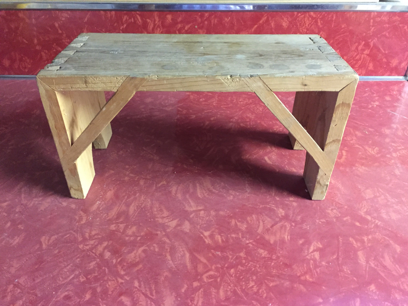

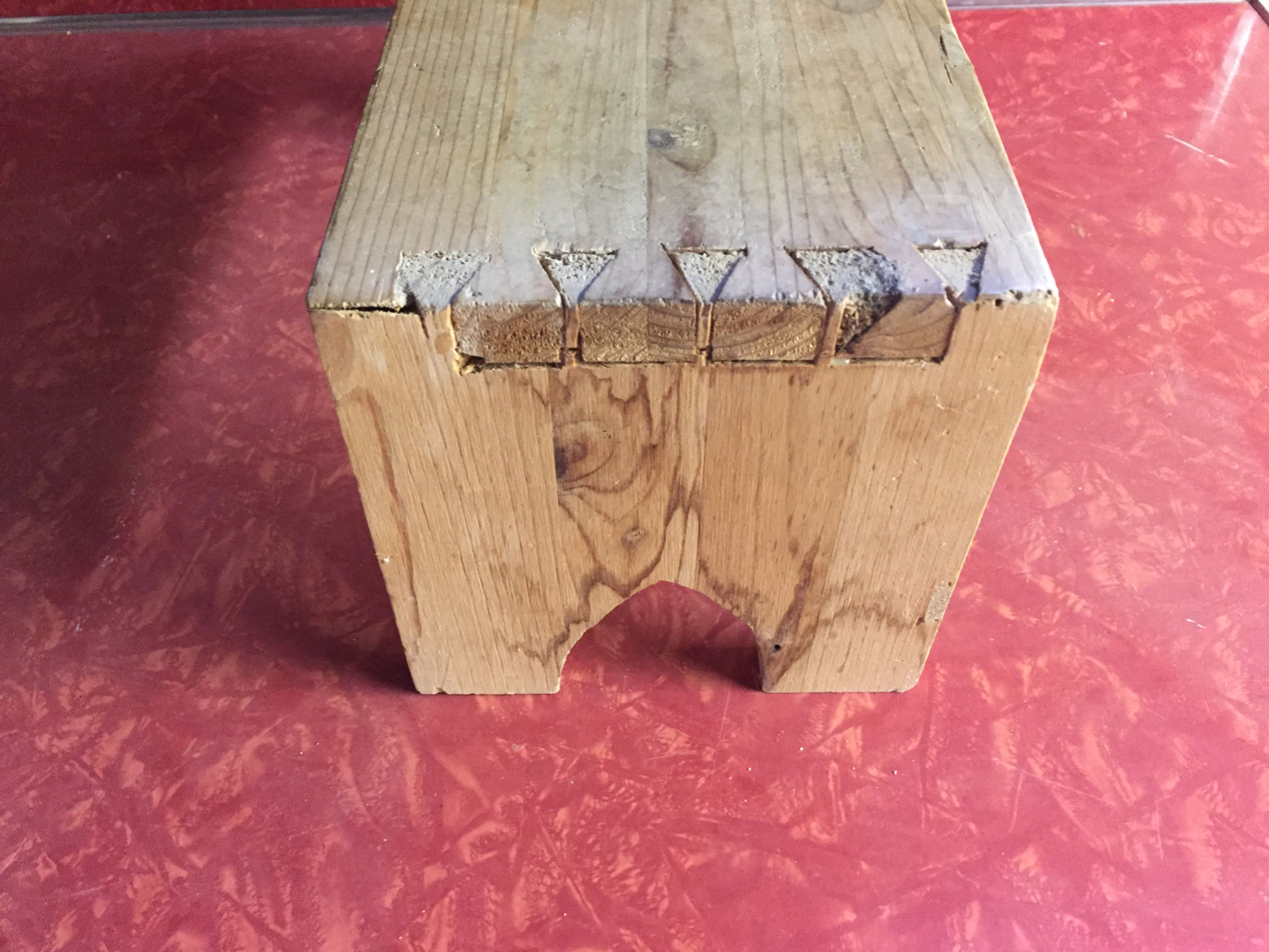

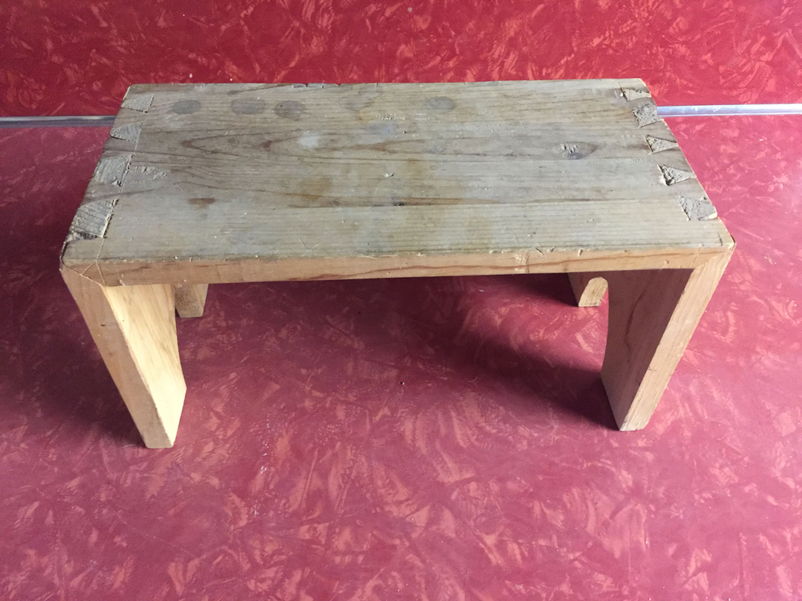

Once upon a time, back in my handwork days, I built this step stool. It was meant to be an exercise in making mitered dovetails.
I hand planed the pine boards down to 5/8" then did my best to make the joints using handsaw, mallet, and chisel.
It looks pretty beat up today after 20 years of use. But, I assure you, the workmanship didn't look any better when it was brand new. These were my first and last mitered dovetails.
I didn't think dovetails would be enough to make this piece strong, so I let in small diagonals into the rear.
Tiny 1/4" by 1/2" slats of wood are enough to transform something that should be rickety into something rock-solid. I can jump on this thing from any angle without a hint of flex, yet it's light enough that I typically hook it with my foot to move it where I need it.
I've made far better pieces, but this remains one of my favorites. Every time I use it to make myself temporarily 6" taller, I smile inside.
So, what's my point? I'm posting in the beginner's section for a reason. Seeing really fine work can inspire. And there's a lot of fine work posted on these boards. But, it can also be intimidating. Don't let fine work stop you from making sawdust. Make something, even something bad. It just might become a favorite.

Those dovetails are going to prove a lot stronger than you think. But the joint will be subject to a lot of torque. I would have added the diagonals on front and rear. Hand tools were never my strong point.

The joints HAVE been subject to a lot of torque for 20 years. That includes jumping onto the stool laterally such that I'm intentionally trying to make the stool fold in on itself. It won't move.
Working in its favor is that it isn't terribly tall. And the dovetails are laid out the proper way (with tails on top) to resist the torque. I honestly have no recollection if I foresaw that when I laid them out, or if I just got lucky.
