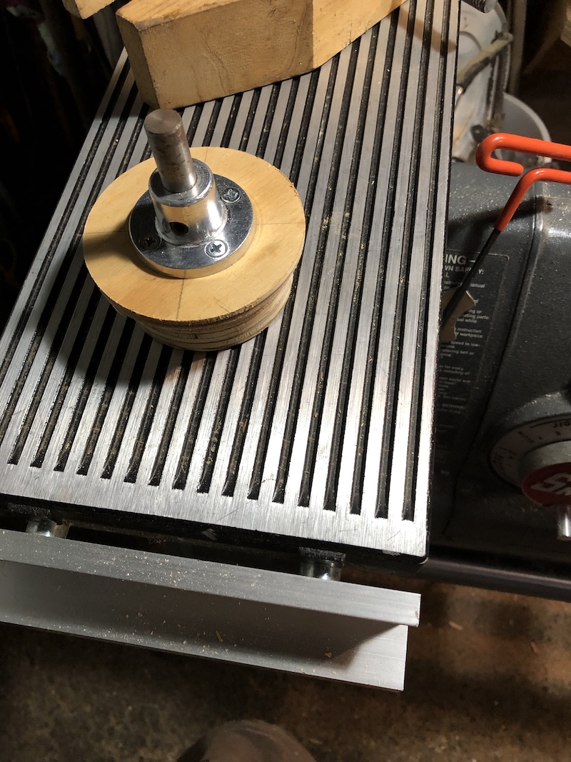

So I gather I want to fill the drum with weight? I can load it up the PVC pipe with MDF circles, but I think I'd need a shaft to go all the way through? I just was hoping not to spend anything. Can I glue a dowel through the middle of all them instead of a threaded/metal shaft since they're there just for mass? I'm planning to drive the drum with the pic attached and the tailstock side will have a slight friction slip fit over a live tailstock bearing.

I think it would be easier to keep the two ends straight and concentric with a shaft that went all the way through.
I don't think weight is a concern, I was only suggesting a few extra rings, spaced apart, to keep the center, length wise, concentric with the shaft through the center. If you are building it like a sand flee or V-drum sander there isn't any pressure against the drum, Not sure about a thickness sander, I have no experience with one of those.
