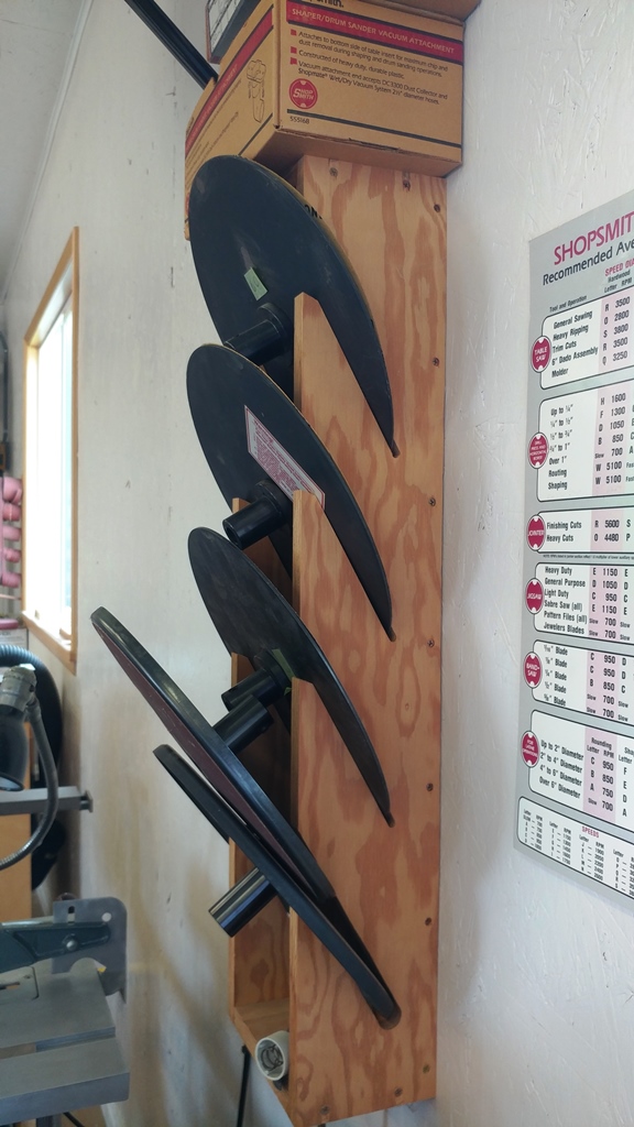

Re: Conical Disc Sander
I totally agree Ed. I have had no desire to buy the Velcro system. I have 4 flat disks and 2 conical. One of the conicals has the paper for sharpening planer and jointer blades with the SS jig.reible wrote:I have a more then a few issues with the reuse of sanding disks. My at the time quite new 520 table sports one reason, yes it came loose and scratched up the side before I had time to turn it off.....
I have not had decent luck reusing any of the stick on papers be it shopsmith or not. It is not getting it off that is the issue, it is getting it to re-stick well enough.
I have a collection of the flat disks with different grits and types of papers that I use and like wise I have 2 conical disks, one for each grit that I use. When the paper is worn out it comes off and NEW paper is added.
I too have the Velcro system for the flat disks and it has it uses but you get a softer edge, good when you want it but no so other times. You can also damage them if you feed to hard and of course they are not for sharpening. I wouldn't even think about Velcro for the conical, I don't see that working well at all due to how it is used and I'm not sure if you were to get that set up what you would do for paper??
My solution to all of this was to spend the money and get plenty of disks and besides it much faster to change disks then it is to change paper.
The disk holder was made when I only had 3 flat disks and one conical. Not a problem with the 4 flat disks since one stays on my shorty almost all of the time. I put a piece of painters tape on the back of the disks with the grit on it.
