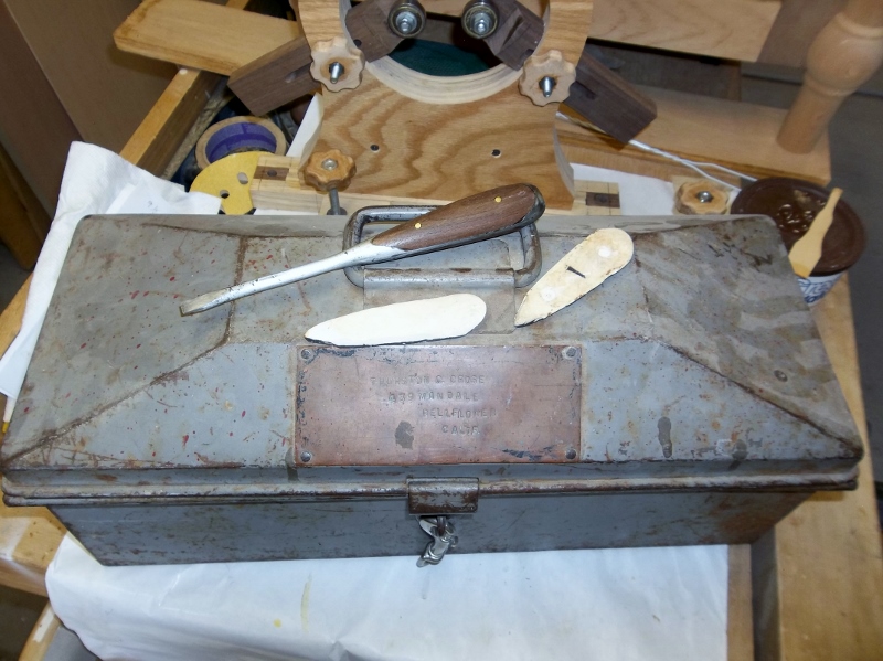

Pictured is a tool box my father carried to work in the long Beach ship yards after WW2. The screwdriver was one he used and at some point in it's life the wood handle inserts went missing. I remember as a kid using the screwdriver without the wood inserts. I have always wanted to fix the screwdriver. It' more than 60 years later and I finely have gotten around to it.
I mixed glue and corn starch to a molding clay consistently and made a mold of the inserts. After drying overnight I used the mold as the pattern for the wood handle inserts. I made rivets out of a piece of brazing rod. After fastening the inserts I did the final shaping on the belt sander.

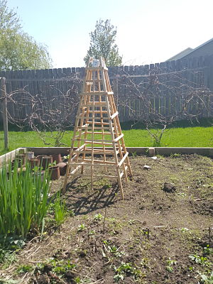

I have been busy with some yard work and gardening. I ripped down some cedar fence pickets and a cedar deck board to through together a couple of trellis' for the garden. Although the weeds seem to be taking over before I can even get things planted or what I plant can get going.

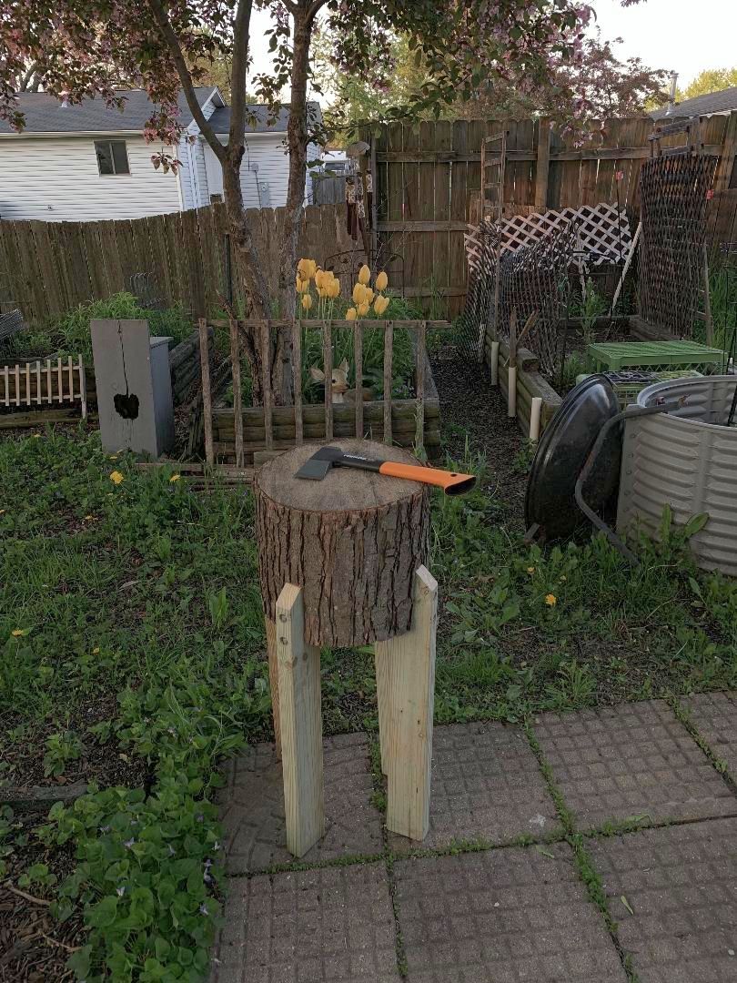

One of many project this week, a chopping block. And no we don't have chickens.......
Chunk of ash I saved for no particular reason. The wife thought it would be handy for cutting up some of the branches for the fire pit or to size for pick-up. Have to see how that goes.
