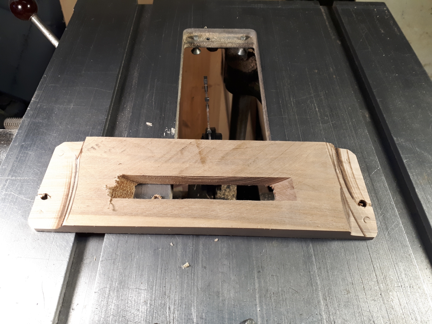

In addition to MKCtools, Hog Winslow also specializes in 10ER parts. (note he has more parts than are shown on the web page)
https://sites.google.com/site/hogwinslowwoodworking/
and of course there is Ebay for parts too.
Some Mark V-500 table inserts can be modified to work on the 10ER. http://www.mkctools.com/mkvinsert10er.htm
It is also not hard to make your own table inserts from wood, plastic, or aluminum.
This is a quick and dirty insert I made when I needed one for use with a wobble dado blade. I reduced the thickness at the ends with the disk sander :) (told you it was quick and dirty)

I made a handful of extra inserts for my Mark 5. All you need is any piece of wood 1/4" thick. The 10ER is likely similar. Measure the thickness you need and make a few.
I had a box of cedar closet liner (juniper). They were the exact thickness I needed so I simply cut out a few of them. That way I have some for regular saw blades, my dado blade, and router bits.
