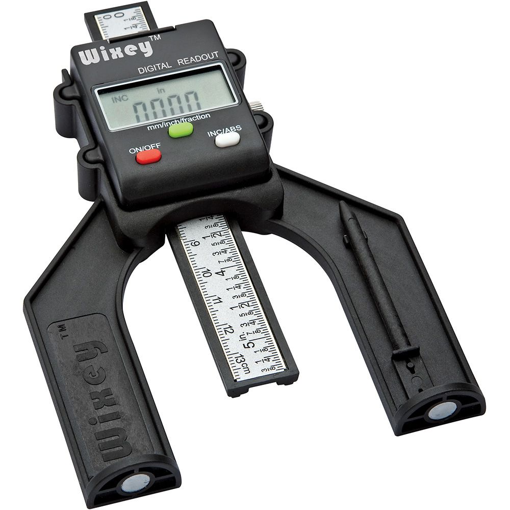

Just a comment on the setting blade height to 5/8" but only get a 1/2" deep rabbet...I assume you are using the combination square you showed and attempting to hold it above the sawblade to measure to the table. Could it be possible that there is a bit of parallax going on, i.e. you think you are holding the square perfect, but in reality it could be leaning a bit throwing off the measurement of the blade height? I have used a similar combo square for years, but would start there in looking for sources for error in your depth of cut (based on my past experiences with it). Also, as some suggested you can be more precise and either make a known height setup gauge, or buy them (Woodpeckers had a set of these a few months back but it was expensive). Another optionyYou might consider is a height adjustment gauge (below is a pic of a Wixey digital one) as well. Just a thought...
https://www.rockler.com/wixey-mini-digital-height-gauge

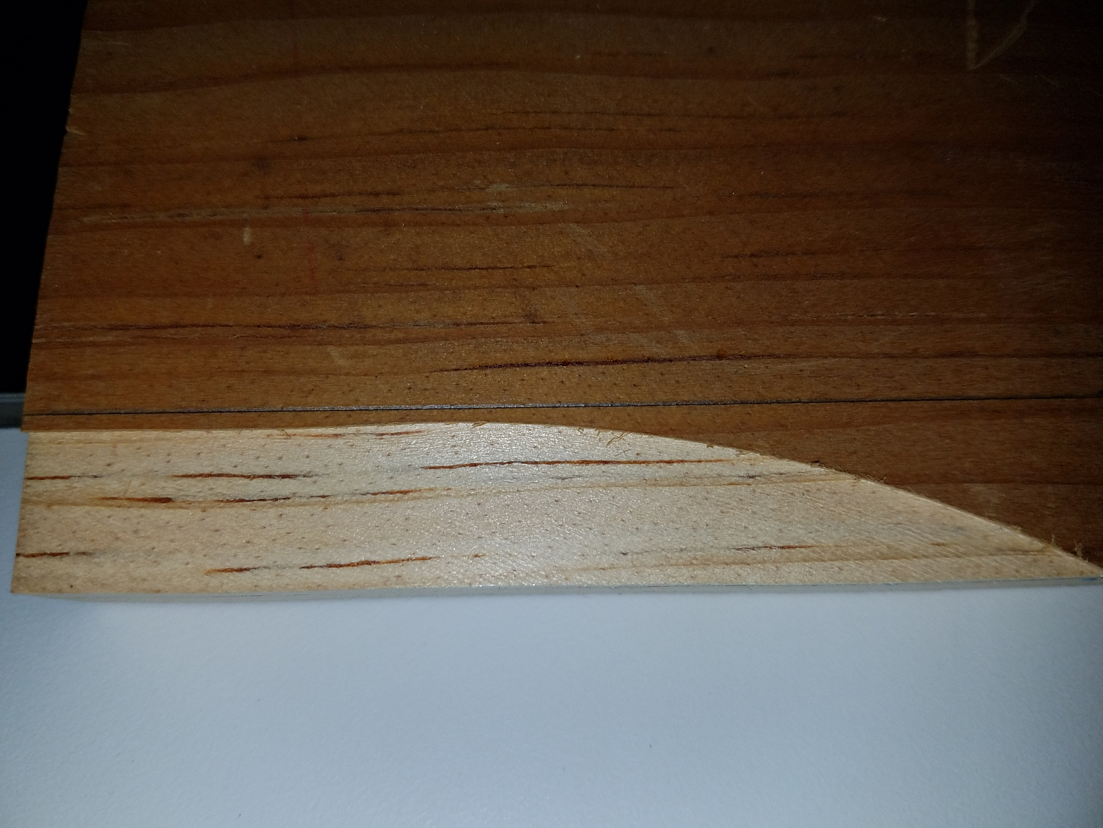

Re: 510 Table Saw - looking for tips setting depth & fence width
Table height and depth of cut - are these not one in the same when using a Shopsmith?
Fancy gauges and the like are neat but definitely not a necessity. Scribe a line on a piece of scrap wood at the desired height and use that for your depth of cut gauge. Your cut will be as accurate as was the line you scribed.
Depth of Cut Gauge
Depth of Cut Gauge
Hmmm. The line must have moved 1/16".
