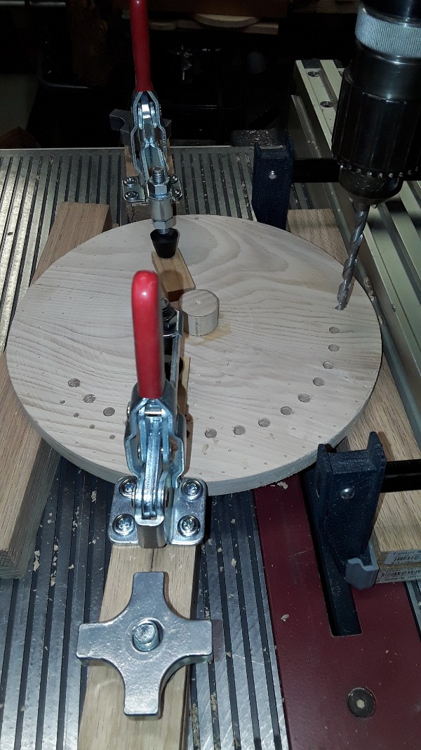

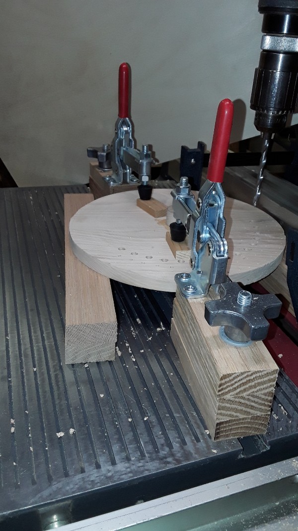

Dont find I use my maxi clamps often, but they solved this set up with ease. The 6 inch faceplate is still attached to the underside, thus the need to elevate. For those that dont recognized them, the silver knob holding down the wood with the clamps is the quick release knob from the maxi clamp system.

I love the Shopsmith T-nuts! I don’t have the Maxi-Clamp system, so I usually use 1/4-20 screws/rod and knobs (from Ace) for stuff like that. Most of my T-nuts have the outboard holes tapped 1/4-20, although those holes are blank on some that I salvaged from a rust-bucket OPR.

BuckeyeDennis wrote:I love the Shopsmith T-nuts! I don’t have the Maxi-Clamp system, so I usually use 1/4-20 screws/rod and knobs (from Ace) for stuff like that. Most of my T-nuts have the outboard holes tapped 1/4-20, although those holes are blank on some that I salvaged from a rust-bucket OPR.
Correct size for a 1/4-20 tap?
Looks like an index wheel being made. How is it going to be mounted?

JPG wrote: Looks like an index wheel being made. How is it going to be mounted?
I've become amazed with rose engines and ornamental turning so I'm making a wooden prototype based around the double bearing quill. Its going well so far. The indexing wheel and a couple more and the headstock portion will be done.
Once its satisfactory, I'll build another more accurate one. This one is close but not close enough but it's an excellent learning exercise.
