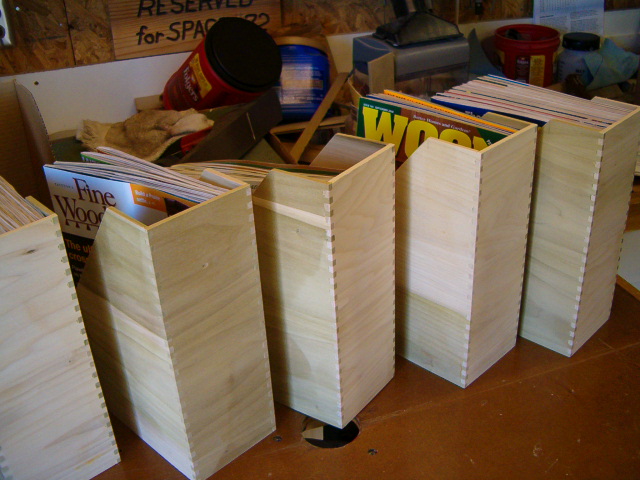

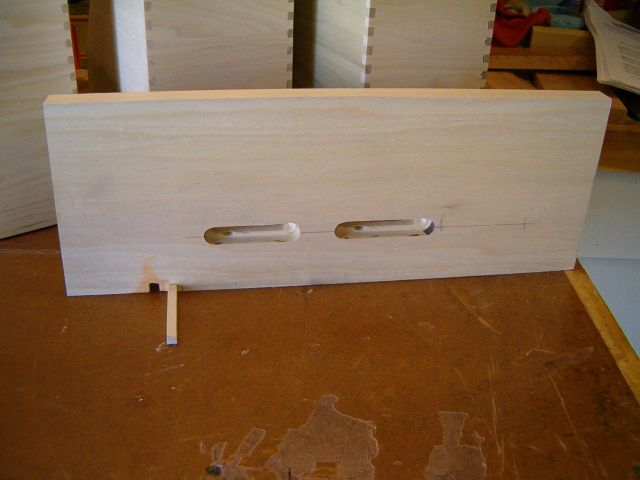

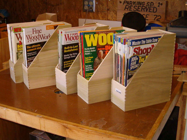

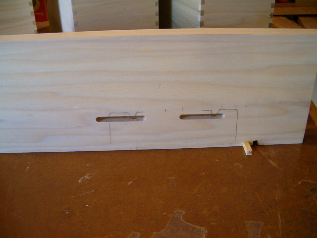

In the Shop, I got the magazine holders made. Interesting - making up the 1/4" pieces of them. required lots of re-sawing and planing. This is the very first time I have made finger joints. As it worked out the process is pretty simple. Since I don't have one of those add-ons (like an Incra set up) I just made the finger joints with my Mark V. A couple photos of my "poor man's" finger joint jig are included. No sense buying stuff if you don't really need it! The boxes are 11 1/2" high, so there are 46 fingers on the long sides. Withe that many fingers< there was no tolerance for errors in the set up as a thousandths of an inch off would be multiplied by 46 (or .046"). That would make it so the joints wouldn't fit. My wobble dado blade did an acceptable job, however the bottoms of the grooves are not perfectly flat. If I was to do this for someone else, I'd buy another dado blade. (This wobble blade does make pretty flat bottomed grooves between 3/8" and 3/4", but at 1/4" the bottom is a bit slanted.)
I penciled the outline of the miter gauge onto the simple jig when the set up was close, then a tap with a screwdriver handle on the sides of the jig was used to adjust it. After adjusting the jig, I had to make new sides and top to the cutout in the jig in order to avoid tear out. Did this by filling the edges with wood filler and re-cutting, You will notice the brown filler stains on the jig.
The plans for this project are available on-line at Wood Magazine down loadable plans. Included are plans for a micro adjustable jig (not the one I used) for making these fingers.

Once again Charlese has done a phenomenal job of demonstrating the capabilities of the Shopsmith when in the hands of a true craftsman.
Cutting finger joints is a relatively simple task when you are building something like a pencil box or a box for receipe cards. But cutting a string of 46 joints on a hand made fixture and having them fit....truely a demonstration of patience and skill. Then he did four more to show that it was not a fluke.
Anyone who doubts this hasn't cut finger joints. They are extremely simple while being extremely difficult. A little slop here and a little slob there and you have another piece for the scrap box.
Congratulations Charlese. Great job.
