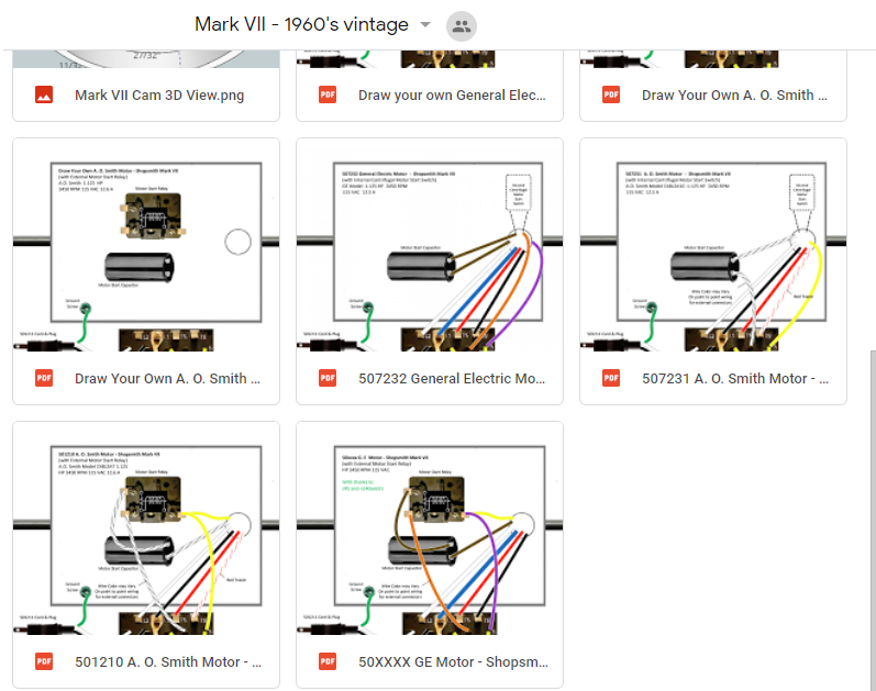

I am need of the scamatic dwag from the motor to the headstock switch.

by everettdavis
If by chance you need the wiring for the Mark VII opposed to the Mark V - I have those posted in the Mark VII folder under the My Google Drive link at http://www.shopsmith.com/ss_forum/viewt ... 90#p185690 as well as a fully restored Mark VII manual.
Everett
Mark VII Wiring on My Google Drive.png (176.7 KiB) Viewed 10527 times

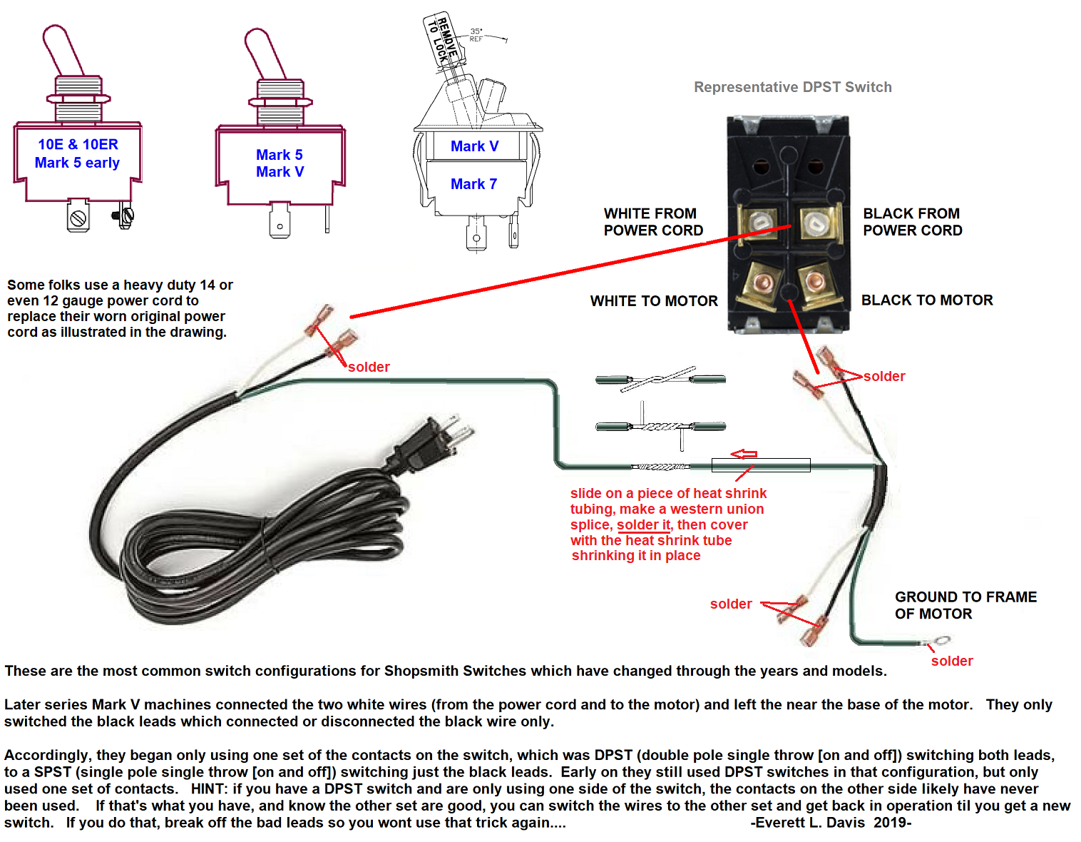

by everettdavis
Some replace their worn power cords with heavy duty 14 to 12 gauge power cords bought locally. 12 to 15 ft length max. including the wire routed inside the headstock. Be sure to use the strain relief in the motor pan which is sized normally for a 14 gauge cord on a Mark V.
Slide back insulation boots from insulated connectors, crimp and solder them for best connectivity possible, sliding the connectors inslulating boots back in place. Use Western Union Splice as shown also soldered and covered with correctly sized and shrunk heat shrink tube.
Everett
Shopsmith Switches.png (732.32 KiB) Viewed 10455 times
