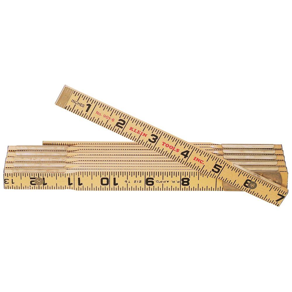

Some excellent responses on this thread and I agree with all of them. Just to expand a little on BuckeyeDennis comments, it has been my impression that there are layout tools (like rulers) that are meant for rough carpentry and those that are meant for finish carpentry or more precision work, so you have to know when to reach for one versus the other. In my mind, a tape measure has always been for rough carpentry work (think house framing) where often being off by a 1/16" or even an 1/8" is "okay". I have a nice metal housing Lufkin tape measure (25') that I have had and used for 2 decades now. I use it often for rough cuts, but when I want a precise cut I would reach for a machinist ruler, if I had one, or use my folding carpenter ruler (pic below). I have had my carpenter ruler for decades and I have received very consistent results from it, though the newer ones seem to have bad reviews online so maybe they aren't built the same now. I know about the inside versus outside measurement difference on a tape measure end tip, but in addition to this as a tape measure wears the rivets that hold the tip on tend to wear and cause this end tip to move more side-to-side further upsetting the measurement. If you have a precision fixed ruler that is always best, but for long measurements, I reach for my carpenter ruler which has served me well. Bottomline, it is great that you are checking your measurements. Sources of error can creep in from many different directions, so we have to be vigilant to ferret them out.
