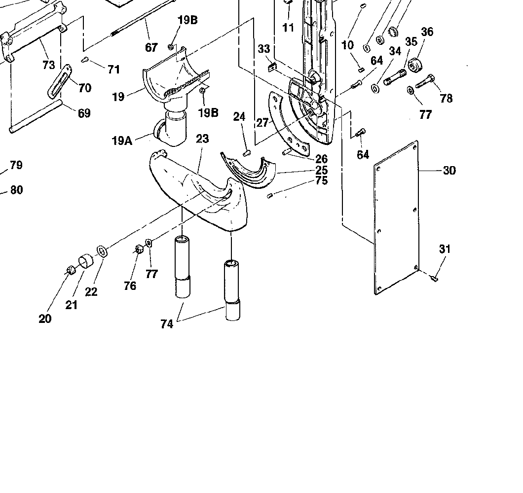

Are we are talking about the same parts 20, 21, 22, 34, 35 & 36 shown below?
Belt Sander - parts.png (49.11 KiB) Viewed 21576 times
If so turning part 36 either locks or unlocks the belt sander to lock in or move from/to vertical or horizontal. It should not take much of a turn to unlock it for adjustment to/from horizontal/vertical. Make sure all the parts are there. The Trunnion Lock (#36) should turn freely on the Trunnion Stud (#35). If it doesn't check and clean up the threads on both parts. You should be able to turn the Trunnion Lock to tighten and loosen it without having to hold the rear Trunnion Nut (#20). A little lubrication on those threads may help too.
The parts are
20 Trunnion Nut
21 Cup
22 Washer
34 Trunnion Washer
35 Trunnion Stud
36 Trunnion Lock

'We' also be talking about 76,77,77,78.

Yes to 20, 21, 22, 34, 35 & 36. 36--trunion lock / "silver disk with four holes in edge" (mine is silver, anyway) seems locked on 35, causing entire shaft/bolt assembly to spin when turned, will see about loosening that up. Yes, also asking about 76-77-77-78 which are missing on my sander. Thought perhaps 36 was not meant to be tightened fully and only 76-77-77-78 was meant as the lock (though that assembly requires tools as well).

Sorry I did not mention the Aux. Lock Bolt, parts 76 to 78. I have never used it and do not even have the bolt. My Belt Sander (from December 1977) was given to me by my father-in-law. The only other Belt Sander (from June 1989) I have had is one I restored and resold and it didn't come with the optional bolt either. Kind of out of sight out of mind. I may pick up the parts and try them out using a wing nut as suggested in the manual. The bolt is, as listed in the manual, a Hex Head Cap Screw, 3/8"-16 x 2".
Thanks, JPG and Ed for pointing that option out. I am sure others will find the information helpful.
