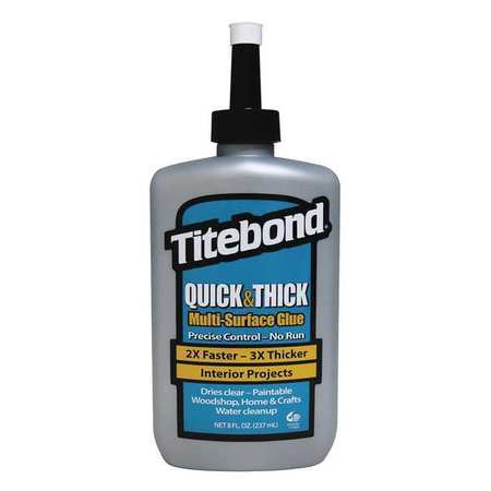

I don't know if you still need suggestions or not, but another option could be Titebond's new "Quick & Thick" wood glue (relatively new product). Most standard wood glues have around 30% solids, but this glue has 60% solids, so less liquid, i.e. water to evaporate for drying and curing. It is supposed to dry alot faster. Depending on what joint strength you need, I have heard you could move it after only 5-15 minutes. An 8oz bottle of this stuff is only $5 at Walmart. It sounded like fast dry/cure time was your main concern, so if you want a true wood glue this could be a good option for you. Alternatively, you could go with a CA (Cyanoacrylate or "crazy" glue) as well. Either of these, I think would be superior to using hot glue. Hope this helps.
