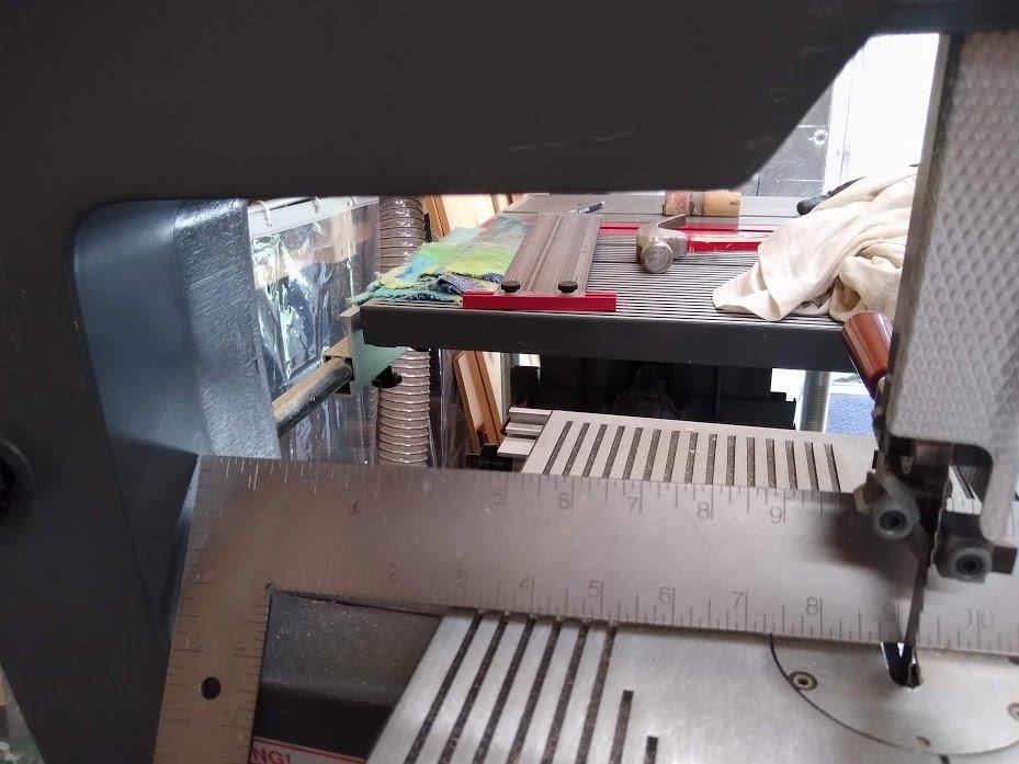

I havent had any real complaints about the SS bandsaw...except this one-which may simply be my lack of creativity in finding a solution or not having anything else to compare to.
The distance between the blade and the plastic body of the bandsaw limits me to roughly an 11" wide cut.
Normal band saw operation doesn't involve a cut this wide (as you're off the table), but sometimes I feel more comfortable on the lower speeds of the bandsaw than trying to do a large board cut on the table saw.
I could do multiple passes and whittle it down-but Im lazy and would rather wish for a larger gap :)
b
