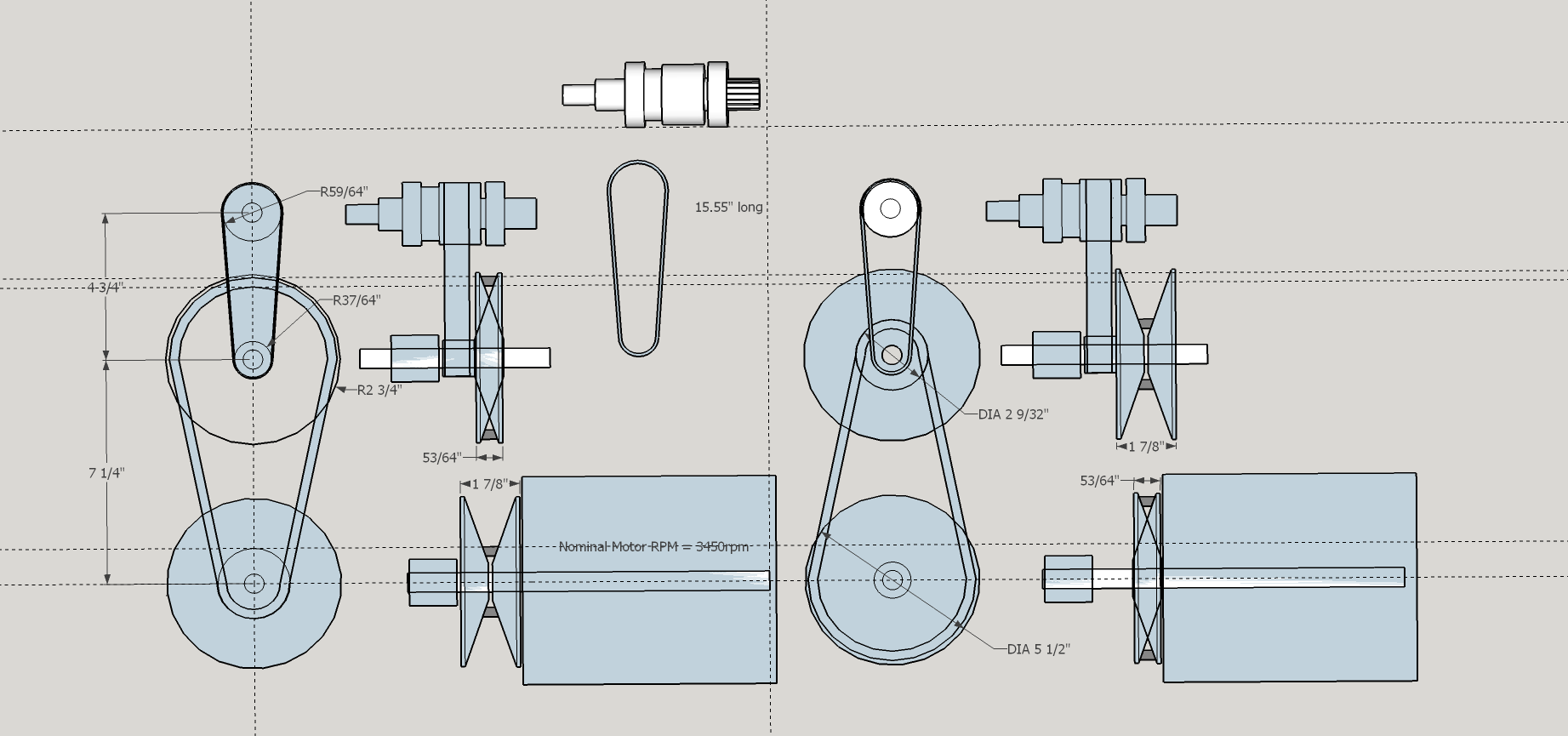

It might be helpful to know where on the sheaves the belt is currently positioned. It seems clear that the sheaves are not changing position when you attempt to alter speed. Understand that the motor does not change speed. The desired speed change is achieved by changing the pulley ratios (the sheaves).
Of particular interest is where the belt rides on the upper (control) sheave. Is it close to the outer edge of the sheave or is it deep in the sheave?
Have you recently lubricated the sheaves?
Hopefully, the attached will clarify what I mean regarding belt position in the sheaves. The depiction on the right is at high speed. For every rotation of the motor the upper sheave will rotate 2.41 times (2.41 times faster than the motor). The depicted motor rotates at 3450rpm.
Note: This is a concept drawing and even though it details dimensions it is NOT intended to represent actual design parameters. The measurements were taken on one of my Mark Vs.

Speed dial adjustments alter the position of a control sheave(the middle pulley in Dusty's diagram) along the idler shaft that causes the idler pulley to open/close(right pix/left pix).
The floating sheave on the motor pulley(the lower pulley) responds by moving thus closing/opening.
My suspicion is that the floating sheave may be stuck and does not allow the pulley to open up and thus reduce the speed of the other pulleys.
