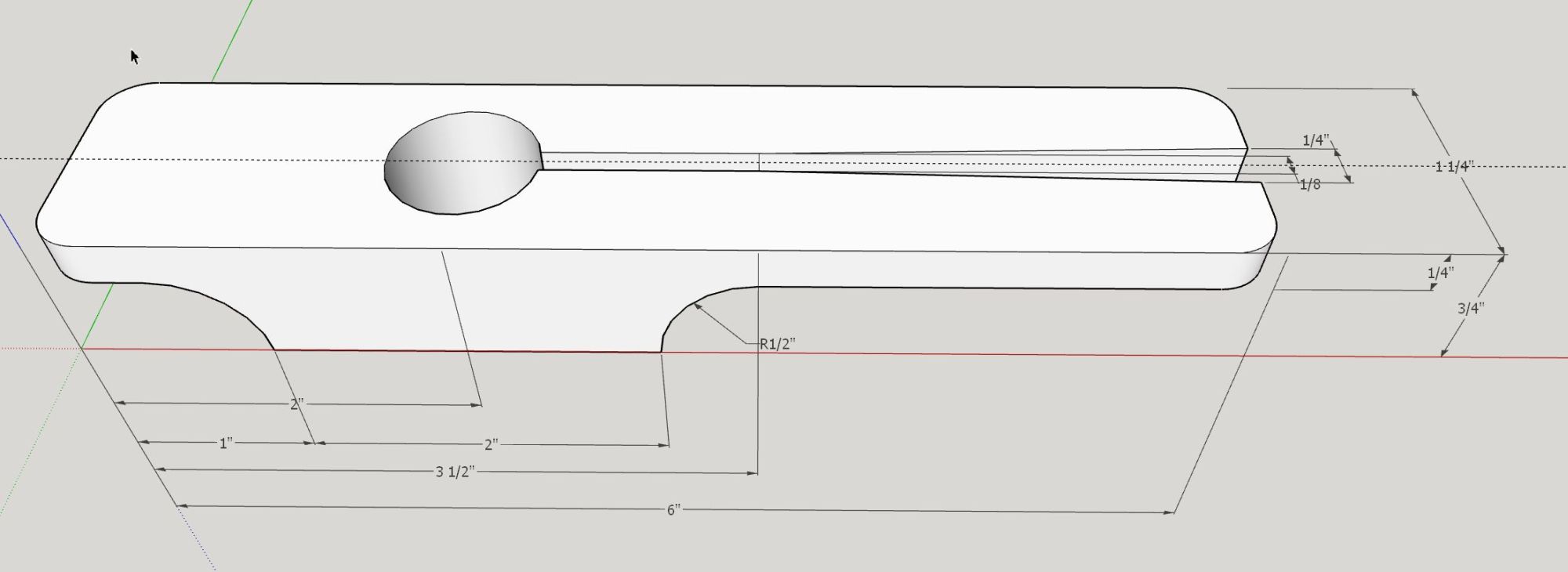

This is not something that I invented, that would have to go to Peter over at the youtube channel "New Brit Workshop".
As you age you seem to loose a bit of your grip on both the mental and physical arenas so sometime it worth getting ahead of the game. In this case some recent developments in the way of dog design has also contributed to making things a bit harder to do.
Today I'll give you a quick view of the issues and then we will get into making a copy of Peter's puller.

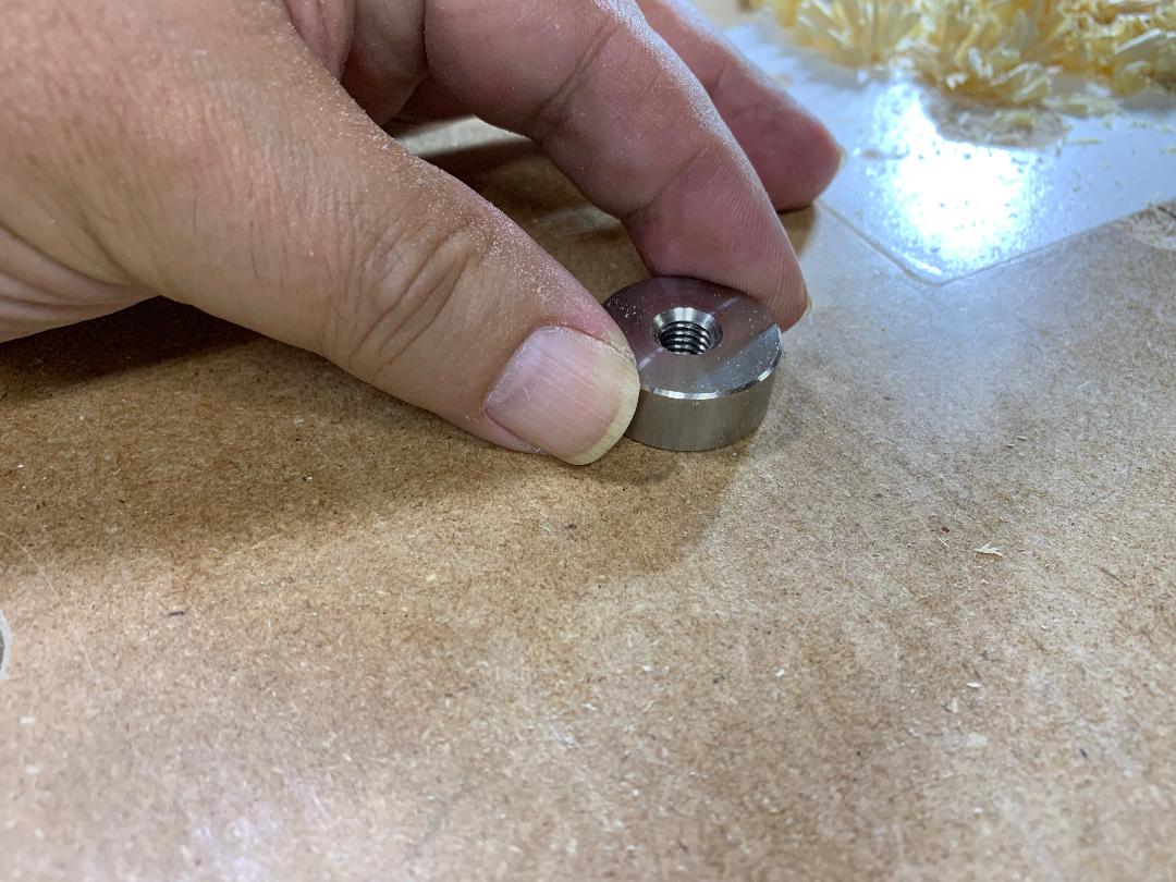

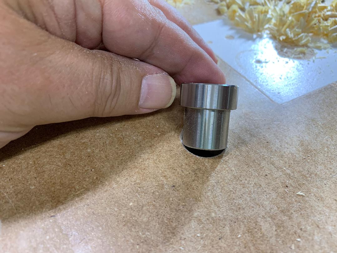

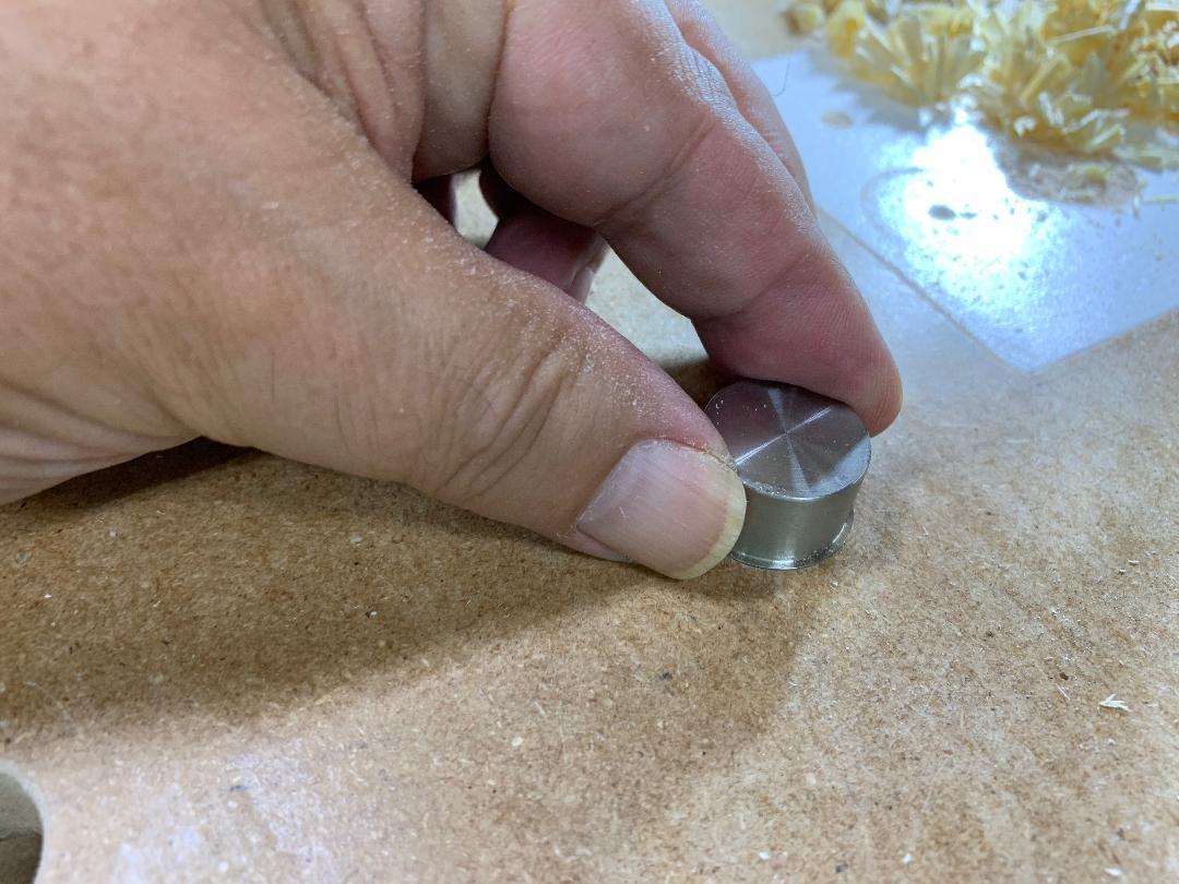

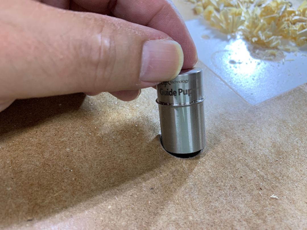

In this picture you see a dog and the 20mm hole that it goes in. There are a lot of different dogs and some are taller and some are shorter. Some have a 25mm collar and some don't. In this case it has the 25mm exposed part to grip. The other option is to reach under the bench and push up, but that isn't a great option depending on where the dog is located.
Gripping can be done and sometimes with a little twist they come right out. These are not a loose fit......... and there is some variance in what companies think the correct size is.
For me these are the most difficult to pull out, just the 20mm shaft and quite short at that.

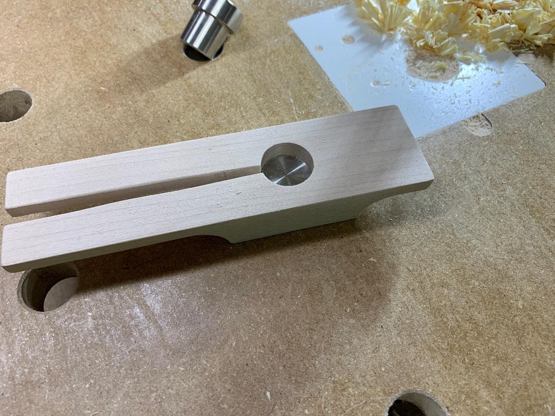

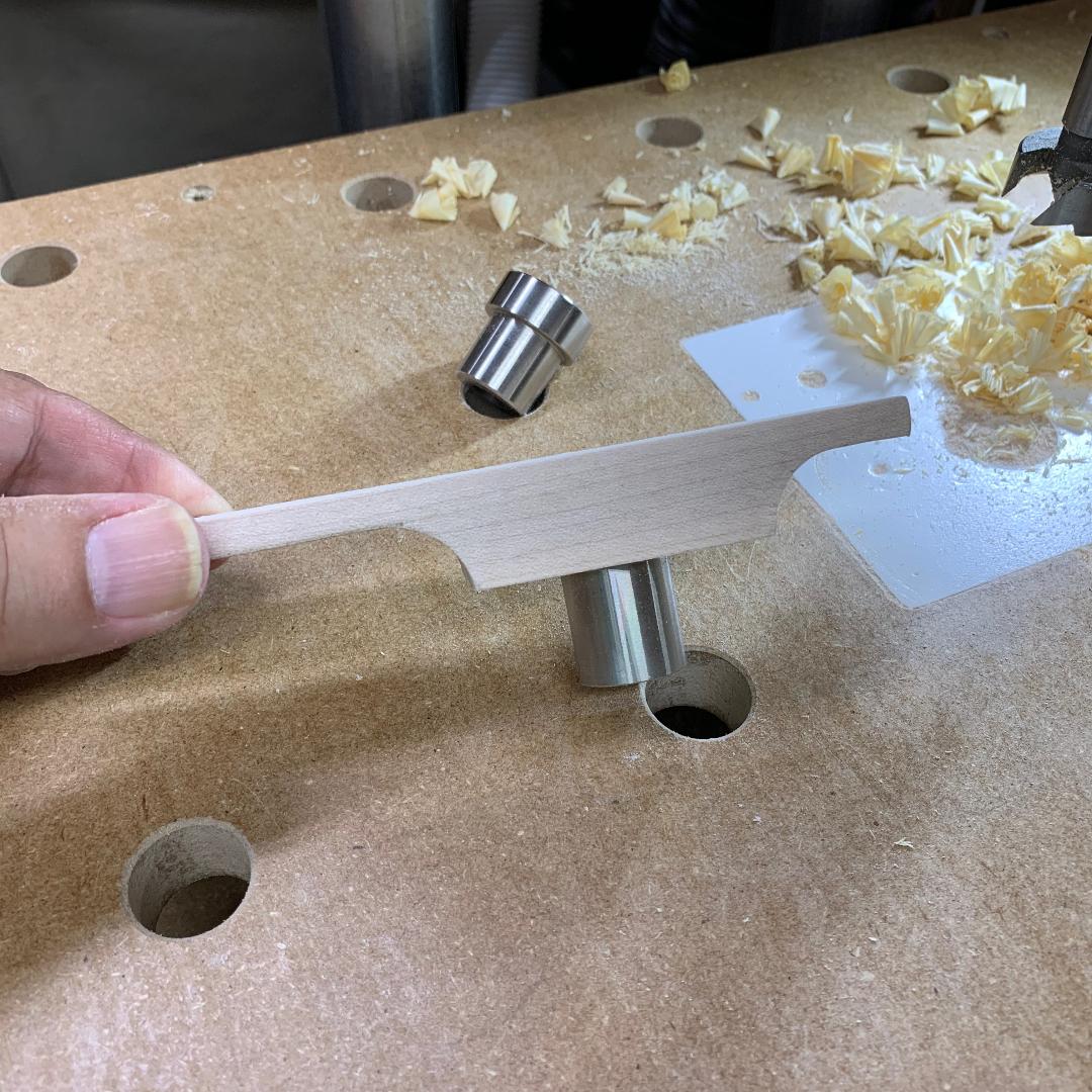

This is my version of the tool that Peter made. In general it is 6" long, 1-1/4" wide and 3/4" thick. The hole is 20mm and the under cut at both ends are like a finger pull. It works by slipping it over the exposed dog like this:
The when you squeeze and lift the dog comes right out.
I know a lot of you don't have these tables or dogs but perhaps you will one day or maybe this will give you another idea for some issue you do have with other equipment.
This is the results post, the build will be posted a bit later.

I went ahead and did a drawing that matches pretty close to what I built and I'll add that at the end of the post in case someone wants it.
I used maple scrap and if you have say some oak or other hardwood that will work fine too. I would not use wood that is easy to split or softwood like pine for this.
I didn't shoot a lot of pictures but will post what I have and you get lost on what is going on feel free to ask what ever questions you need answered.
As you will see I'm actually building two of these. The first is the 20mm puller and at some future point I will do the 25mm version. The only difference is the hole size. If you have say 3/4" dogs you should have no problem just drilling the 3/4" hole and be all set.

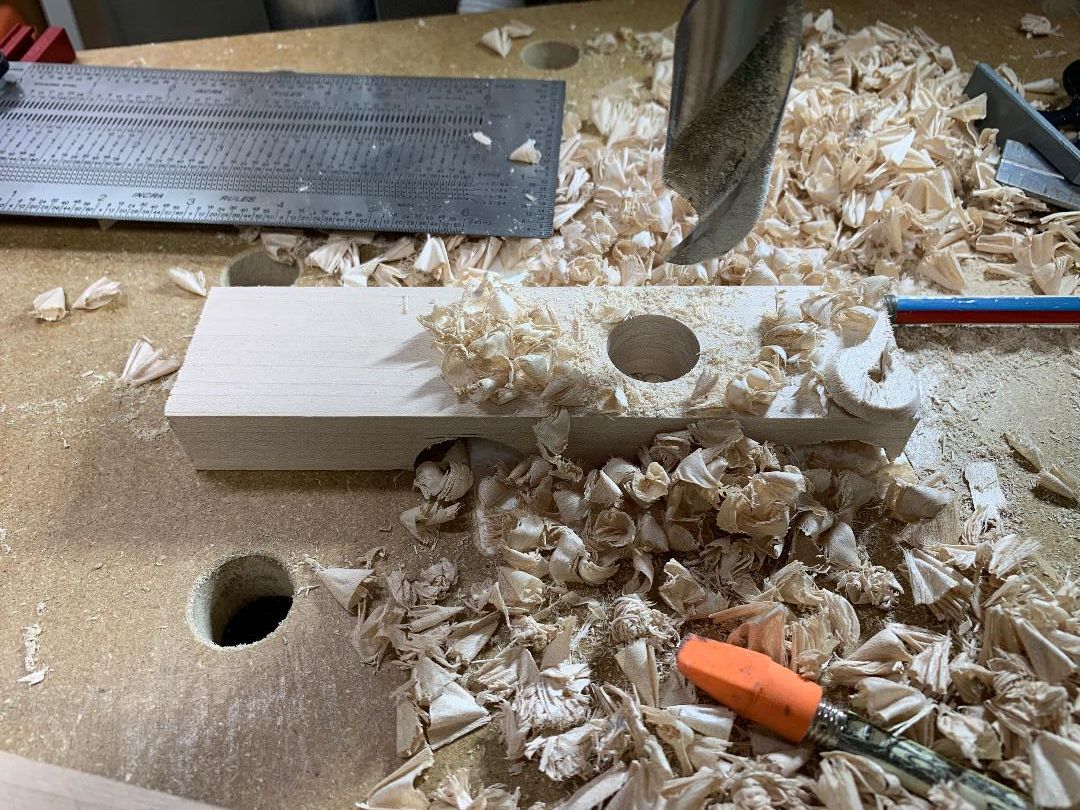

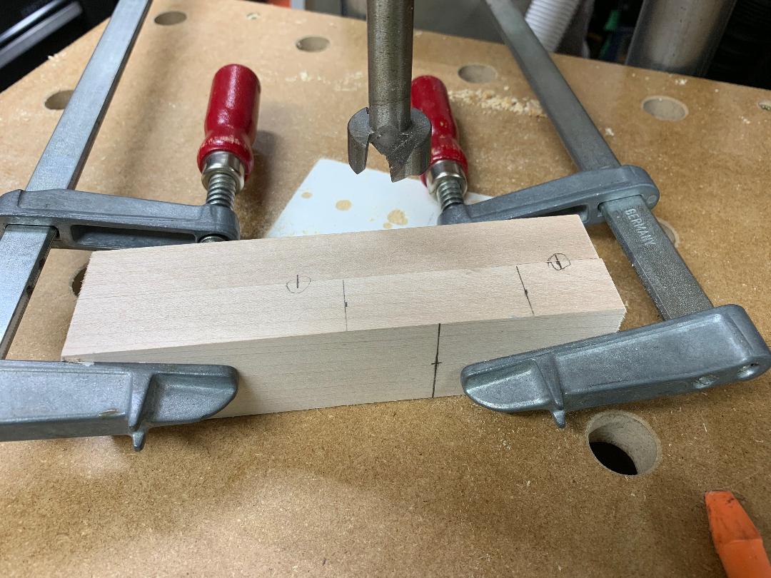

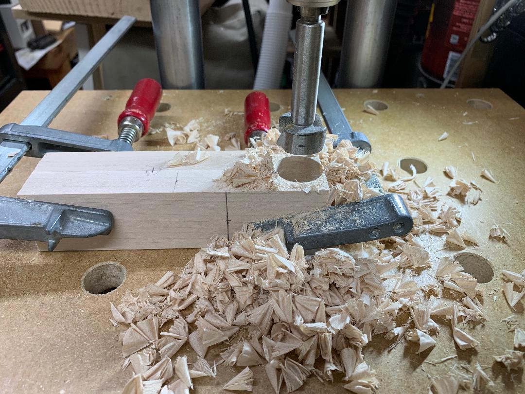

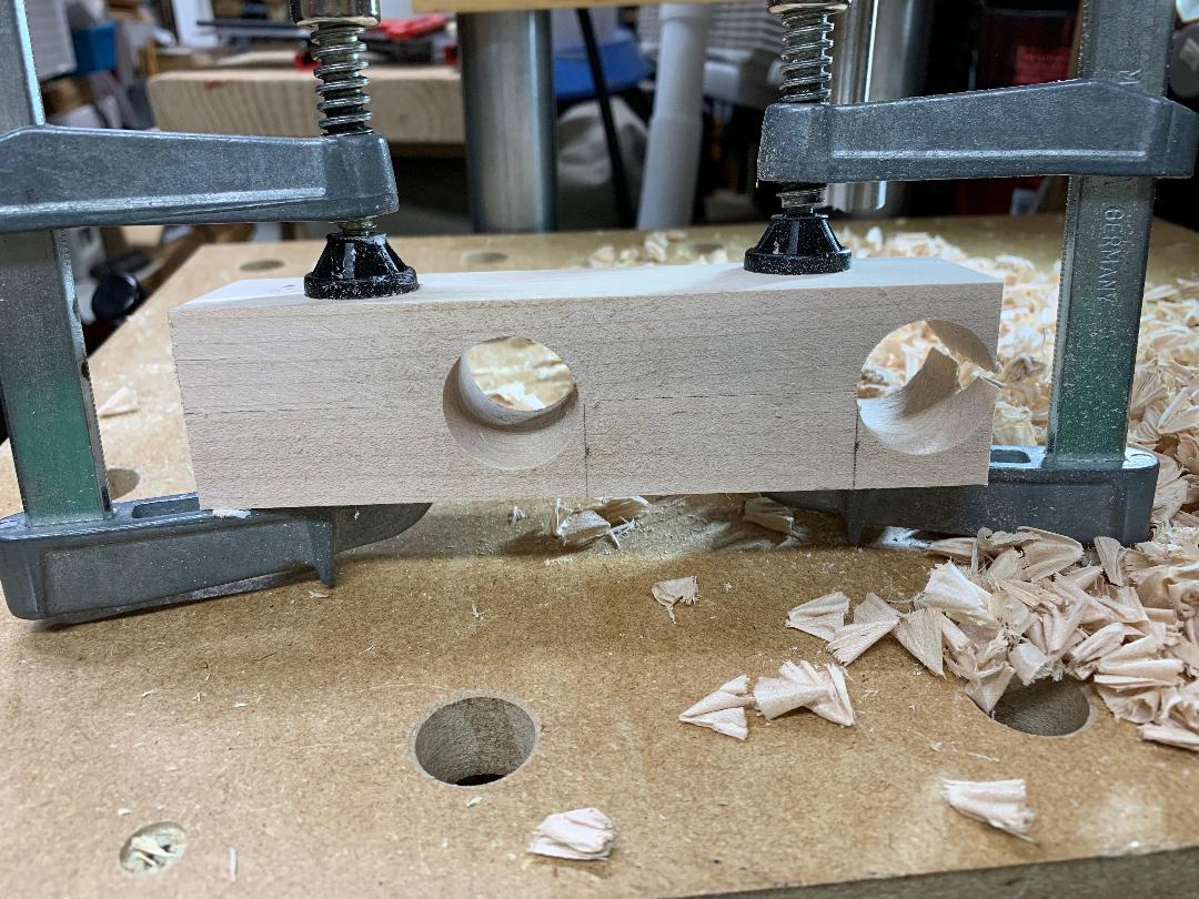

I had the two parts held together with clamps for the drilling of the finger pull area. These pieces were really close to 3/4" and the 1" diameter bit was fine but if your are undersized you might want to use a smaller bit. I marked the point were the drill center needed to be, the seam was the other center line.
With the two pieces clamped together it is like drilling one piece and the hole stays nicely centered.
The hole closest to the one end might have a little breakout but the later operations will get rid of that area as waste.
Drill the second hole and then the 20mm hole, and the results are next.

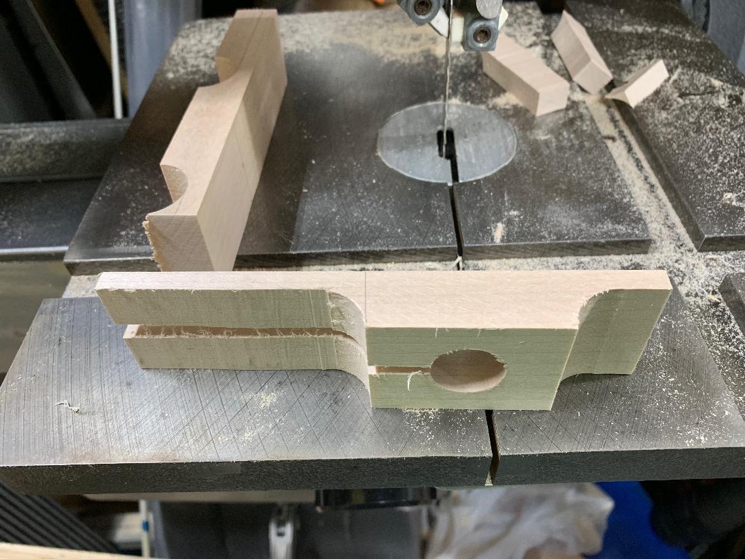

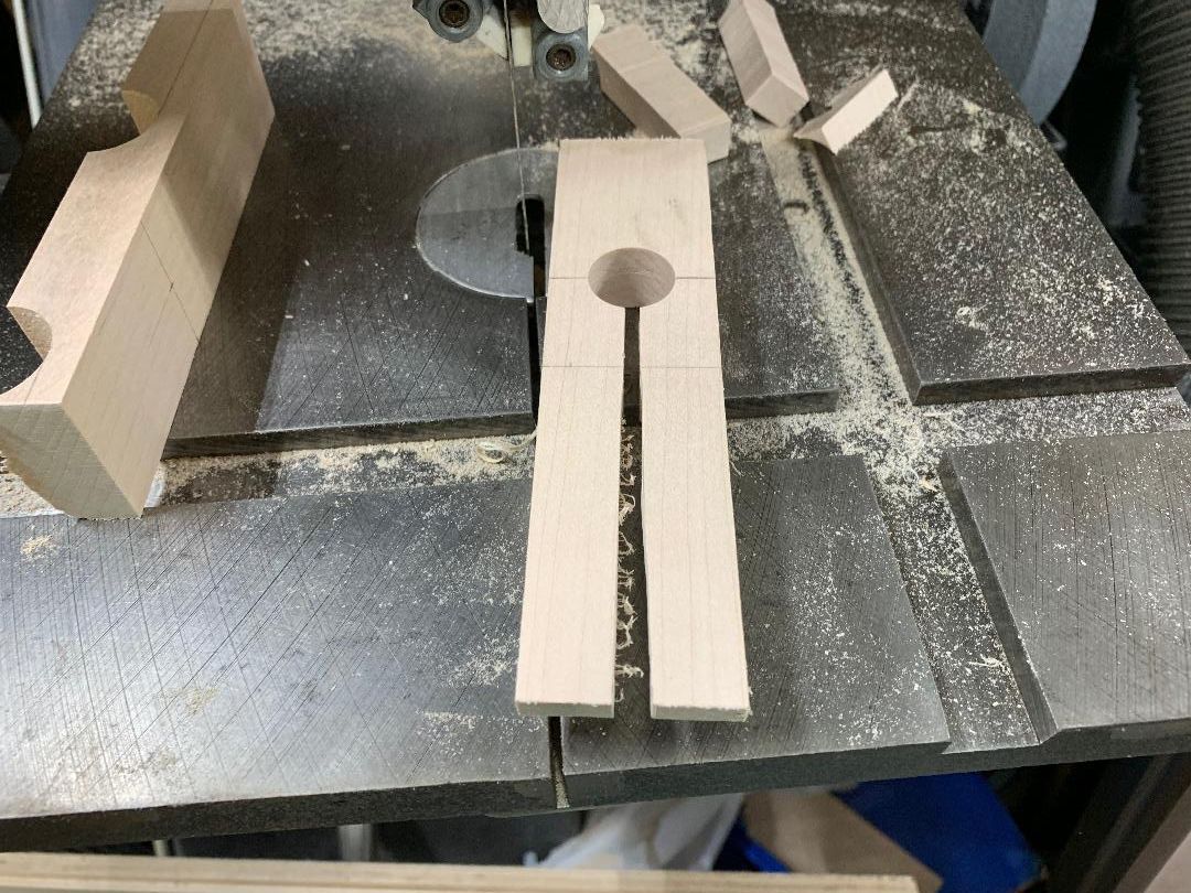

Now you can use what ever saw you have that will allow the waste material to be removed. A bandsaw is a good choice but not the only thing that would work. I don't have the parts clamped at this point but for the vertical cuts I hold the two pieces together to provide more surface area to be in contact with the the table.
So that is about all that I have except for this drawing:

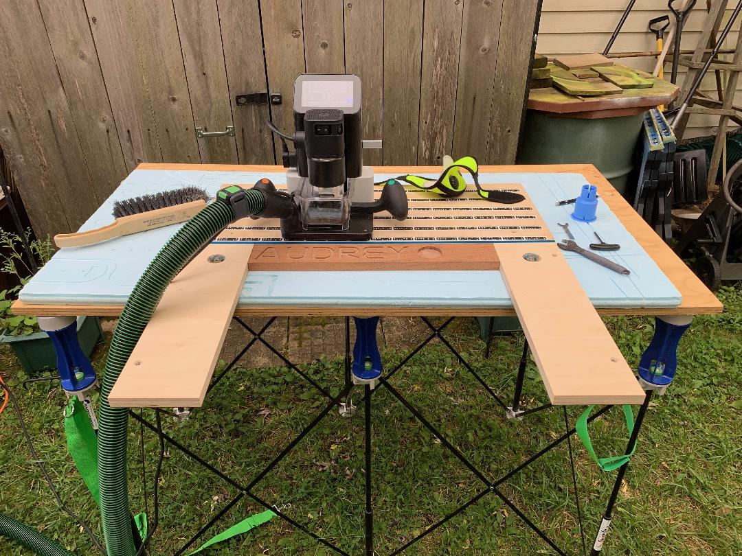

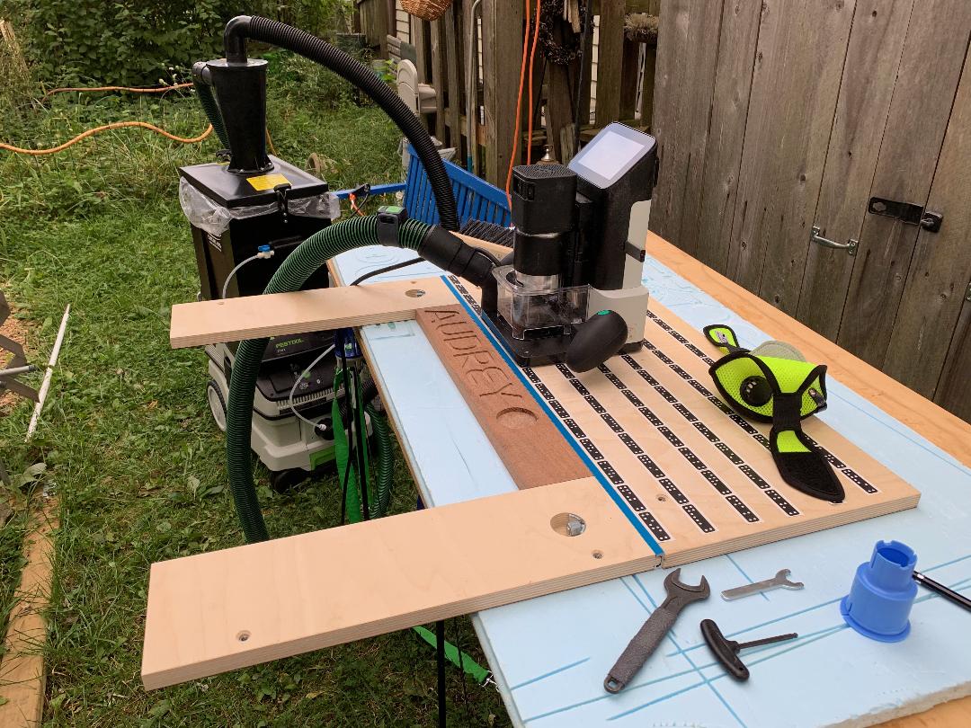

I was out working on a pair of signs today and got a couple of shots of my work set up. I normally work in the driveway but it was tooooo windy to use the umbrella and near 90 degrees and a lot of humidity so the back yard in the shade worked out pretty well.
The setup was the centipede with risers and the grippers then a sheet of plywood followed by some blue foam. This is a pretty standard setup for me for a lot of projects.
I also wheeled the CT26 with oneida dust deputy back there. I updated that with the blue tooth plug in so has that added function when working with things that can't use the built in current sensing plug, things like the Shaper that draws too much current.

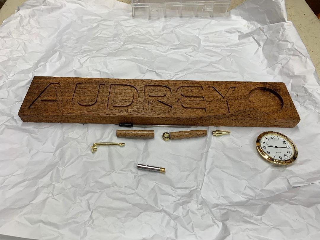

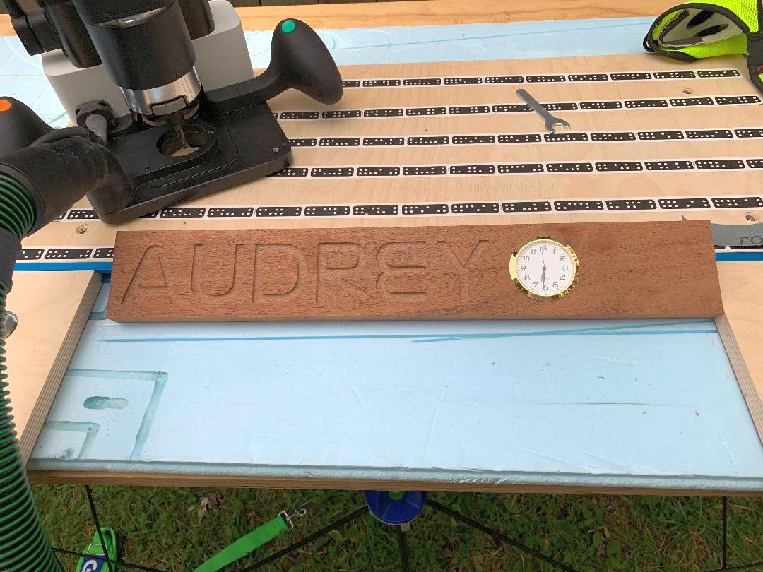

In case you might be wondering about the project, while not finished this is the general idea:
It will get trimmed for length, sanded, finished and be a birthday gift for a grand daughter. The wood is labeled as Black Mesquite, didn't know there was such a thing but there it was. I also have blanks ready to make 4 pens out of the wood, one will be a gift that goes with the sign. The other three will be left in reserve until I need more pens. I just finished getting 10 more with tubes glued in so in a day or three I'll make them up and if I have enough pen parts left I might just do the other 3 Mesquite ones.

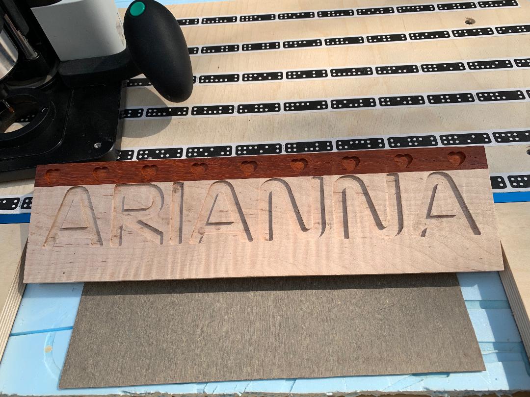

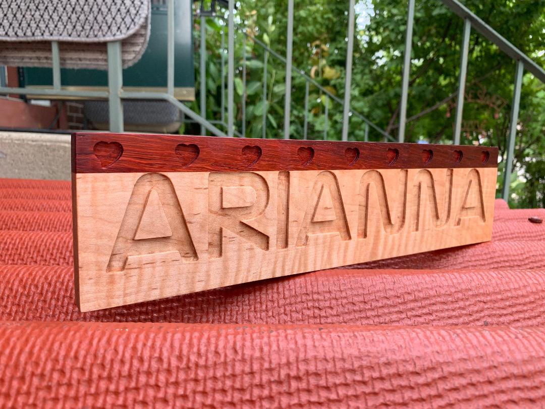

The other sign which you didn't see yesterday as it came off the table having the 9 little hearts added today.
It too has been cut to size and sanded and finished. Anyone want to guess the age of the recipient? Well if you though 9 you get a big gold star. This is it as it sets now:
The wood is of course Padauk and Curly Maple.
