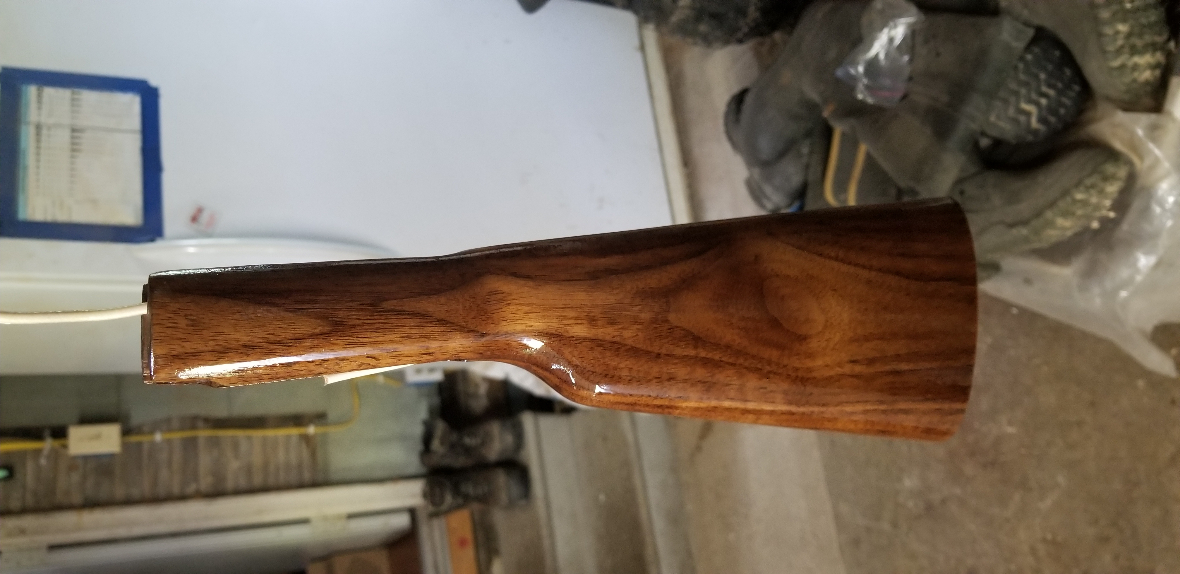

Re: why did they do that
Posted: Wed Sep 11, 2019 9:57 am
by Hobbyman2
Posted: Wed Sep 11, 2019 10:03 am
by Hobbyman2
the last coat on the stock was finished using 2500 grit wet sand paper with one coat of danish oil and three coats tong oil than it was 00 steel wool and 2 coats of paste wax applied lightly with 00 steel wool . the front edge was fit using the SS disc sander , the table tilt allowed for a perfect fit .

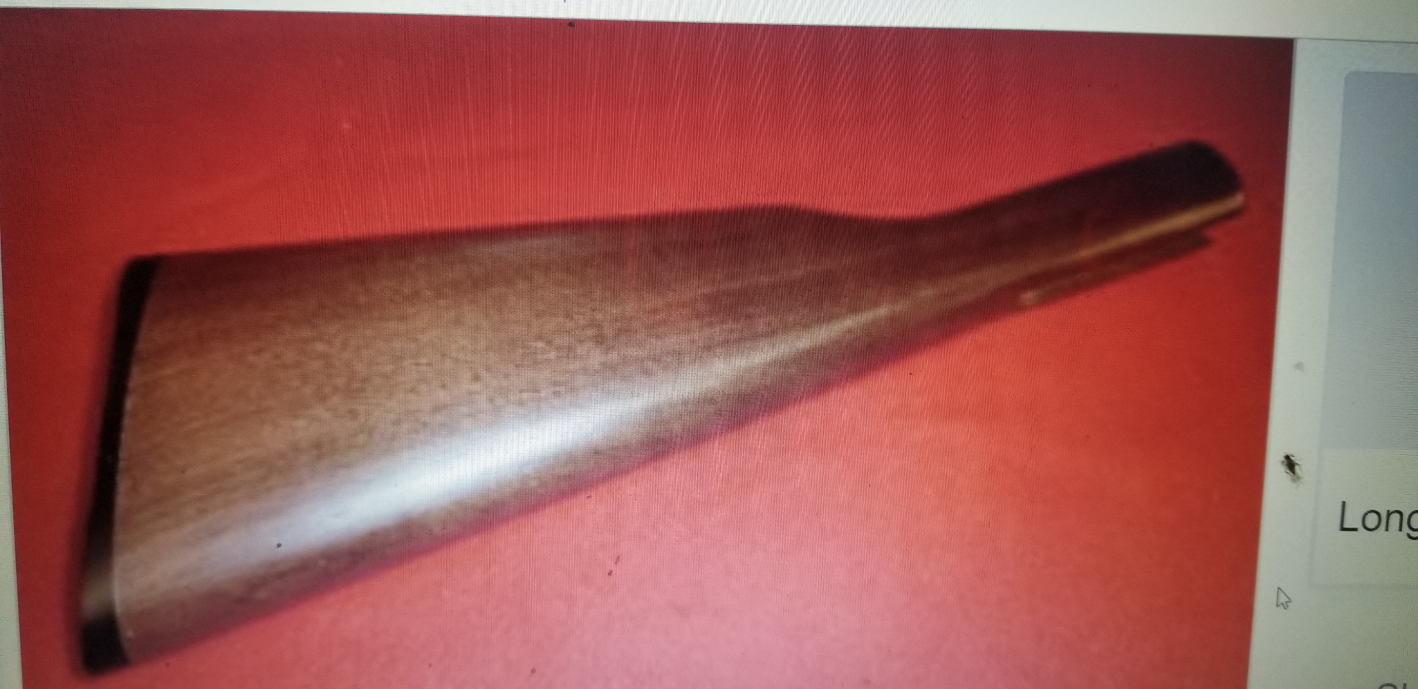

This was the picture in the add as you can see it looks very good, as is , once sanded it took on a completely new look ,

I'm with you HobbyMan -- it's much prettier with the real grain showing. It reminds me of a .22 stock that I refinished as a teenager. Stripping off the old varnish revealed some surprisingly pretty grain on that one also.
As for why they did it, I have a few theories:
1) the manufacturer wanted the stock appearances to be as uniform as possible, and/or
2) they wanted people to think it was made of straight-grained walnut, and/or
3) they want to be able to make stocks from different hardwoods, based on price and availability.
Can you tell what the actual wood type is?
Posted: Fri Sep 13, 2019 1:36 pm
by Hobbyman2
It had the walnut smell when I sanded it so I have to assume it is real walnut . for nostalgic purposes the authentic winchester stocks were made strictly of gum wood , from what I read most folks replaced them with walnut aftermarket stocks that were sold separately so this is still considered period correct . I wouldn't even know where to find sweet gum with out cutting one down lol
My only guess was for some reason they wanted all the stocks they make to look alike ? why I have no idea ,it would seem to be a added expense .
