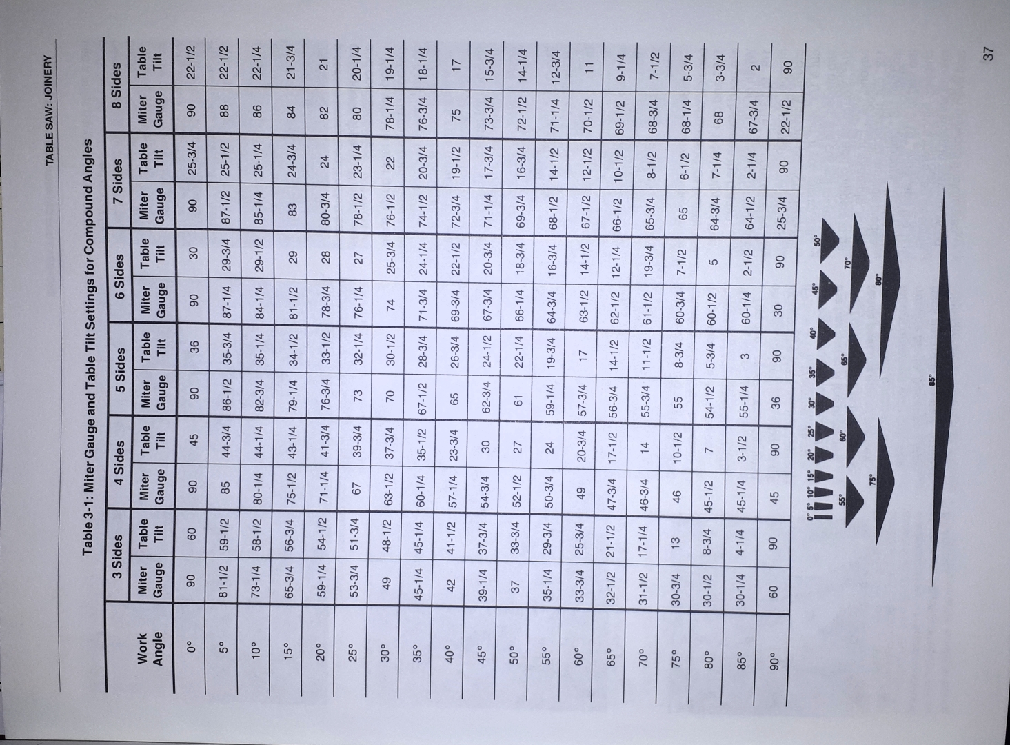

There is a section in Power Tool Woodworking For Everyone on cutting compound angles that includes a chart with the miter and tilt angles.
link to online version. https://www.shopsmith.com/acadhttps://w ... oundangles
I see that the link to the chart is bad. :(
here is a photo of the chart in my copy.

If you click the "printer friendly version" of the on line link above, the chart is on the last page. :)

Compound Angle Chart.pdf
(26.19 KiB) Downloaded 2042 times
