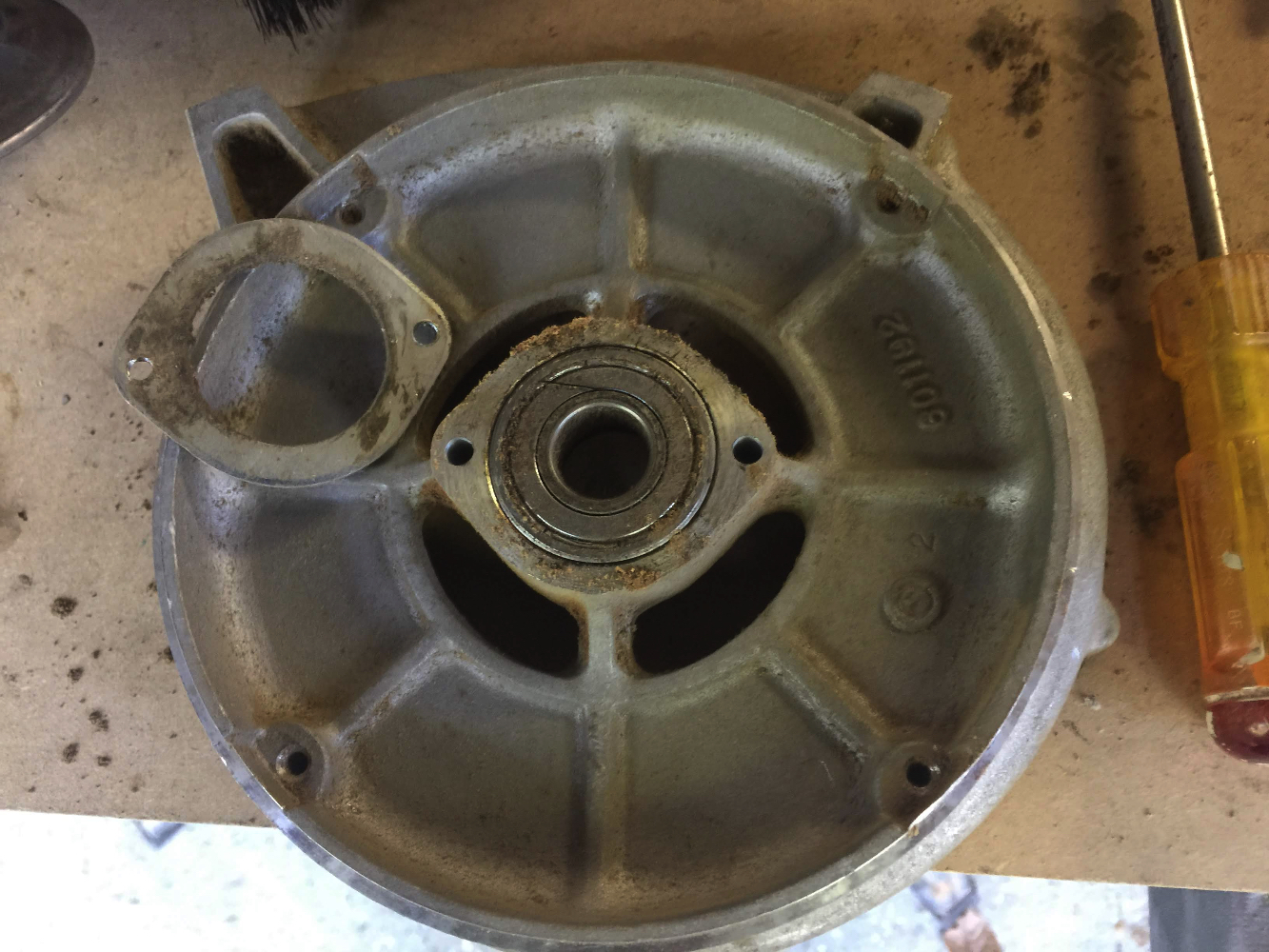

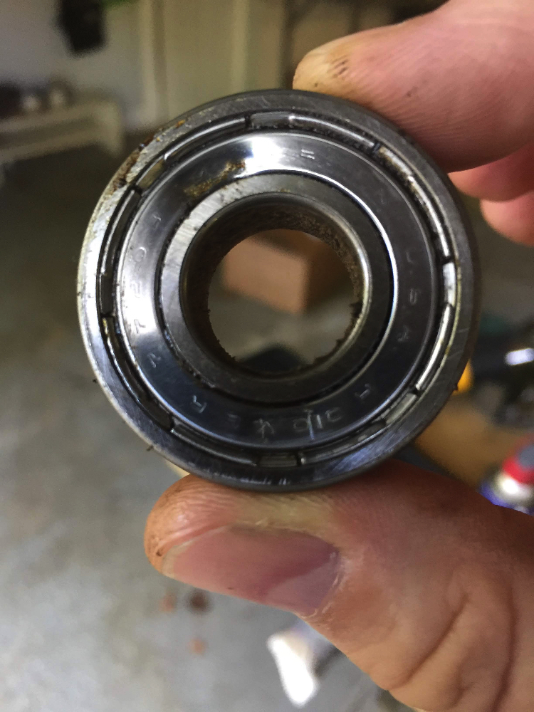

Now back to the front, the cover now comes off and the bearing is held in the cover by a small plate. The plate came off by removing the two small screws to reveal the bearing. But there is no obvious way to use a traditional tool to remove this bearing. All I could find was a small space where I could push the bearing out with a flat head screwdriver. Not ideal perhaps, but it worked. Unfortunately, it damaged the bearing, but not to the point that I couldn't read what it said.
@everettdavis, here are the particulars that I've collected so far using my calipers. Am I missing anything?
- Text on both sides of the bearing: HOOVER 77203 MADE IN U.S.A.
- Diameter D = 40.01mm
- Bore d = 16.87mm (0.663") (Not sure what to make of the non-standard size.
- Width W = 11.98mm
- Shaft = 5/8" (0.626"/15.91mm)
Thanks, guys! I'm making progress one baby step at a time. I couldn't have made it this far without your help.
...John

Look at the armature shaft. I think yours is .625 without any variation in the area the bearing goes.
So I think 5/8 "d" is appropriate. So 40 x 12 x5/8" .
Check the rear bearing shaft size the same way.

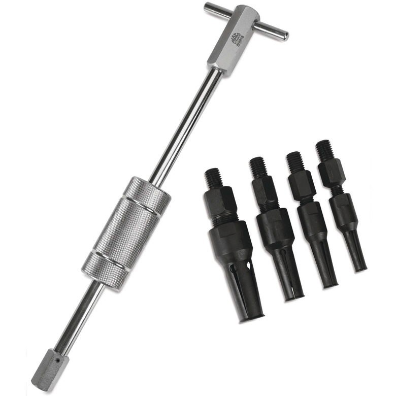

The tool you can use (opposed to knocking it out with a Screwdriver) is a Blind Hole Pilot Bearing Puller. In a bind hole, you could not get to the back side of the bearing. Some models of some motors have blind bearings.
I just borrowed one from an auto parts store last time I needed one.
The adapter goes inside the bearing then expands on the back side. The slide hammer then evenly pulls the bearing out of the housing.

Back in the days of manual clutch transmissions, that was called a pilot bearing puller. The pilot bearing was imbeded in the flywheel.
Note it requires pressure be applied to the inner race to pull out the tightly fit outer race. Hence should only be used IF the bearing is to be replaced.

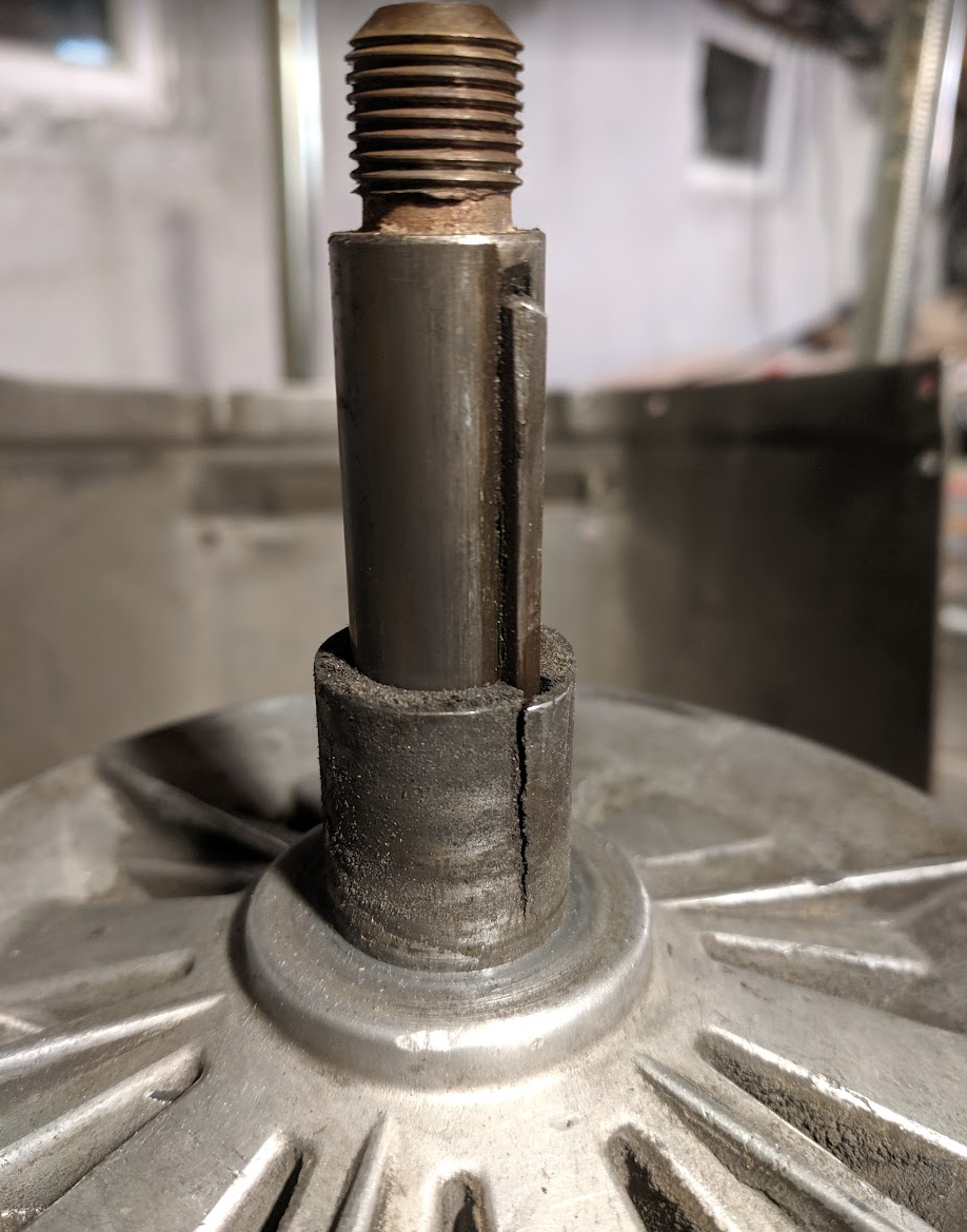

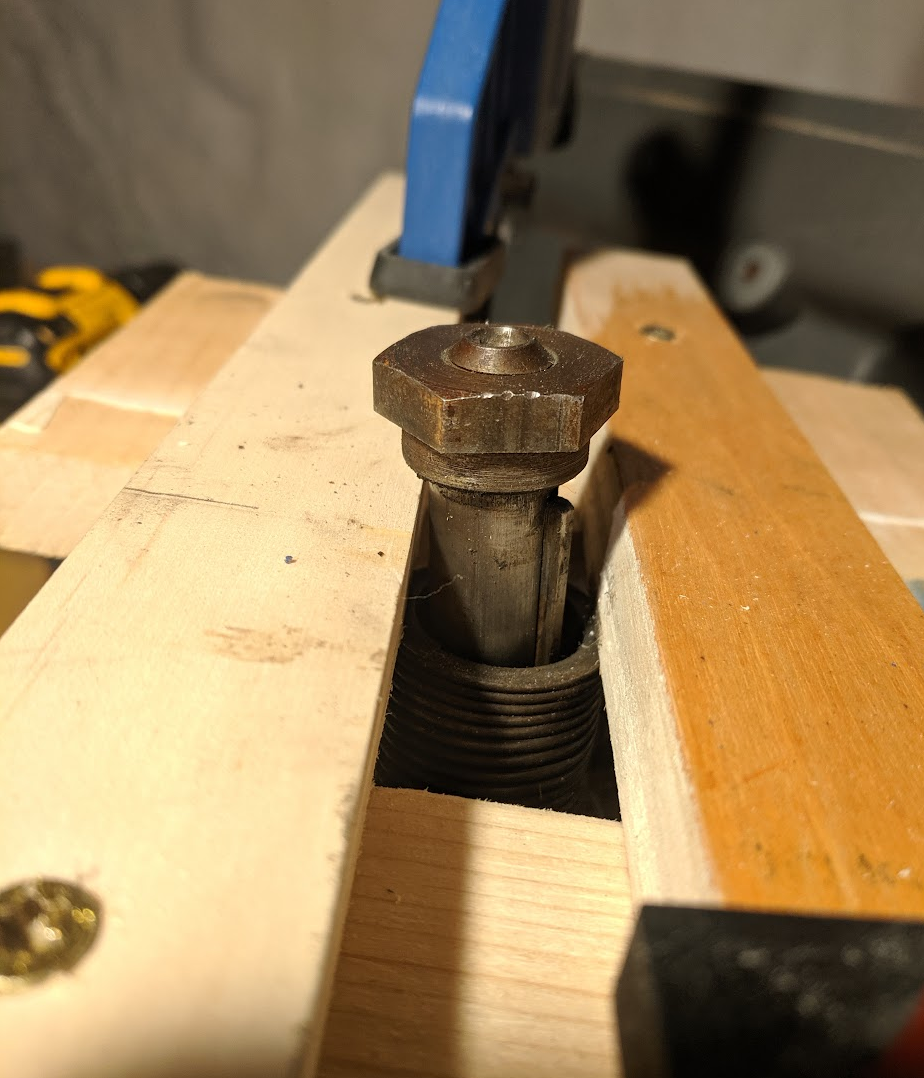

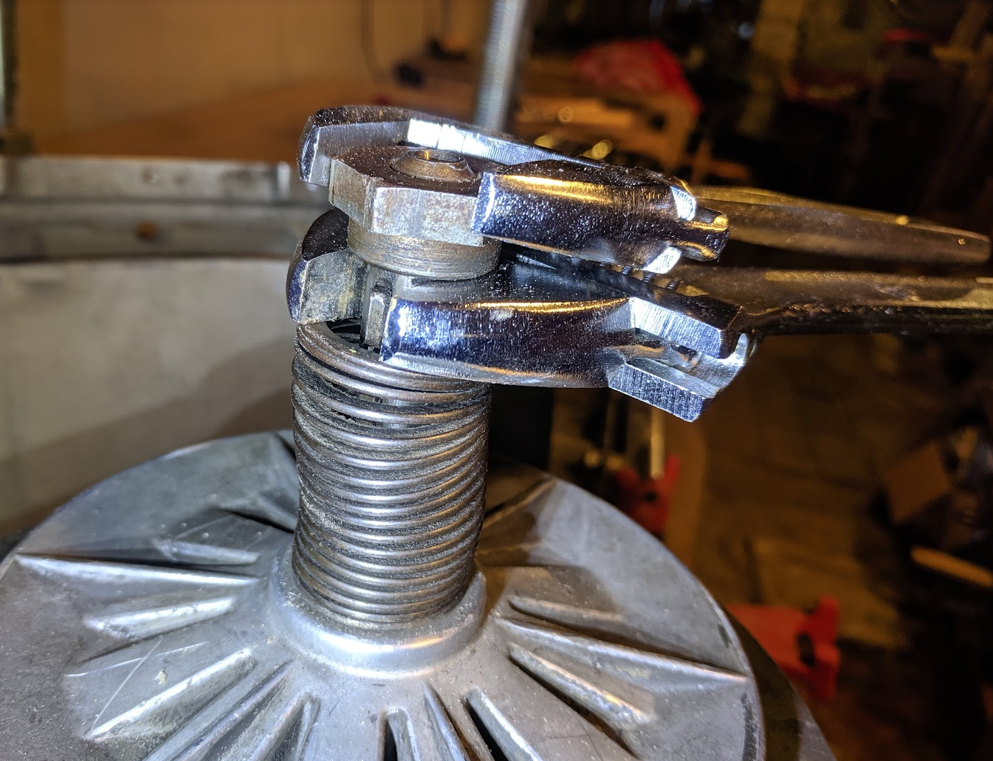

Re: AO Smith 3/4 HP Motor Rebuild

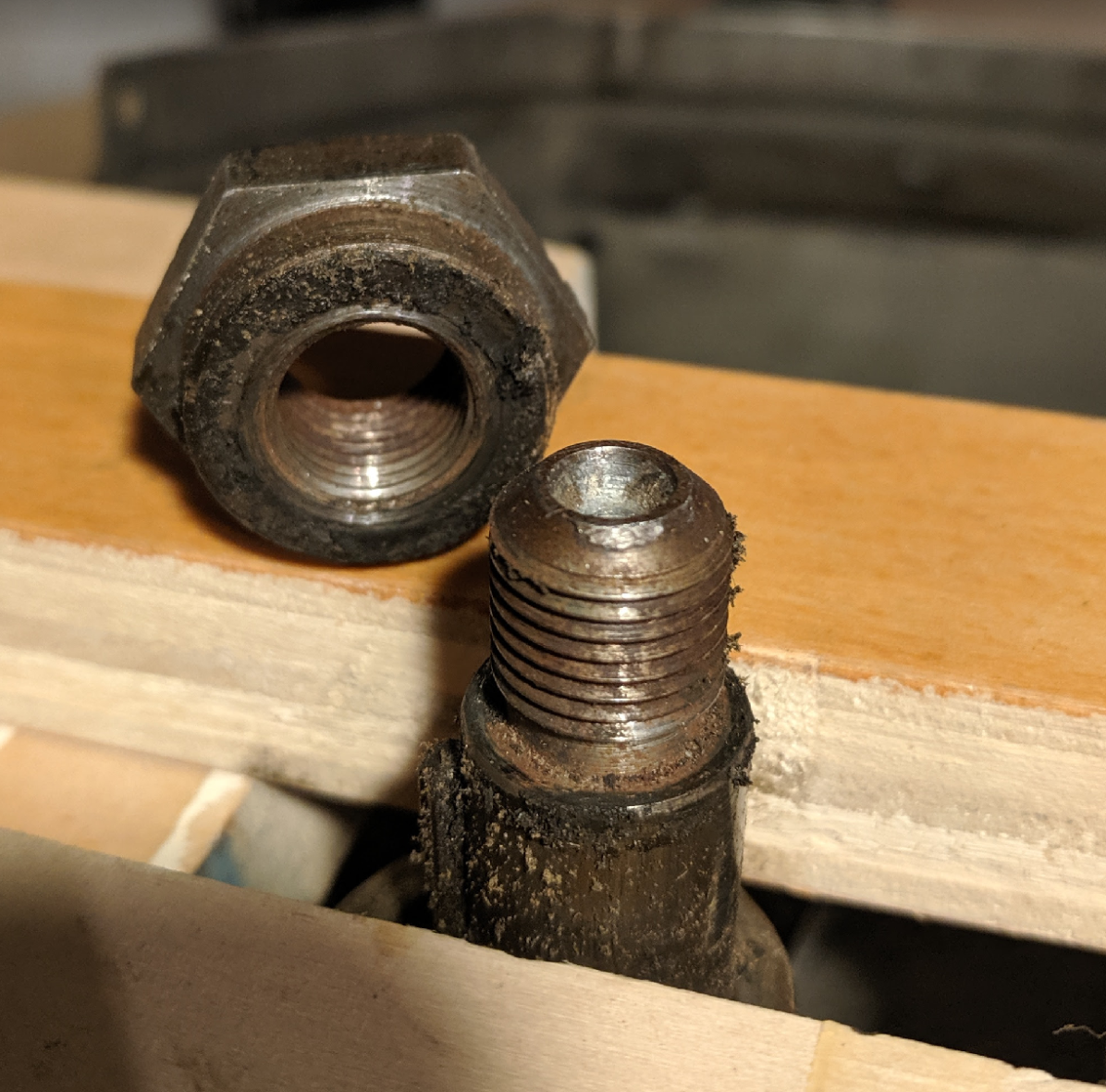

I bought a used Greenie similar to OP, and also ran into the motor shaft that didn't have the C clip or washer as described in manuals. Glad for the description here, knowing it was reverse-threaded helped!
I thought folks might find some additional pictures useful.
Instead of drilling a hole through a board, I screwed two narrow pieces of pywood side by side. That was able to press down on the end of the spring past the edge of the nut.
I wasn't able to get a good enough grip on the sheave to turn the nut. I tried a clamp across the sheave, a wrench on one of its fins, and a screwdriver in one of the slots. Eventually I used two screwdrivers to push the spring out of the way and then got a crescent wrench on the shaft. I think it did deform the end of the key, although possibly not at a point that would matter.
The removed nut.

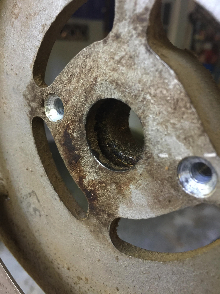

After all that, I think I need to replace it. The sheave was cracked next to the key:

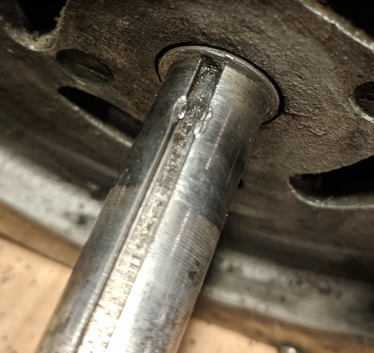

And the groove for the key in the shaft was deformed. I think the key got pushed up (and maybe the end was broken off?) so the key wasn't inside most of the stationary sheave, and so the set screw bent the edges of the groove. Also looks like there's no separate spacer in this model, the shaft is just wider at the base. (And as is often the case, the back of the sheave had a little indent worn in it.)

I would replace both the sheave and the key. Judicious filing of the damaged area of the key groove should be done.
Key is standard 1/8 x 1/8 key stock.
good pix!!!
