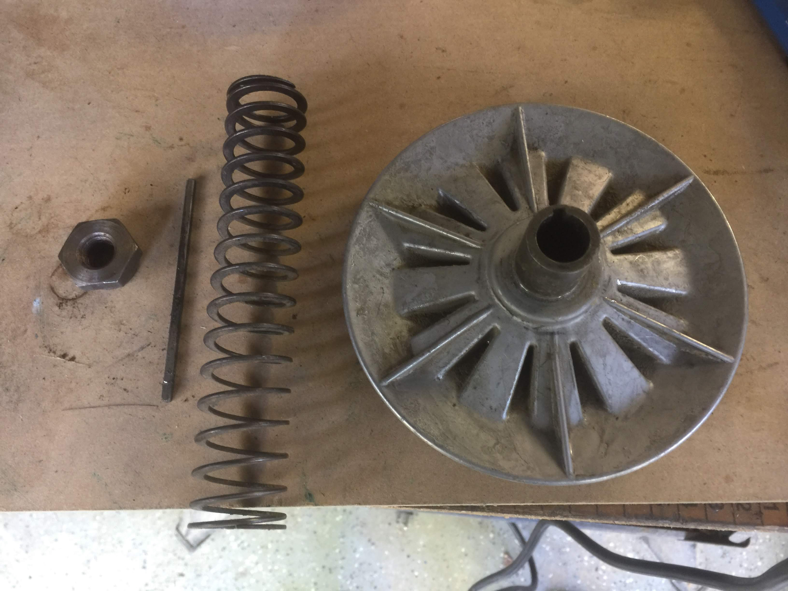

Well, I got the nut off by holding the spring down with a set of needle-nose vise grips and then rotating the nut clockwise with a brace between the fan sheave to keep the shaft from turning. Once I had that set up, the nut came off surprisingly with little effort.
But now the outside sheave is not wanting to come off the shaft. It is absolutely lined up with the key, but the key may not be completely flat from one end of the exposed shaft to the other.

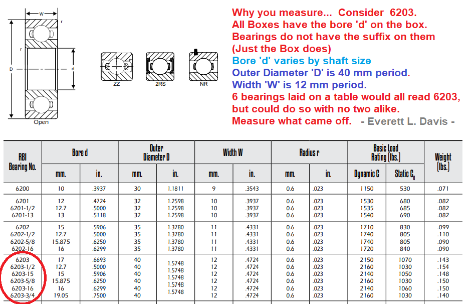

Be careful to measure each bearing carefully before ordering bearings. It’s critical to get the right one. Some bearings have the same part number base and different shaft size suffixes.

Thanks, Everett. There are some really good details in that post. I'm surprised about your comment regarding variations in the bearings. I would have thought that a given company would have to ensure that a part number was consistent across lots. I focused on NTN because that's what I see being sold online by everyone other than ShopSmith themselves, so NTN seemed a good brand to use. The ShopSmith bearings though seem to be significantly less expensive than the other brands, such as NTN. Is it your experience that the bearings sold by ShopSmith are similar, better, or of lesser quality than the other brands, such as NTN?
Also, a question, please, regarding the spreadsheet at the end of your ShopSmith Bearing Guide: If I have an April 1955 headstock, then do I have a "Mark 5", or a "Mark V"? Also, there are some cells with links for specific brands of bearings, but most are empty. If I find appropriate part numbers for a given vendor, do you want us to share those with you to help populate the table?

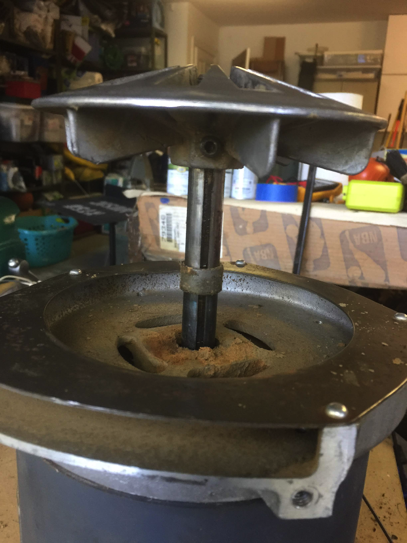

I'm slowly making progress. I was able to get the outer sheave off and with it came the key. I don't see any damage to either, but they are both filthy, so they may be hiding secrets.
The fan sheave, like the outer, didn't want to budge, but I finally got some motion after loosening the set screw and running some 12 gauge wire underneath the fan blades, so that I was pulling up from the center instead of just the outside, and almost instantly it allowed the sheave to move upwards -- until it got to the top, where it is now stuck ... again. I guess there is some anomaly at the end of that shaft that is beyond the tolerances of the inside sheave dimensions.
Any thoughts on how to proceed? Also, is the sleave between the fan sheave and the motor supposed to slide inside the motor cover? It's doing it on mine, but it doesn't look very proud of the cover, which makes me wonder about whether it is too worn to keep the fan sheave from rubbing once reinstalled.

The spacer fits inside and touches the inner bearing race. If it wears down, the fan blades on the back of the sheave will rub the housing. Personally, I order new spacers from Shopsmith for motors I remove sheaves from, just to be safe.
A.O. Smith made the motor for Shopsmith and selected the bearings. A.O. Smith had their own repair centers for decades. Shopsmith only sold replacement motors, not components of the motor.
I put together a graphic for you to explain why one has to measure.
1955 should be a Mark 5. Check the vent plate on the auxiliary shaft which should reflect the model in the text if visible.
The Bearing Guide was one for the headstock bearings.
I started a motor guide that is out there too, but my wife's stroke put a lot of things on hold. Someday I will get back to it. Skip past the dissertation on electrical power to get to the motor specific things that I did include. It's in the Motors folder for what it's worth.
Hopefully that will answer your questions. 6203 was chosen only to illustrate variances in the same bearing that you will have to navigate when you isolate the bearing type and dimensions yours are. I chose RBI only for their illustration in the chart, not to recommend them per se.
