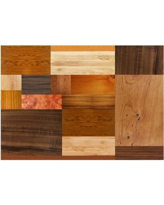

Was thinking making a inside window shelf for plants and what not, around 35 inch long and 8 inch deep. Idea being overlap the window sill and go out from there with L brackets for support...so initially going for an oak shelf, went to check didn't have a long enough piece, well ok maybe maple, same thing...hmm ceder looks nice, nope once again long enough not wide enough...long story couldn't find a single board big enough for what I want without having to do a glue up..don't want to paint it,don't feel like buying new wood for this project. I want the wood look..so I got to thinking (after several beers) if I have to have a seam why not go big lets have lots of seams..lol...maybe use all these scraps and glue up multiple pieces ranging from from 3 to 8 inch long and 1 1/2 inch wide each using oak, maple, ceder, pine and walnut staggered no stain just natural wood color and poly. Should look good...but I have never done something like this before and not sure about how the different woods will react glued up, mixing hard and soft, different grains etc..anyone done anything like this before anything I should look out for, any prep work needed etc...Thanks in advance for any suggestion

kinda this idea, except all my pieces will be an inch and a half wide with staggered lenght to avoid running seams and using different woods for each segment. Only the long axis will have running seams, if that makes any sense ... lol

Anything wood set in a window is going to take a beating. Warpage is going to be an issue. You might consider gluing up the shelf and after surfacing laminate it to a piece of 3/4” plywood. Then face the front edge with hardwood to hide the ply and stiffen it even further. You may want to consider using something like titebond 3 for the glue.

Hobbyman2 wrote:I ran into this once and wrapped some maple with walnut outer band .
Excellent idea but I think I'll use oak, don't have enough walnut. I also decided to forget the inch and half idea, going random sizes and grain direction a few two inch strips at various lenght but also a few bigger blocks thrown in and with your suggestion of banding thinking it should look ok. I taped some wax paper on my work bench and marked out the the shelf size so I can arrange the pieces and mock up until I like it, then I can glue up using the bench top as my flat surface (i.e the top of the shelf) without the pieces getting glued to my bench...lol...It would have been much easier to just go get a piece of lumber and make this shelf in one piece, but this is so much more fun, more work but more fun...lol...hey I am retired why do a one day project when I can turn it into several days...lol

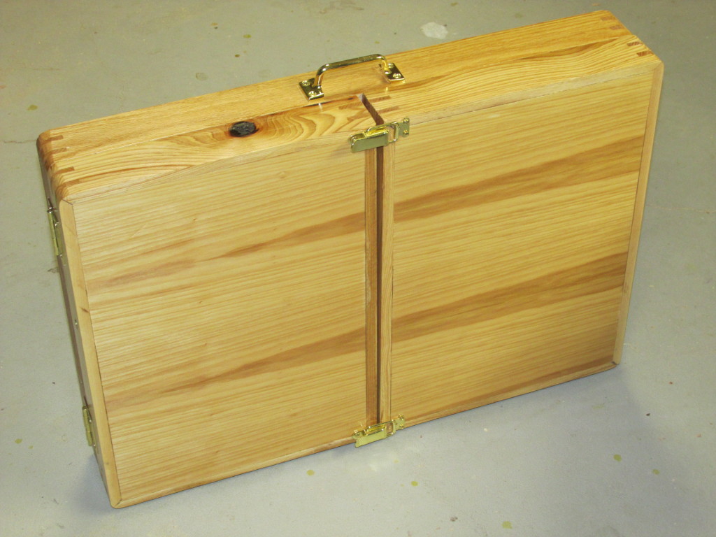

There is no reason you can't mix different woods on a project. I do that when I have a small project and find I don't have enough scraps of one kind of wood to do it.
A couple of years ago my Wife wanted a tool box to hold her carving chisels. I looked in my scraps and found a nice piece of hickory plywood to start, but not enough hickory for the rest of the job. So, I used whatever pieces of hickory, oak, and maple I had on my pile and made this for her.
