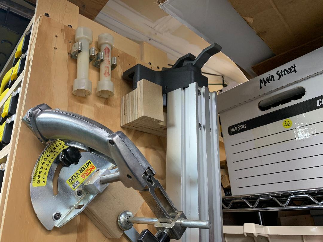

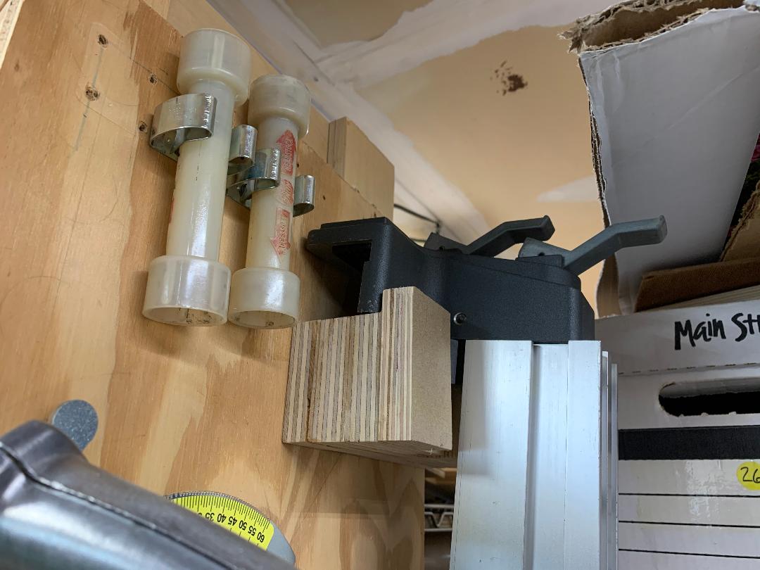

I don't know how well this would work for you but I'll show you how mine is hung. I have a piece of re-used plywood on a cleat. It holds a lot of my everyday sort of shopsmith attachments, this photo shows the rip fence portion of it.

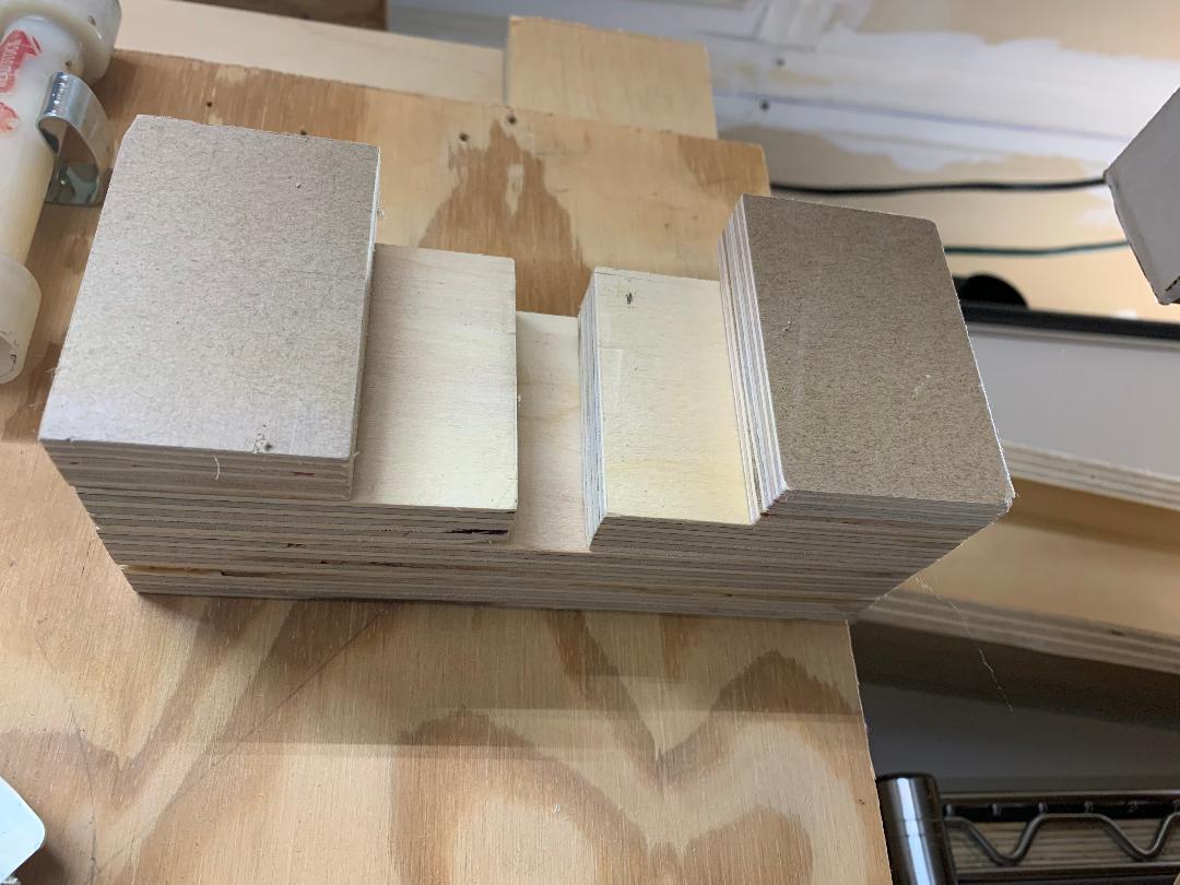

Here is a little closer look at the fixture:
It was all made of scraps of plywood. The stack is both glued and screwed together. The screws are put in such that the front surface is clean, ie from behind if you will.
Without the fence there you see the rest of it:
Of course you could fancy it up but I was going for functional and it works great.
