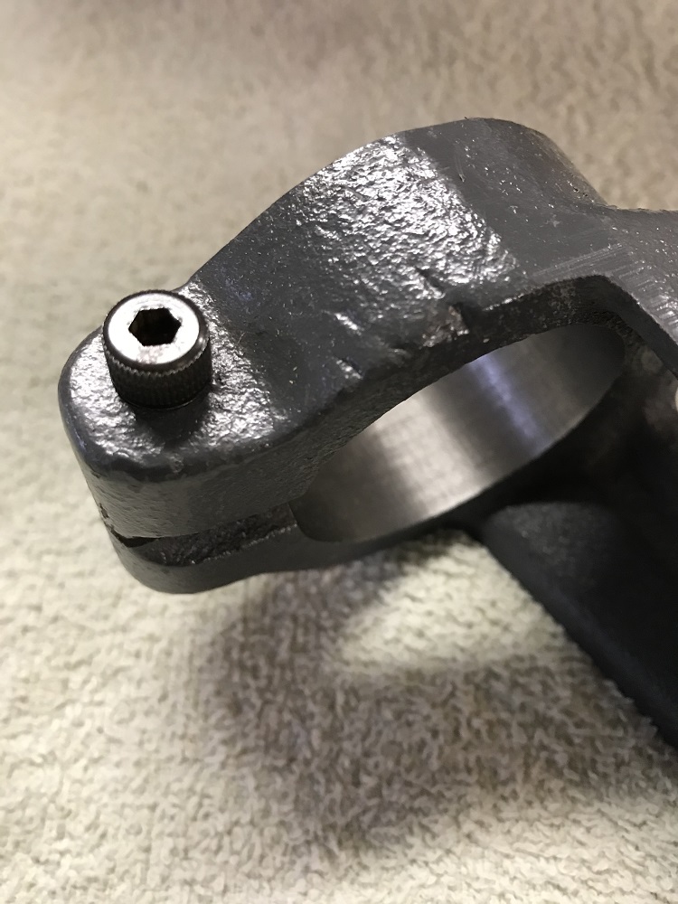

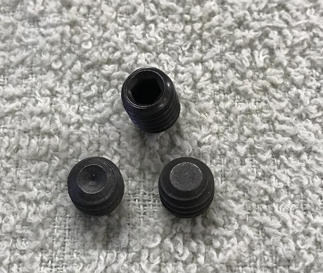

Sorry I do not know the term "grub screw". There are two general types of Allen Screws, the Set Screw and the Hex Head Cap Screw or Socket Head Screw used for the Shopsmith's. The pictures below show both types. The first is the Allen Set Screw in both cup and flat ends which are the most common ones used on the Shopsmith and accessories. The second is the Cap or Socket Head Screw shown on a Mortising attachment and can also be found in the headstock.
set screws.jpg (106.02 KiB) Viewed 13775 times
Hex Cap Screw.jpg (199.1 KiB) Viewed 13775 times
Both can be found at hardware stores that have a larger selection of screws, bolts, washers etc. This would be a cheaper and faster way to get them as Ron pointed out.
