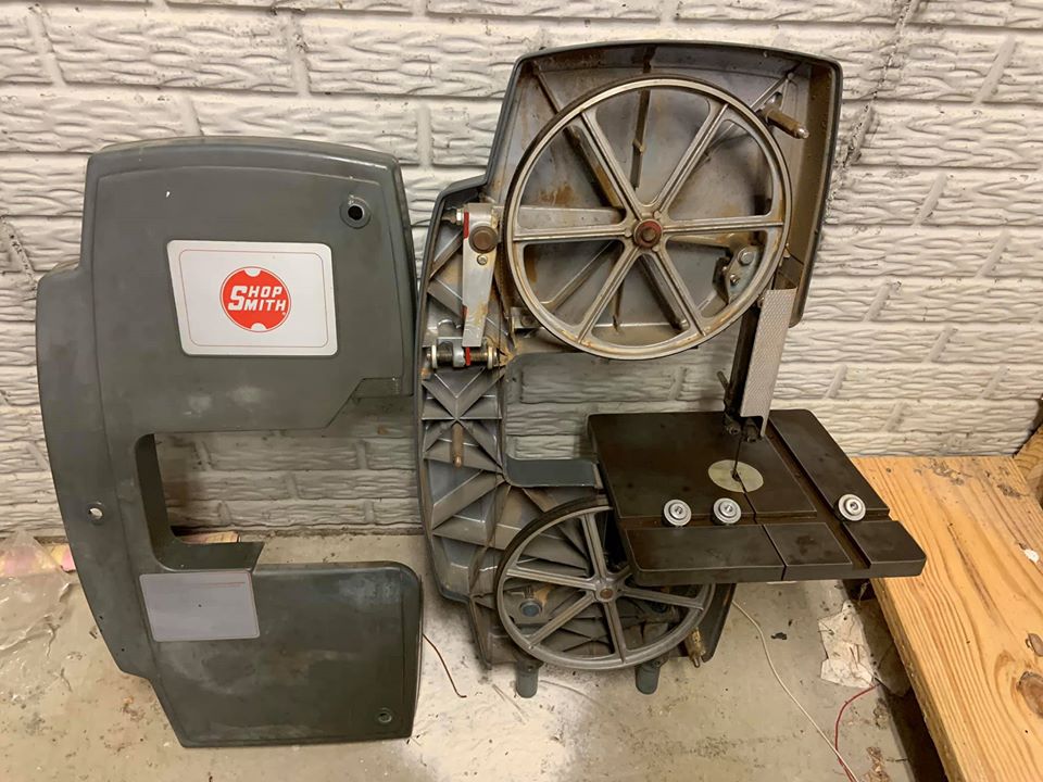

Figure 1 Condition Before, as received

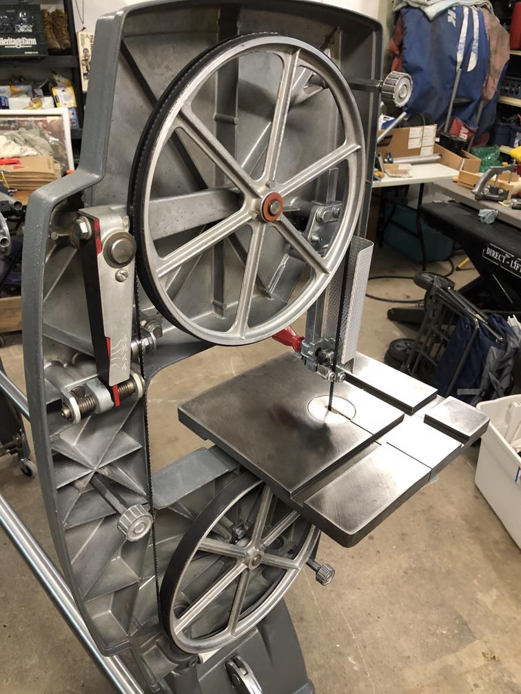

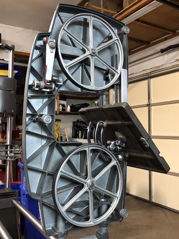

Figure 2 New Bearings, New blade, New Tires, etc...

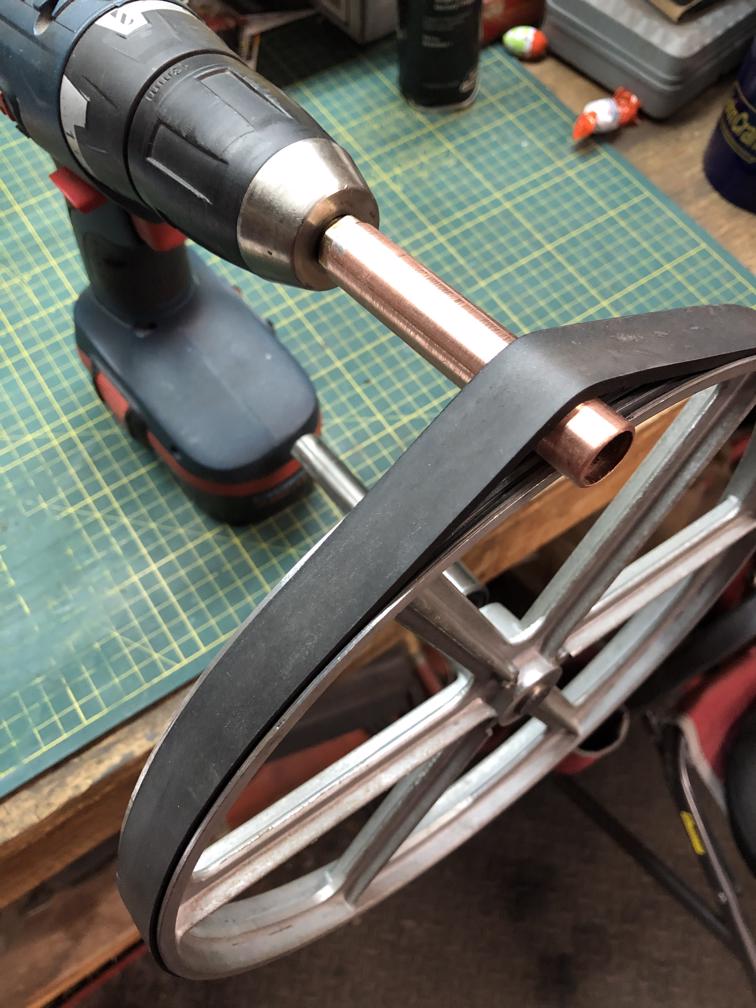

Figure 3 Gluing New Tires – Easy (copper pipe soldered to an air fitting)

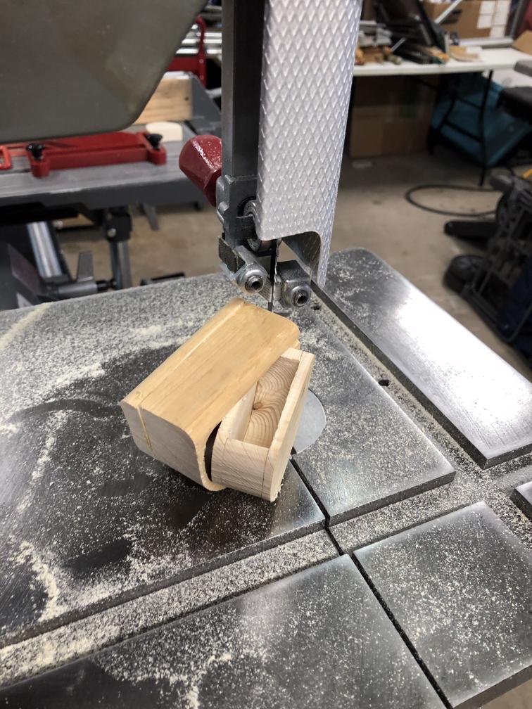

Figure 4 Initial 2 minute Testing (oops, the drawer is upside down)

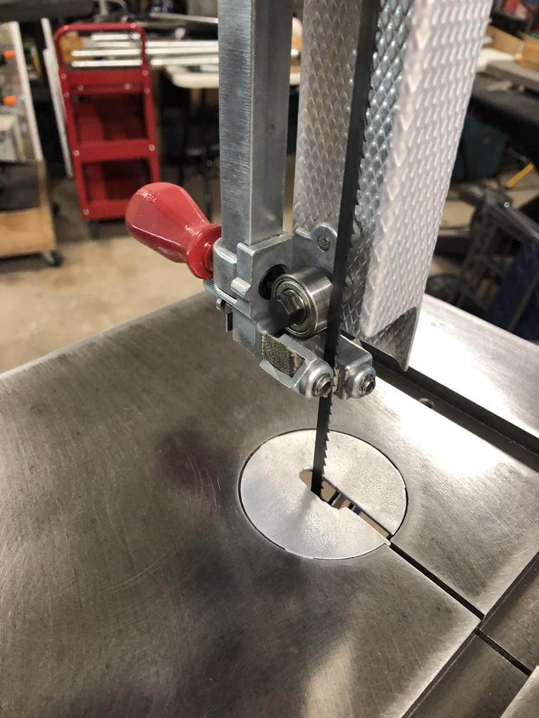

How did ya install the red handle? How did the copper pipe work out for installing the new tires?

Hey Beeg, I was originally planning on turning a replacement knob from wood and painting it red, then I remembered I have inherited a few hundred screwdrivers over the past couple years. The short red driver was the perfect solution. Heated up the metal shaft with a torch until it softened its grip a bit and pulled it out easily with pliers. Drilled appropriately tight fitting hole (careful not to drill through the closed end) to mount on the existing SS cam handle bar. Added some adhesive, it will outlast me. Simple solution and it works great.
I bought the SS rubber tires and adhesive. The tires mounted easier than I expected, and the copper tubing made gluing them up quite easy as well. I soldered the tube in an air fitting to mount in in my cordless drill. Spin the copper tube all the way around to re-tension the rubber equally first and make sure it fits well. Add glue carefully (I warmed it up a bit to make it flow) and turn the copper tube as you go around. You know when you get all the way around because the copper tube starts slipping in the glue where you started. Clean up with paint thinner, set the rubber down firm and done. Both wheels took less than 45 minutes to complete I'd say. Also important to note that I cleaned up the old rubber from the wheels completely, using a pneumatic die grinder with soft brass wire wheel. I think that is a must-do to get the new tires to run in their correct position.
