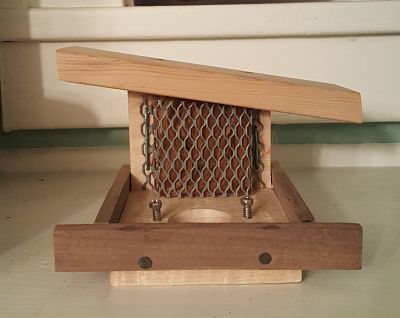

I have been interested in birds for several years. My interest was first piqued by hummingbirds; often called the "gems of the skies." I have been diligent in maintaining my feeders for them and have thoroughly enjoyed their beauty. I've learned they make tiny nests (around 1.5 to 3 inches wide) for their eggs and rearing their young. Through my research, I discovered that some people have made nest platforms for these birds- so being a woodworker and bird lover, i made one myself. I am going to describe this platform as maybe this will serve as inspiration for some forum members.

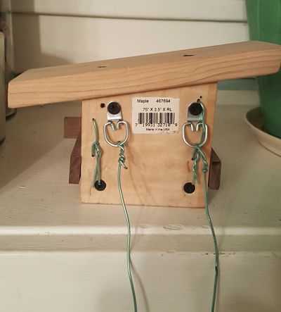

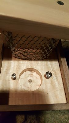

This nest platform does not have a roof over the cup/horizontal surface, as that would potentially inhibit their flight- however, there is a bit of roof at the back- which is providing some protection over the wire mesh. Behind the wire mesh is nesting materials for the birds and is meant to be kept somewhat dry for them. These birds use twigs, moss, string/thread, lichen, spider webs, etc to construct their nests. The wire mesh is held in place with some wire, and it can be removed, restocked and replaced as needed. I've used some d-rings on the back, and lengths of wire- this is meant to help secure the platform to a tree. I used a forstner bit to cut a small circle into the surface so the nest can sit in the cup. In the center of the cup, I drilled a small hole which is meant to serve as a drainage hole. I took 2 bolts (because they'd have a finer thread) and I ground the sides of the heads of the bolts (in one of the pics you can see one is ground down and the other wasn't yet altered). These are meant to be anchoring posts (a replacement for the twigs/ tree branches they'd normally use)for the nest as hummingbirds like to use spiderwebs (usually attached to twigs/tree branches) in their construction for elasticity (which provides a helpful stretch when the babies start to grow). I used a bit of walnut around the edges. This was meant to provide a sort of landing perch, as well as a further back-up support for the nest and babies.

Oops, I meant to add more pics before submitting- here are the other ones.

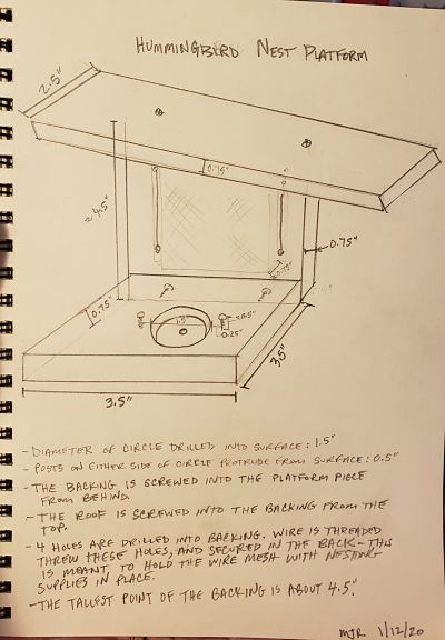

One of the members sent me a DM expressing interest and asking for some measurements for the hummingbird nest platform. I have done my best to draw a build plan in case others consider building one of these. The only pieces that are not shown are the walnut trim that wraps around the platform on 3 sides- I didn't include them as I thought it might make the drawing a bit confusing. One other point about the trim- the member who DM'ed me asked if there was any drainage for the platform surface in case rain collects. Though there is a small hole drilled thru the cup's center (specifically for the nest to have drainage), I did not include any surface drain holes. He made a good point, so if I were to use this design again, I'd likely take this into consideration and drill a few holes (at platform's surface level) through the trim on either side to allow for drainage just in case. It is important, however, to consider that these platforms should be secured in a place that provides some protection from the elements- for instance, mine is in a tree that is evergreen, so it's always got some shelter. I've also seen these installed on houses/shops near the eves which gives added roofing from the elements- but isn't as helpful in the camouflaging department (unless it were near some hanging baskets, which would help).
Let me know if you have questions. And if anyone does build one, please post a pic, or send me a DM of it- I'd love to see what other people come up with.
