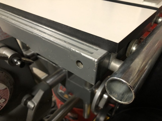

Just curious if anyone knows why the main table has four small 3/8” dia holes in the outer perimeter, one in each corner? None of the floating tables or extension tables have corresponding holes. So far in all my reading I have not found any reference to these holes and what they might be used for.

I think you can safely assume that they don't serve any useful purpose because mine doesn't have them.

Check out Dusty's post on this thread below. I believe the holes on the side of some of the 510 main tables were just for manufacturing purpose, i.e. they have no purpose for Shopsmith owners. Not every 510 table had these, I believe.

Perfect thanks. I had noticed a few differences in earlier/later 510 tables.

Steele510 wrote:Perfect thanks. I had noticed a few differences in earlier/later 510 tables.
Fer sure!
Tapped holes vs kep nuts(and access holes), center rail mounting hole location and rail tube wall thickness.
I also think the 'extra' holes in the sides are for tooling use during manufacture.
