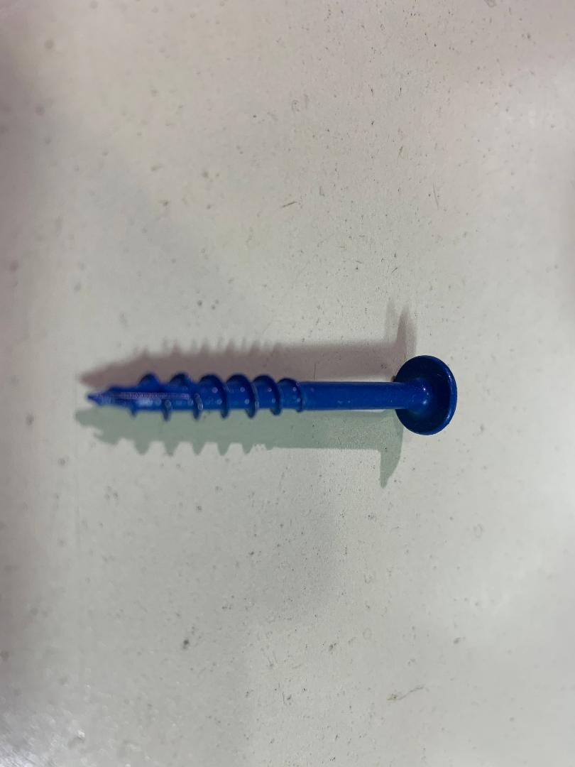

The length of the screw is important because if it is too long it might have the point come through and wreck your project or too short it might not have enough grip and could fail. That is the obvious bits.
A secondary thing to think about is the how the screw is made to work. Note that the screw only has threads part way up the shank.
The top portion has no threads, because this is how the screw pulls the mating parts together. The threaded portion is in the mating part and the un-threaded is in the pocket hole part. If the screw length is wrong then it will also likely not work the way it should. By either having threaded screw bits in the pocket hole portion thus not let the joint pull together or clearance in the mating part reducing holding power.

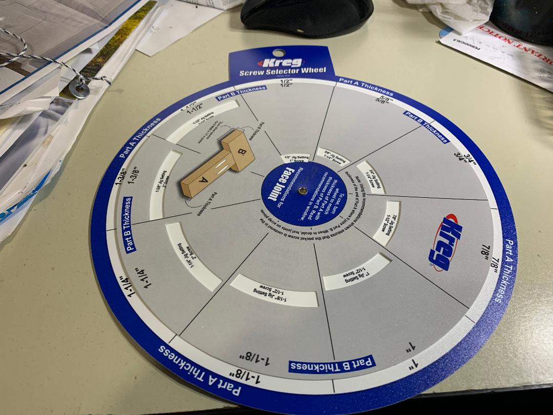

The typical wood thickness for pocket holes are in the lower range of 1/2" and work up to 1-1/2". So as you might guess there are a few different screw lengths that are also common. The most common I feel are the 1", 1-1/4", 1-1/2", 2" and 2-1/2". I did get some .75" ones for a project but that would be an outlier.
So why the various lengths? The idea behind the pocket hole is that the pocket hole jig puts the pocket hole in the the work piece with the exit hole being in the middle of the thickness of the work piece. The jig is a fixed (I believe) 15 degrees so to accomplish this for different thickness of materials the jig has to be placed at different locations from the joint. As this point moves so changes the length of screw needed.

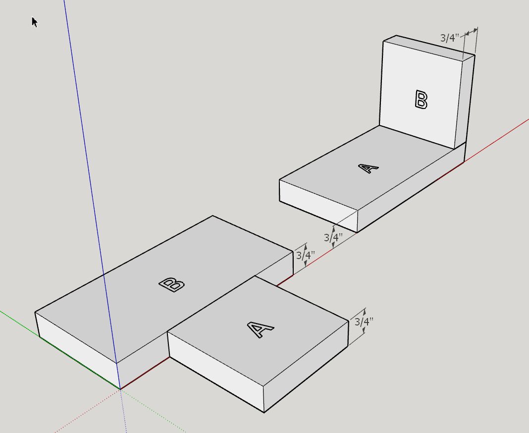

There are two basic joints that you make, one they call a face joint the other an edge joint. A face joint is where the materials are on the same plane and the edge is when they are not, most commonly they are at 90 degrees to each other.
Before we get to far on this keep in mind that the thickness is the actual thickness not the nominal one. As an example a 1 x 4 the thickness is 3/4" so that is what you use not the 1".
Looking at the face joint (left one) and assuming the thickness is 3/4" for both pieces you would use a 1-1/4" screw. If the two parts were say 1/2" thick then the screw length would be 1". If they were 1-1/2" thick then the screw length would be 2-1/2". Kreg provides tables for this but I got this screw selector wheel seen below.
What ever works for you is fine but you do need to do more then guess.

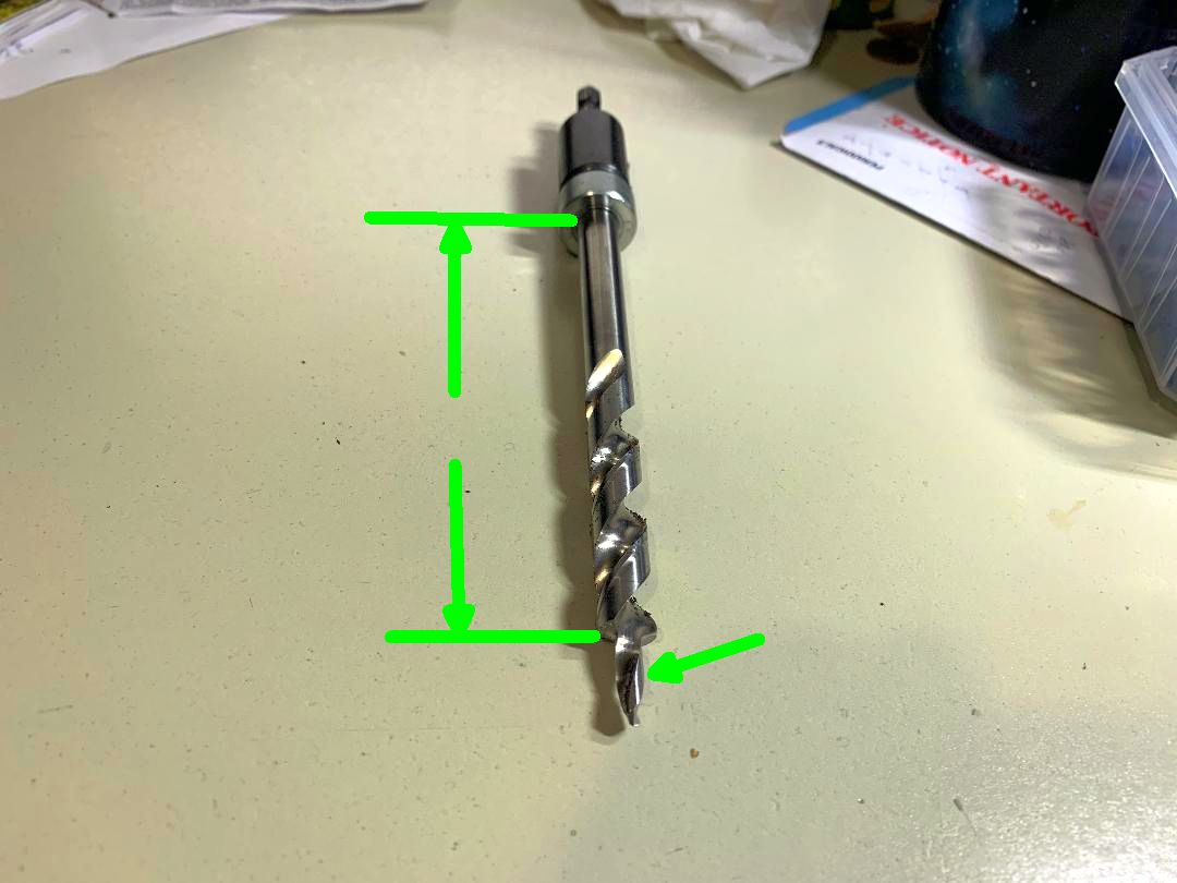

The kreg jig requires a special bit to make the pockets. It is basically a stepped bit that looks like this:
When we talk about setting the collar depth stop it is from the collar to the step of the bit as shown with the green measurement. The point is not in the measurement.

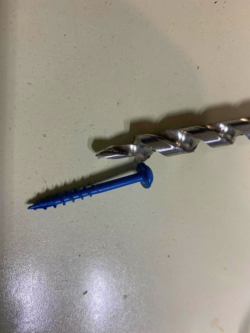

In this picture note how the pilot part of the bit corresponds to the screws un-threaded portion.

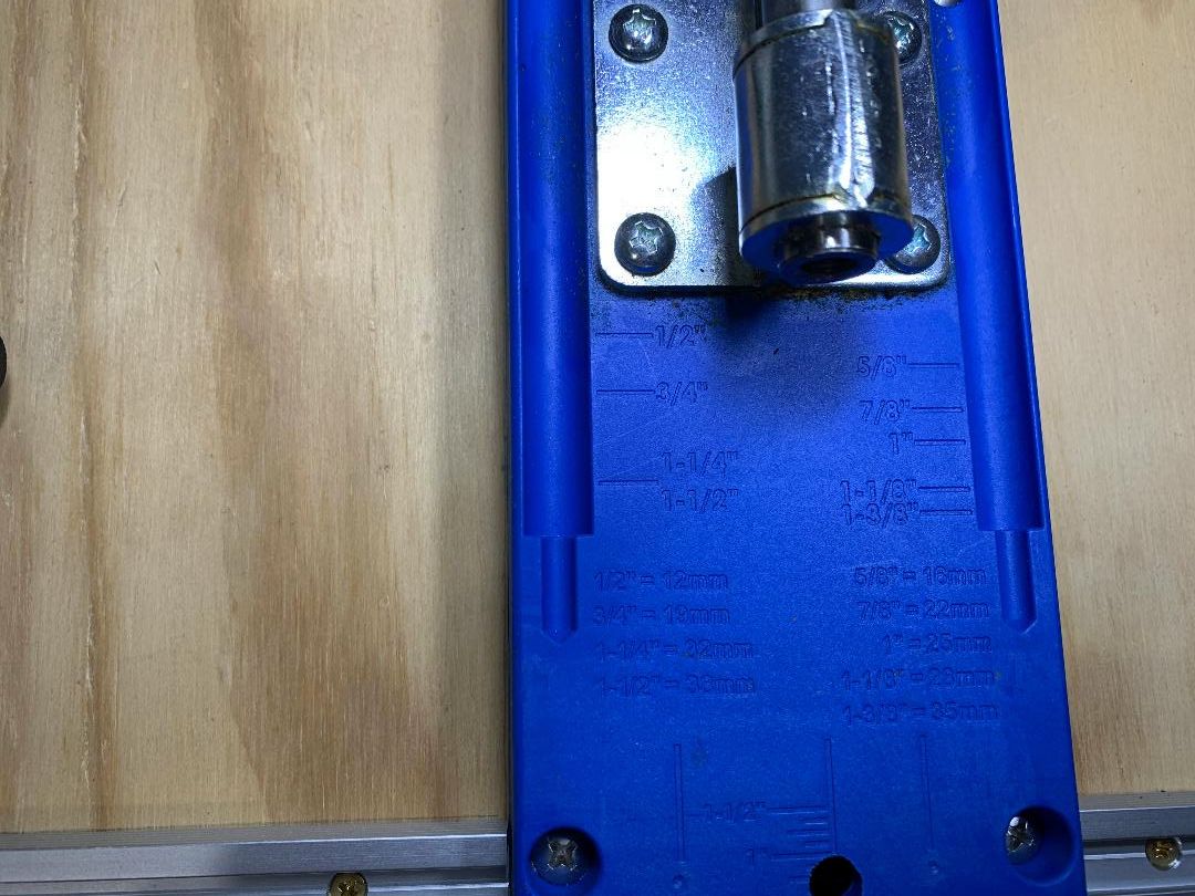

As an aide in setting the depth kreg has various helpers. On this jig they have a depth gauge built in. Not really easy to see in the photo but not so bad on the tool.
This is only an example so what you have many or many not look like this.
To set the depth you first need to know the actual thickness of the material. Then you loosen the collar and put the bit in the jig, set the depth and tighten the collar. Here is the bit set for 3/4" material:

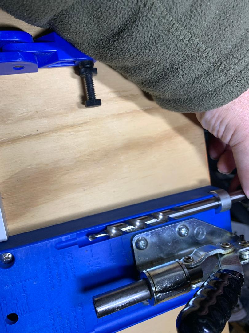

This brings us to the the main part of the jig. There are metal guide bushings to guide the bit and keep in on course. Again kreg makes a few of these so this is just one example. In this picture you can see the portion of the jig that is against the material when drilling.

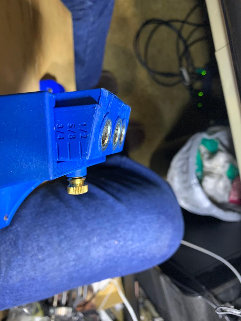

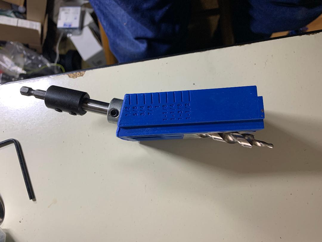

This is what the bit looks like when set to 3/4" material and inserted in the jig all the way. Also note the markings on the side of the jig.
Those numbers are used to locate the jig into the mounting system as seen here:
At this point we have our bit and jig set to drill pocket holes in 3/4" material.

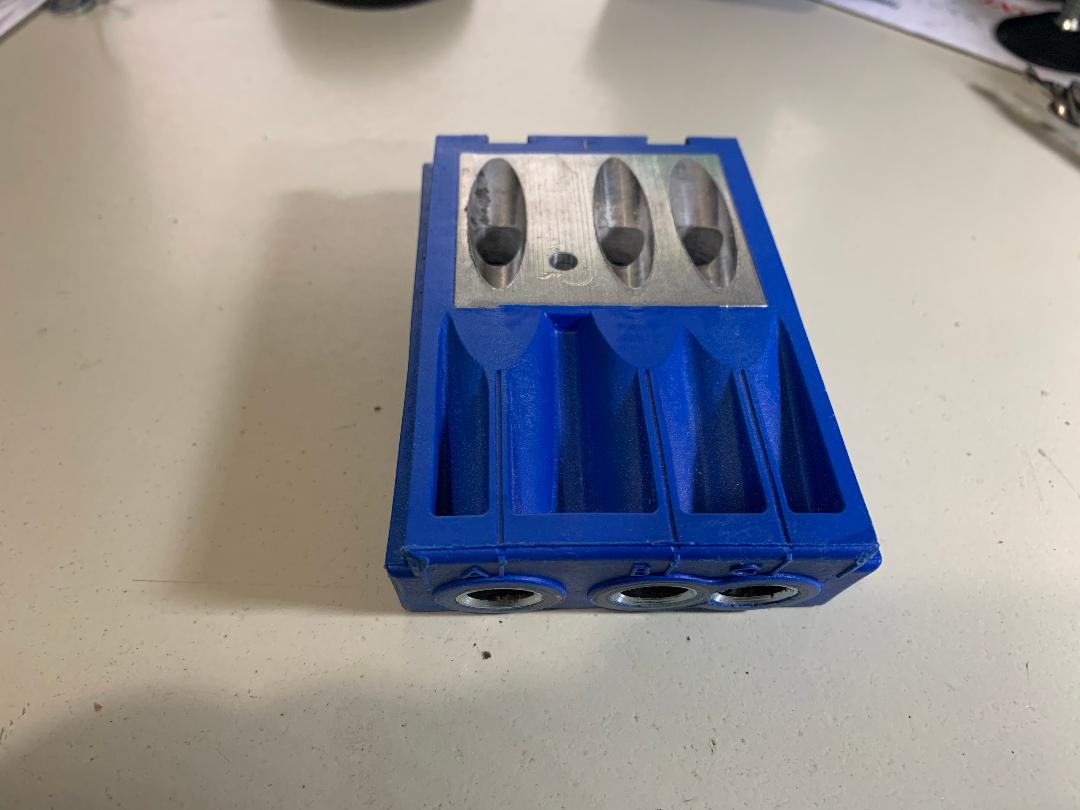

Now a big question is how many pockets should you put in? Well again that depends but there are rules of thumb for this. And if you happen to have the jig I do then we can get some information from that.
As you can see there are 3 holes, and they are labeled A,B, and C. The spacing of the holes then relates to the spacing that is best for the pocket holes depending on how wide part "A" is. This type of joint pretty much needs two pockets minimum. If the part were 1" to 2" wide then you use the hole pair of B and C. If the part were 2" to 3" then the pair A and B is best. If the part is 3" to 4" then the A and C is used. These are not set in stone and you might find a reason to cheat a little.....
Now while we are at it there are times where you might be attaching a panel where there are longer lengths involved. In that case start in 2" on both ends and then space the pockets every 6". You can use any of the holes for this.
If you happen to have one of the jigs without the hole pattern this might help. I just have a cheap plastic rule here with me so these dimensions are close but not likely right on, but should be close enough to use. The A-B hole are 7/8", the A-C is 1-3/8" and the B-C is 9/16". I'm sure kreg has this spelled out some where so you could see if you can find it if it importation to you.
