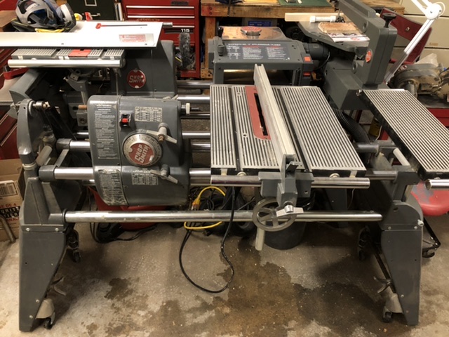

Completed my SPT set today, found locally a used jointer to add to the collection.
- Belt sander
- Strip sander
- Lathe Duplicator
- Scroll saw
- Band Saw
- Thickness Planer
- Edge Jointer
- Conical Disc Sander
- Biscuit Jointer
- Various router, shaper, and moulding bits
Add to that the original SS functionality for Table Saw, Boring/Drilling/Sanding/Polishing and Turning and I think we have a winner!
Time to make some saw dust!
Too bad I cannot run them all at once where they are currently mounted ;)

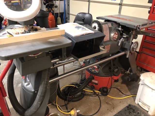

Really appreciate the thoughts JPG, I wasn’t considering the main carriage and no doubt that will make a huge difference on the optimum shorty length, if there is such a thing. Still early, I’m likely to think about this for a while before ever making a tube shorter.

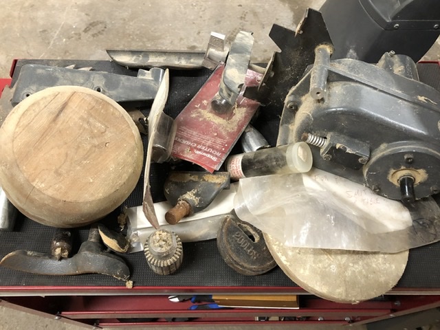

I did pick up the second SS today, its a year or two newer than what I had but has been lost and forgotten for a couple of years by the looks of it. It runs and I’m sure it will clean up nicely. Really a minimal investment, a barter trade which you could argue I have about $150 invested. Came with all tables, fence and a lot of turning items. Missing the miter gauge and all drive hubs. Came with saw blades and lower guards, no upper guard (I have a spare already). You’ll see another speed reducer and a couple of router and drill chucks. A mixed bad of goodies. I think this was predominantly used as a lathe, it was extremely dusty and the powerhead is literally full of dust.
Glad I picked up an air cleaner last week.
