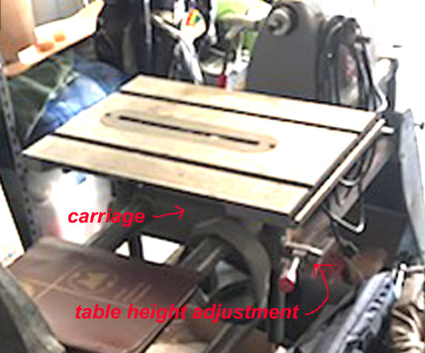

I am curious how you got the main table mounted backwards. Has the carriage been installed backwards? *
* Never mind! I now see the table is NOT mounted in the carriage(which is now in the basket of 'stuff'). It will 'sell' better fully assembled.

I think there are two carriages ... one mounted backwards (relative to the headstock, which has been turned around) and another in the box.
At first I thought the table was reversed, but then I saw the knob for securing the unit in drill press mode. The headstock has been reversed.

The headstock is definitely backwards, and the headstock on the wrong side of the carriage.
Envision lifting the system into drill press position and the quill and drill chuck would be pointing towards the ceiling, not the floor.
Some operation that the original owner may have prompted them to run it that way, but it is indeed backwards on the way tubes.

And the main table is NOT mounted into the carriage either.

Thanks for the responses! I’ll correct the erroneous assembly. Is it possible that the unit is reversed to facilitate mounting the Planer?

You have a jointer, not a planer. Regardless the 'misassembly' does not affect the jointer mounting.NavyGeo wrote:Thanks for the responses! I’ll correct the erroneous assembly. Is it possible that the unit is reversed to facilitate mounting the Planer?
