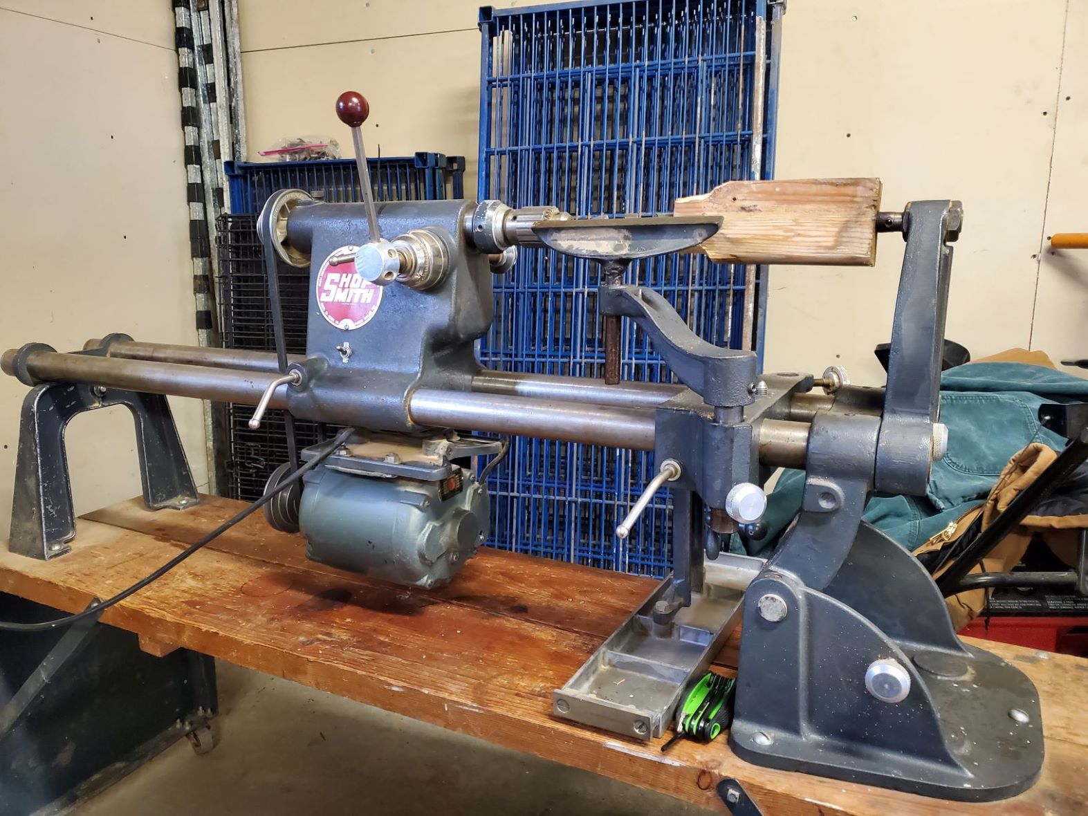

Thank you everyone, I will post some pics here soon as I figure out how to condense them to meet parameters. So quick question, one of the main reasons I bought this is to use the lathe and do some turning but as I learn more about the features I am also looking forward to exploring the posibilities. So my question is for you other turners what is a good all around chuck that you have found. Thank you in advance and again for all the great information and well wishes.
Re: Well Maintained Model ER
Posted: Mon Mar 30, 2020 6:00 pm
by SeanPelfrey
- LatheII.jpg (333 KiB) Viewed 19490 times
Alright let's try that pic thing
