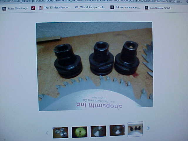

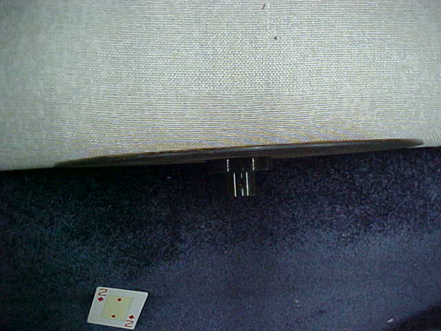

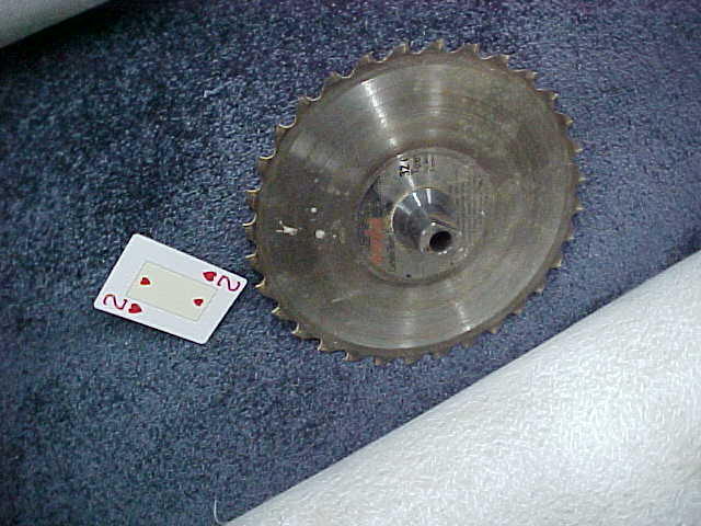

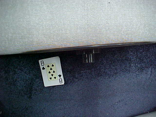

I studied the various photos of the arbors that were available at https://www.shopsmith.com/ss_forum/comm ... 22629.html but I still don't feel comfortable identifying the 500 arbor versus those that are intended to be used with the 520 table. I even looked on Ebay but I can't confer veracity because I don't know the seller's experience with Shopsmith items. So, here I am at the mercy of the Shopsmith forum for answers. The Shopsmith site only shows the modle 500 arbor. Are the arbors pictured with the sawblade compatible with the 520 saw table?
- MVC-132S.JPG (42.14 KiB) Viewed 29184 times
- MVC-133S.JPG (37.3 KiB) Viewed 29184 times
- MVC-134S.JPG (43.82 KiB) Viewed 29184 times
- MVC-135S.JPG (38.21 KiB) Viewed 29184 times
- MVC-136S.JPG (43.27 KiB) Viewed 29184 times
- MVC-137S.JPG (41.41 KiB) Viewed 29184 times
- MVC-138S.JPG (37.5 KiB) Viewed 29184 times
- MVC-132S.JPG (22.22 KiB) Viewed 29178 times

I believe the 'magic' dimensions are:(face of blade/disk to end of arbor)
m5 /V 500 saw 1 1/4 steel sanding disk 1 1/4
MV 500+ saw 1 11/16 steel sanding disk 2". Saw maybe 1 23/32"

To help with understanding, the incompatibility is between blades/discs and the blade guard. The arbor length positions the blade correctly for the given guard system.
Sanding Disc - Unlike the early M5/MV, for 505/510/520/M7 the Sanding Disc can be used with a lower blade guard and operate through the table. The guard is not so much for safety as for a significant improvement in dust control. Speaking for myself, through table sanding with guard is the preferred use. IIUC, for any other use the discs are interchangeable. For sure, I can use a 520 sanding disc on my Greenie and it works just like any other sanding disc. And I can use a 500 disc on my 520 for sanding without the guard, but I don't.
Early M5s did not come with a blade guard, it was optional. I don't know when it became standard equipment, but I'm sure someone here does. Some, including mine, still do not have a blade guard. SS has offered retrofit blade guards for years but I think it was recently discontinued. So, IIUC I can use my 520 arbor on my Greenie and it is neither better nor worse than the 'correct' arbor. It would only be incompatible if I had the blade guard. (I never do that and I won't because the 520 is far superior as a saw.)

In addition to the guard interferences, there is the saw blade 'auto alignment' that the differing arbors provide. In sync with the carriage spacer, the saw blade arbor self positions the saw blade within the table slot when the carriage is pushed against the spacer tightly to the headstock.

It appears you have gone into Arbor overload. When the Mark V 510 and 505 were released they needed longer arbors for the saw blades and hubs for the sanding disk. When I mention 510 that includes the 505 as it is the same Table System without the floating tables. The Lower Blade Guard for the 510 and later the same one for the 520 and Mark 7 has a longer throat connecting it to the Quill. This lower guard is not to be confused with the 500 dust collection chute which is a stripped down version of the 510, 520 and M7 lower guard and can use steel Sanding Disks with the shorter hub. Now that we are on the Sanding Disk the short hub (1-1/4") is for the 500 or original table system. The longer hub (2-1/16") is for the 510, 520 and M7 tables. This longer hub Sanding Disk can be used with the Mark V 510, 520 & M7 lower blade guard for dust collection. The short hub Sanding Disk cannot be used in a complete 510, 520 & M7 lower blade guard.
As for arbors, only the 1-1/4" and 5/8" Saw Blade arbors differ for the table systems. There have been only three longer arbors specifically for the Mark V 510, 520 and M7. 555130 is for the 1-1/4" arbor hole SS blades and at first there was 555118 for 5/8 " arbor hole blades that was replaced by 555608 that was originally made for the Sawsmith Table Saw. 555118 looks like a longer version of the arbor 555321 for the 500 table. Below is a listing of those Saw Blade Arbors and their overall length.
505511 - Mark V 500 1-1/4" Saw Arbor - 1-5/8"
555130 - Mark V 510/520 1-1/4" Saw Arbor - 2"
555321 - Mark V 500 5/8" Saw Arbor - 2"
555118 - 5/8" Saw Arbor - 510 only - 2-1/4"
555608 - Mark V 510/520 5/8" Saw Arbor - 2-1/4"
I hope this clears it up some for you.
