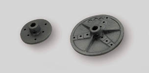

Posts: 3488
Re: lathe flexing
Going back to something you said in you original post.
I use a 6" face plate and the 4 screws are all tight.
Does this faceplate fit snugly on the Spindle before you tighten the set screw? Are the 4 screws all attaching the wood? I ask because all 6" Faceplates ever made by the companies making the Shopsmith Tool from the Model 10E to the Mark 7 today use sets of 3 screws to hold the wood being turned and have a single set screw as shown on the right for the 6" faceplate in the picture below. There is nothing wrong with using another brand faceplate as long as it fits properly.
Lathe Faceplates 505590 and 505591.jpg (12.59 KiB) Viewed 9621 times
