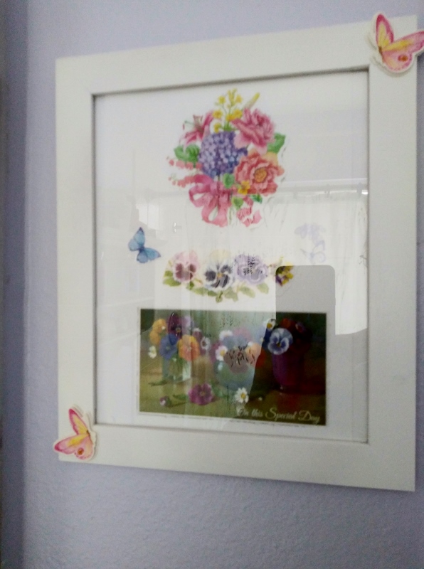

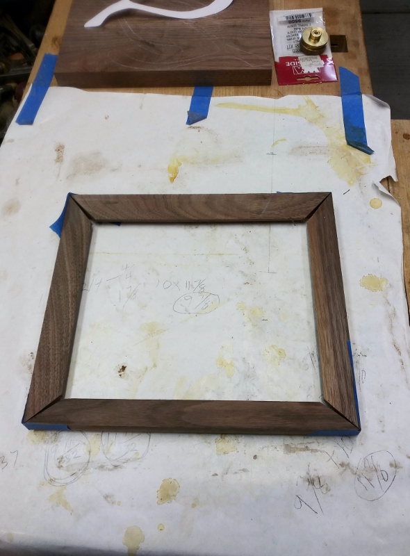

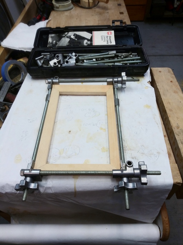

It started with a question that sounded like a statement. But first some background. Around our house when the spring cleaning bug hits the redecorating gene also surfaces. The question/statement - With all that expensive fancy woodworking machines you can make me a plain shadow box picture frame right. I was trapped.
So I decided to make a picture frame with compound mitered corners. My first attempt didn't turn out very well. Evidently I didn't understand compound miters. A search led me to http://www.woodshoptips.com/tips/051903/index.html. I am not sure what I was doing wrong but I couldn't make it work. So a you tube search https://www.youtube.com/results?search_ ... lculations led me to Matthias Wandel web site https://woodgears.ca/miter/ using miter angles from his chart the frame turned out as expected. The last picture shows the picture in its frame note the picture is in a frame from the dollar store
