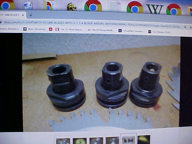

What is the physical difference between the Mark V 500 sawblade arbors and those used for the Mark V 505,510,520 and Mark 7? If you have answered this in a previous post, don't be discouraged. No man can illuminate another's mind until the appointed time. The light does not come on for each of us at the same time. Sometimes, it takes a different approach. Also, does the size of rubber gasket on the way tubes matter. I saw one in Doug Reid's video, https://www.youtube.com/watch?v=Q4DJFtjJR7c that is much larger than the one I have on my way tube. Is it just a reference point?
Are the arbors in the photo, mark V 500 or Mark V 505,510,520?

Ok, I really appreciate your response and my light is getter brighter. Could someone please post a photo of a 1 1/4 Mark V 500, not 505,510,520 sawblade arbor so I can do a side by side comparison. Thanks!
- Posts: 35457
Re: Shopsmith Sawblade Arbors
left one is liklely a Mark 5.shoedo wrote:Ok, I really appreciate your response and my light is getter brighter. Could someone please post a photo of a 1 1/4 Mark V 500, not 505,510,520 sawblade arbor so I can do a side by side comparison. Thanks!
Next two are likely MV500
Third one(longer) is mV505-520
Note all have a nut on the quill side and have a left handed thread.

The light is fully illuminated now. Thank you!
