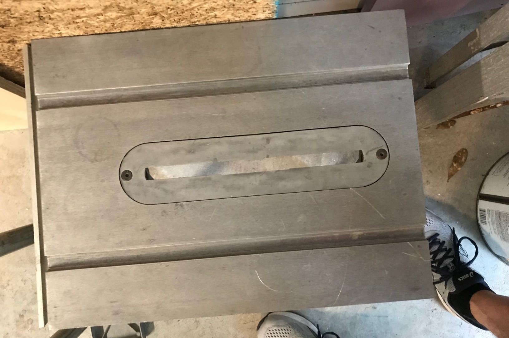

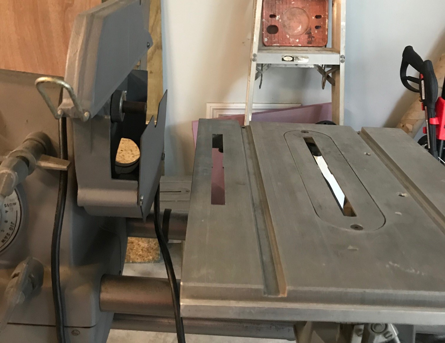

However, while going through what i did recieve, i found something puzzling.... I have (2) two large tables, I have no idea whats-what.
Can ya'll help identify them for me? Also, what am i missing?

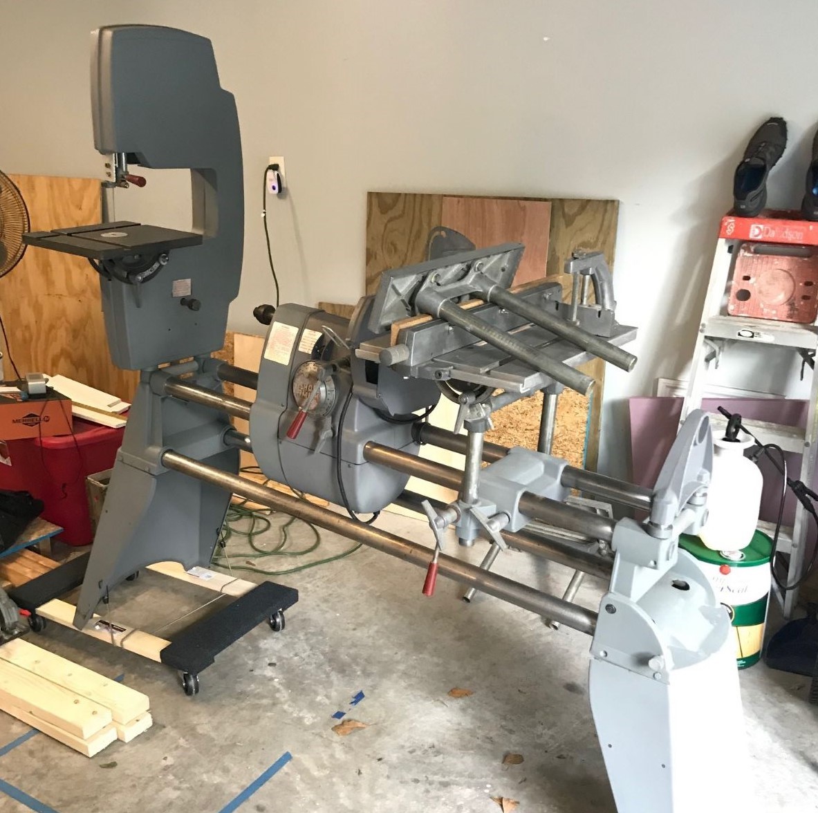

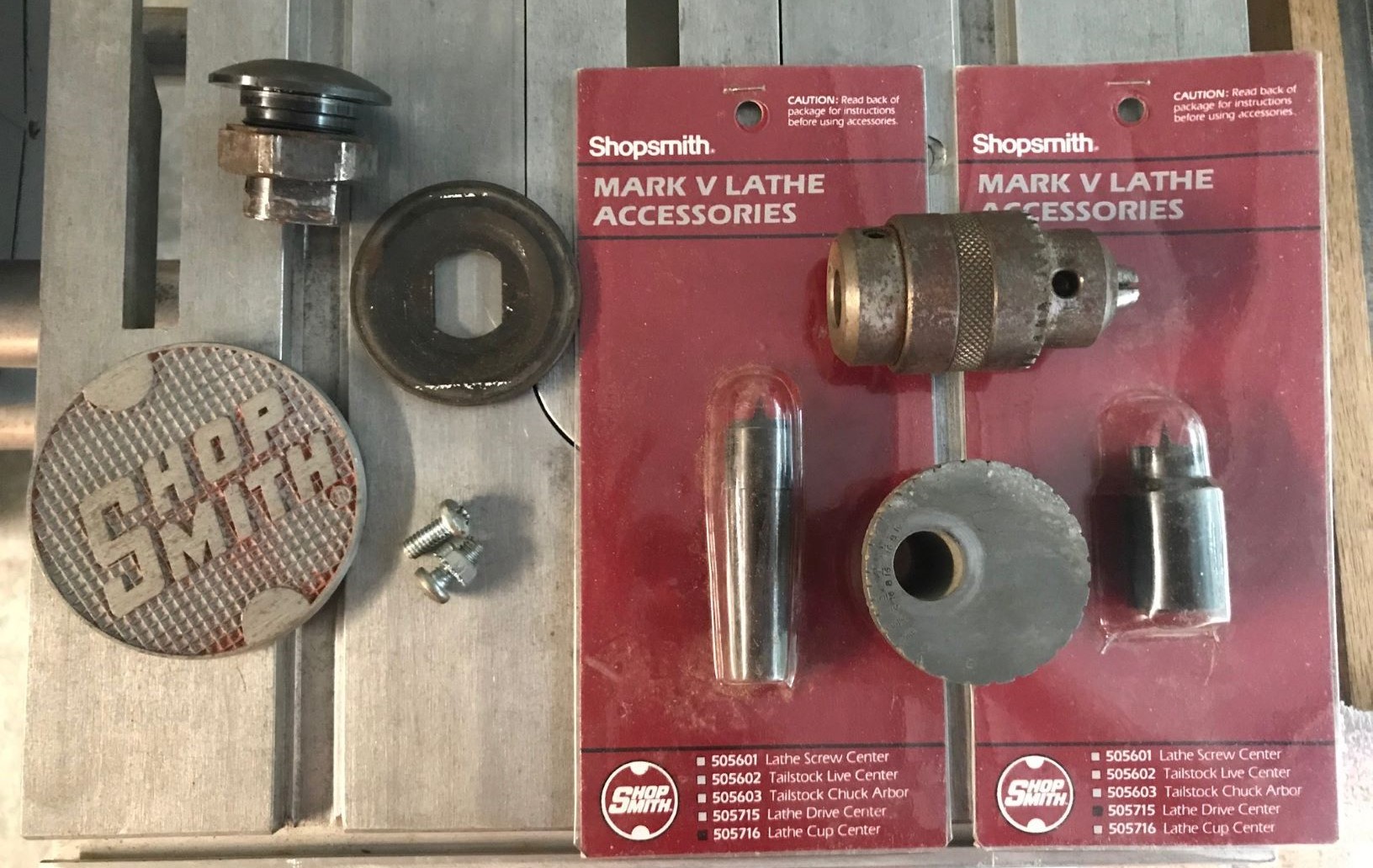

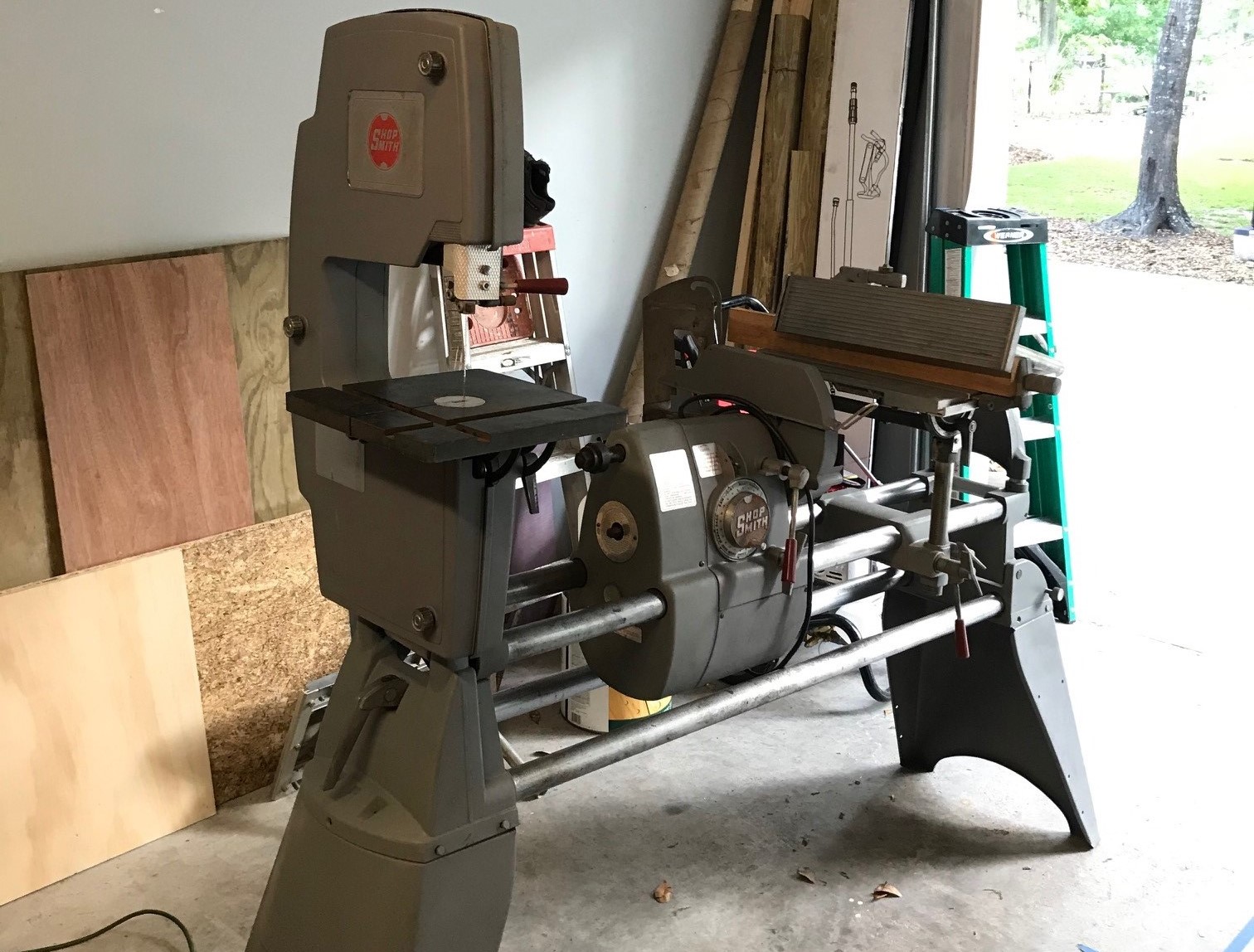

Three pics, 2 of the two different tables and 1 of the extras that came with it. Also included some pics of the unit i gave 300 for.

Accessories
Below are other pics of the 500

First, I think yours is older than 1988. Looking at the Serial Number guide on this website, probably made between 1973 and 1978, and closer to 1973 end of the range. https://www.shopsmith.com/ownersite/serialnumber.htm Date codes didn't begin until 1988 and the date code is 6 digits (month, day, year)
The table with extra slot may be original with the main unit. The second slot, intended to make ripping wider boards possible while fence is still on table, was discontinued sometime before 1980. (My 1980 model came with a notice explaining that the 2nd slot had been recently discontinued).

For $300, I think you got a good deal, especially since you also got a bandsaw and an extra table. And most importantly, it is in running condition!

- Inspection hole cover plate, goes on back side of the headstock
- Shopsmith saw arbor, takes blades bored to 1-1/4", you can get an arbor that takes standard 5/8" bored blades 555321
https://www.shopsmith.com/ownersite/cat ... arbors.htm
- Dead center, goes in tailstock for lathe turning
- Drill chuck
- Eccentric, mounts in the tailstock
- Drive center, mounts on the spindle for lathe turning.
