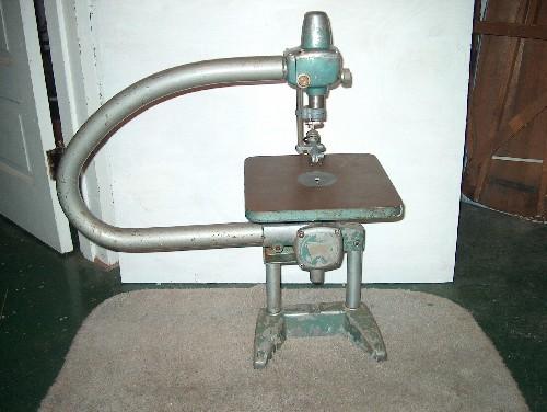

The first Shopsmith jointer was made for the 10ER, it mounted on a hinge plate that attached to a special headrest. When the Mark V was introduced the jointer was modified to mount with two tubes on the bottom, If your jointer has the two tubes on the bottom it will work on the Mark V
There was a jigsaw made for the 10ER, and it is 10ER specific.
There is also a jigsaw that was made for Mark V's
610 jigsaw-2.jpg (26.25 KiB) Viewed 11686 times

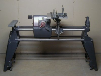

Let me first add my welcome to the forum. In your first post here you mentioned that you bought a Model 10ER and you believe a Mark V. John and Ron have given you some good information on the Model 10's. Let's see if we can identify your other tool and if it is a Mark V or not. A Mark V or if before 1980 a Mark 5 will look similar to the picture below. The first ones were painted in a Green paint scheme followed by a Gold/Copper paint scheme than Gray.
Mark V with Drum Sander attached
This is a Mark V with the original table system also known as a Mark V 500. There are other Mark V models with a larger table system named the Mark V 510 and 505 plus the Mark V 520 with the larger table system and the Pro Fence. Looking at the picture above on the left end of the headstock which is the belt cover there should be a vent plate around the lower shaft which has information including the serial number for tools made before December 1987. Those made after that have the serial and model numbers on a sticker. This should help you identify your Shopsmith.

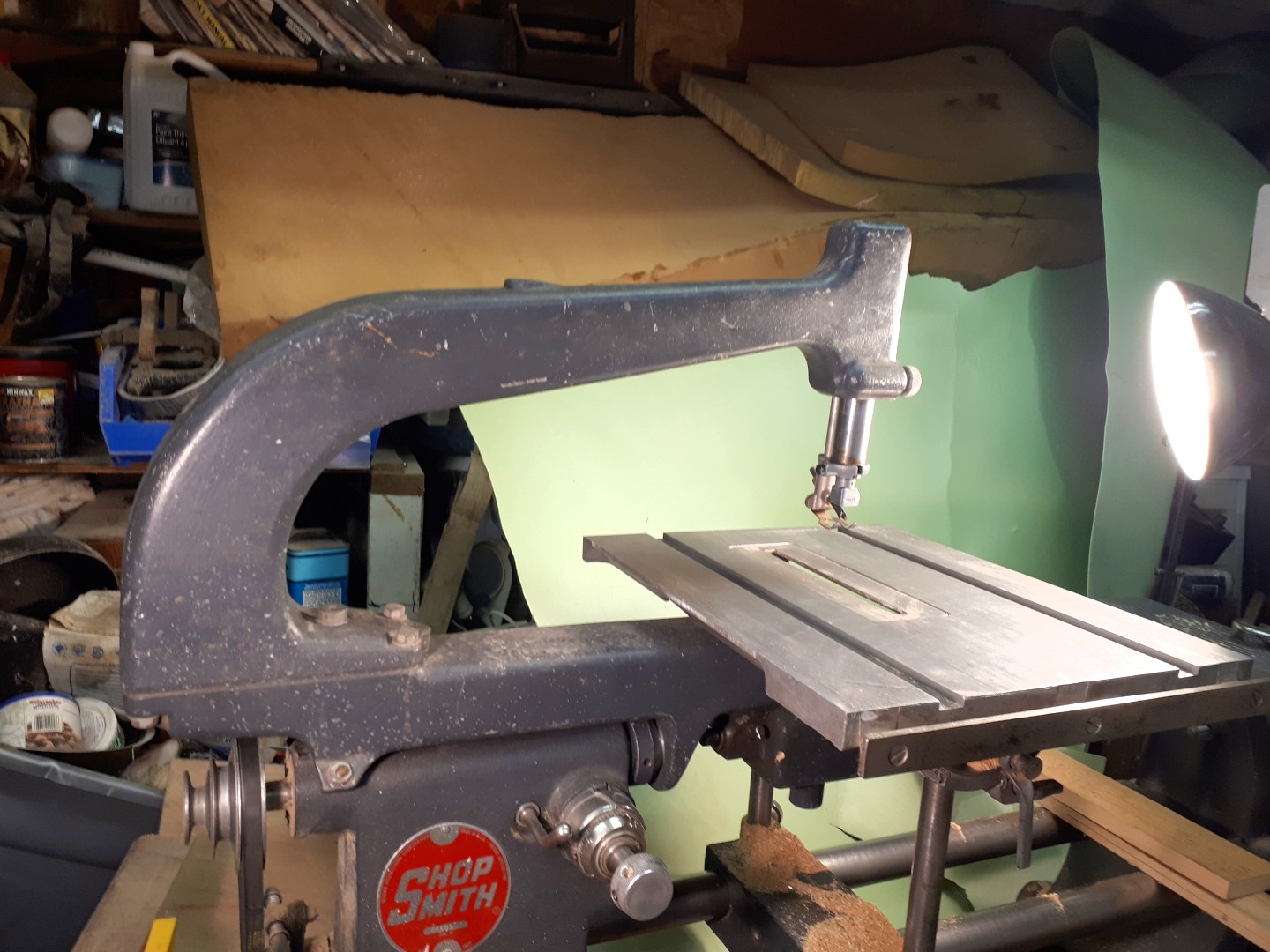

As Ron mentioned the Model 10's has two major accessories. The first was the Jig Saw P/N 134-1X or 11 100 followed by the Model 4E 4" Jointer shortly before the 10ER was replaced by the Mark 5. Below is a picture of my 10ER with the Model 4E 4" Jointer mounted and the P/N 11 100 Jig Saw in front.
R64000 with Jointer and Jigsaw.jpg (101.95 KiB) Viewed 11624 times
The Jig Saw was a common accessory purchased for the Model 10's so many are still around. The one in my picture above is the second version which has the partial belt cover built in. The earlier version, like the one in Ron's picture, didn't have the belt cover. It is important to note that since the Model 10's and their accessories were discontinued 67 years ago there are not new replacement parts available for them with two exceptions for the Model 10's other than common hardware. The Model 4E Jointer is less common to find since they came out shortly before the Mark 5. It was replaced by the Model 620 Jointer which has a different Base/Out Feed Table to add the mounting tubes for the Mark 5 from the original Model 4E Jointer's Base/Out Feed Table. All other parts were the same. Current Jointer parts can be used on the Model 4E Jointer with some assemblies needing to be replaced together. The 4E cannot use the Jointer Dust Chute but all other safety upgrades can be added to it. The Model 620 Jointer could be mounted either way using the tubes for the Mark 5 or Model 10's with the adapter or mounted on the Model 10 with the special headrest & bracket as my Model 4E is mounted above.

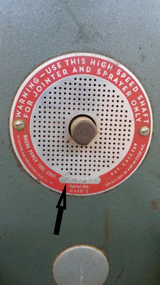

10ER is from 1953, The other will be a Greenie, also made in the 50's . The serial number will be on the vent plate around the lower shaft on the left end.

Posts: 4534
Re: ER and mark V tools
Here is a picture showing the serial number location as indicated by the arrow on the Vent Plate.
Serial Number Location.jpg (130.56 KiB) Viewed 11503 times
