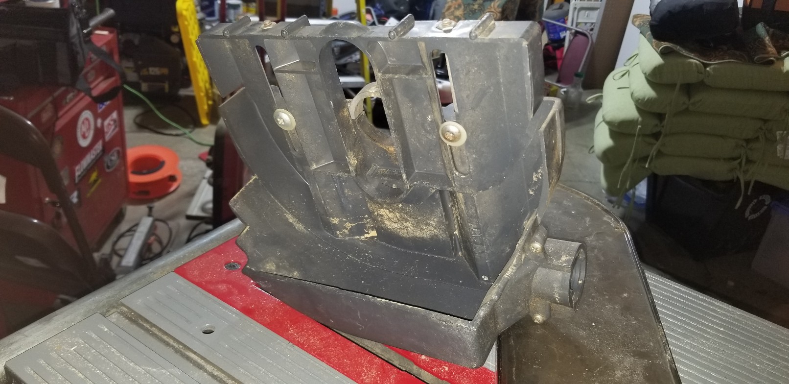

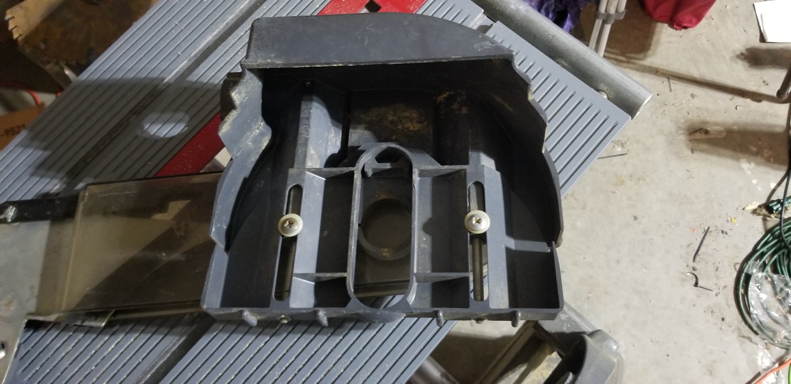

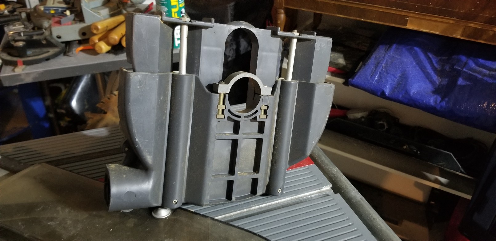

I was just gifted a 510 from my brother, and needed an upper and lower table saw guard. I found one on ebay, but being new to SS, I wasn't sure what models have interchangeable parts, so I asked the seller if his item would work on my machine and he said it would. Well, I got the guards and tried putting them on. The lower fits, but I cant figure out how the upper would attach. I've included pics to see if anybody can identify if these guards are for a 500 or 510, or if there is something available to make these work on a 510

That upper and lower saw guard are for a Mark V-500.

🤦‍♂️ I can assue that there isn't a way to use a 500 guard on a 510, is there?

Anthonycate wrote:🤦‍♂️ I can assume that there isn't a way to use a 500 guard on a 510, is there?
Correct, because the 510 table is larger the 500 upper guard won't mount properly.
The 510 guard has a riving knife that goes through the table insert and attaches to the lower guard. The 500 upper guard attaches to a block (included with yours) that attaches to the back of the table tie bar.
