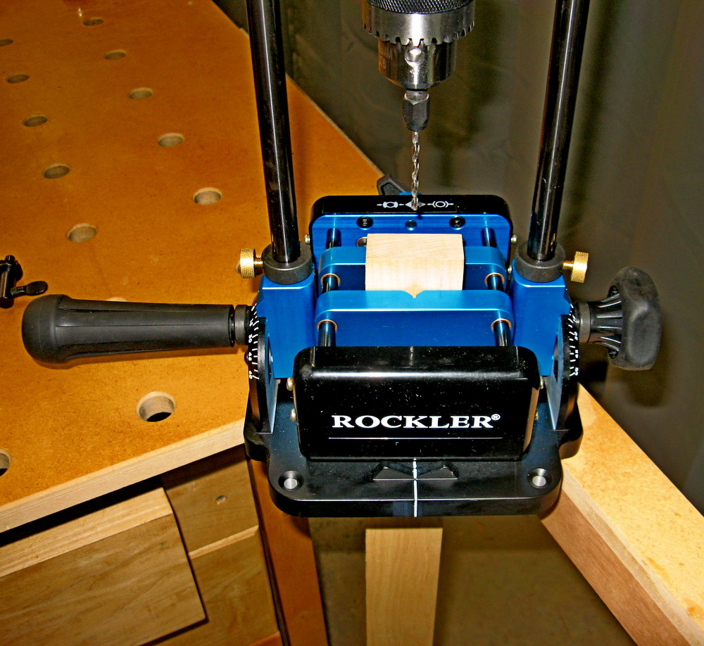

Have you ever had a job that you needed more than an 8 inch reach of the Shopmith drill press or just wanted to drill a hole or two with the accuracy of the drill press but not want to tear down Shopsmith that is setup in another mode. I find that issue all the time and until now there just have not been acceptable alternatives. That changed a few weeks ago when Rockler came out with this drill guide. To get an overview watch this video.
https://www.youtube.com/watch?v=JzSyi4u4P1Y

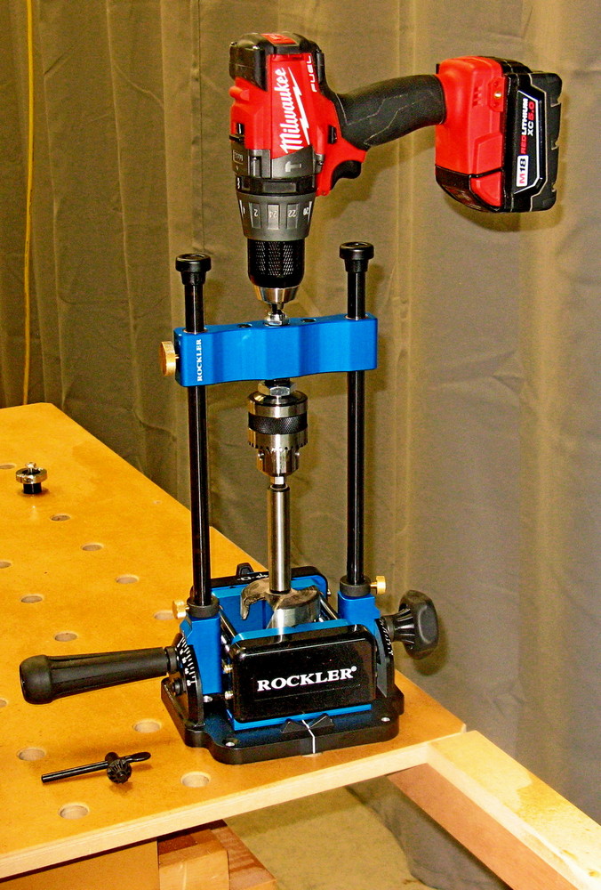

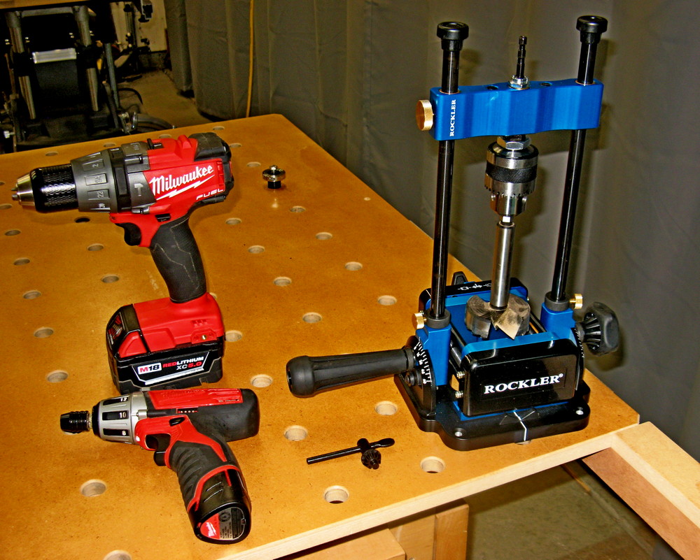

They sell the guide for $150 and the vise for $50 but I got the combo for about $160 on a promotion they had a few weeks ago. If it had not been for the promotion I probably would not have gotten the vise but I am sure glad I did. First off the guide is really heavy duty with an outstanding chuck and very smooth sliding action. The vise is very solid and adds a lot of mass and stability to the guide once installed and it does not interfere with any drilling operations. In the photo here I have chucked up the largest fostner bit I own and as you can see it clears the vise jaws when open.
- BigDrill.JPG (232.25 KiB) Viewed 17247 times

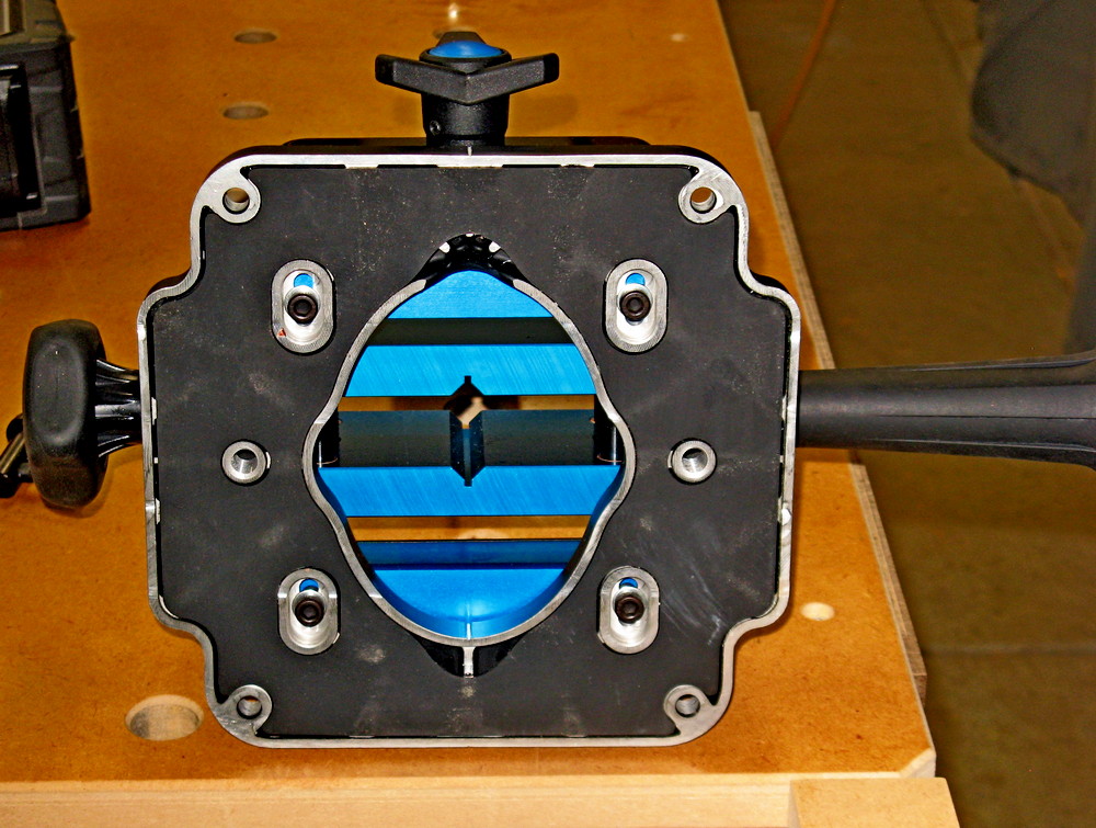

Even when using my largest ½” handheld drill the guide is stable enough to hold up both the guide and drill with no assistance. Once you put it in place it stays there due to the heavy duty rubber bottom material.
- Bottom.JPG (218.85 KiB) Viewed 17247 times

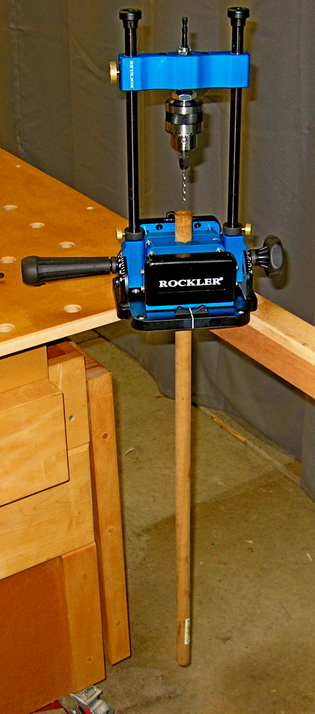

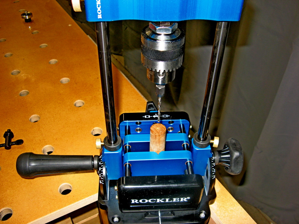

It has a lock to lock the drill in place anywhere on its travel and very nice stops that can be set for the desired hole depth. The centering vise is handy for drilling holes in the end of dowels or the ends of standard stock, things that you would normally set the shopsmith up in a horizontal boring mode for but the center vise makes set up faster and easier.
- Dowel.JPG (132.56 KiB) Viewed 17247 times

After a week or so of using it I have yet to find any flaws and use it frequently mostly with my smaller hand drill but also have the large one for big bits.
- BigBit.JPG (241.88 KiB) Viewed 17247 times

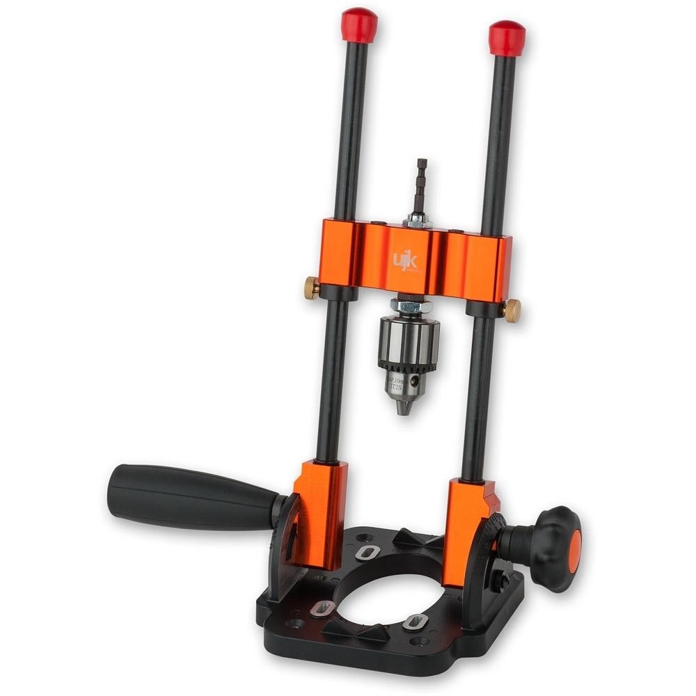

Yeah, I had a similar problem...I looked at all of the cheap ($40) drill guides and the reviews were terrible. Given the overwhelming negative reviews I didn't want to take my chances with them especially for the project that I needed it for had to be drilled perfect the first time. I believe the Rockler drill guide is the same one that UJK makes, but it is only sold in the UK and Europe from what I can tell. I saw the UJK drill guide in one of Andy Klein's YouTube videos when I was searching for one. Unfortunately, I couldn't find any place to sell it to me and ship to the US. My guess is Rockler is selling a re-branded or licensed version of the UJK drill guide (see pic below for UJK one). It is expensive, but if you really need one of these, I highly recommend checking out this Rockler one first before looking at other brands. Like I said, I have the Japanese brand one and it works well, but if I could have waited, I am sure I would have gotten the Rockler version instead. From the pic below you can see that the UJK one looks very similar to the Rockler one...in fact some of the aluminum pieces look exactly identical - either identical tooling or it was copied.
UJK Drill Guide:
https://www.axminstertools.com/ujk-tech ... uck-106072
- UJK_drill_guide.jpg (79.36 KiB) Viewed 17024 times
Rockler Drill Guide:
https://www.rockler.com/rockler-portable-drill-guide
- RocklerDrillGuide.jpg (103.48 KiB) Viewed 17013 times
