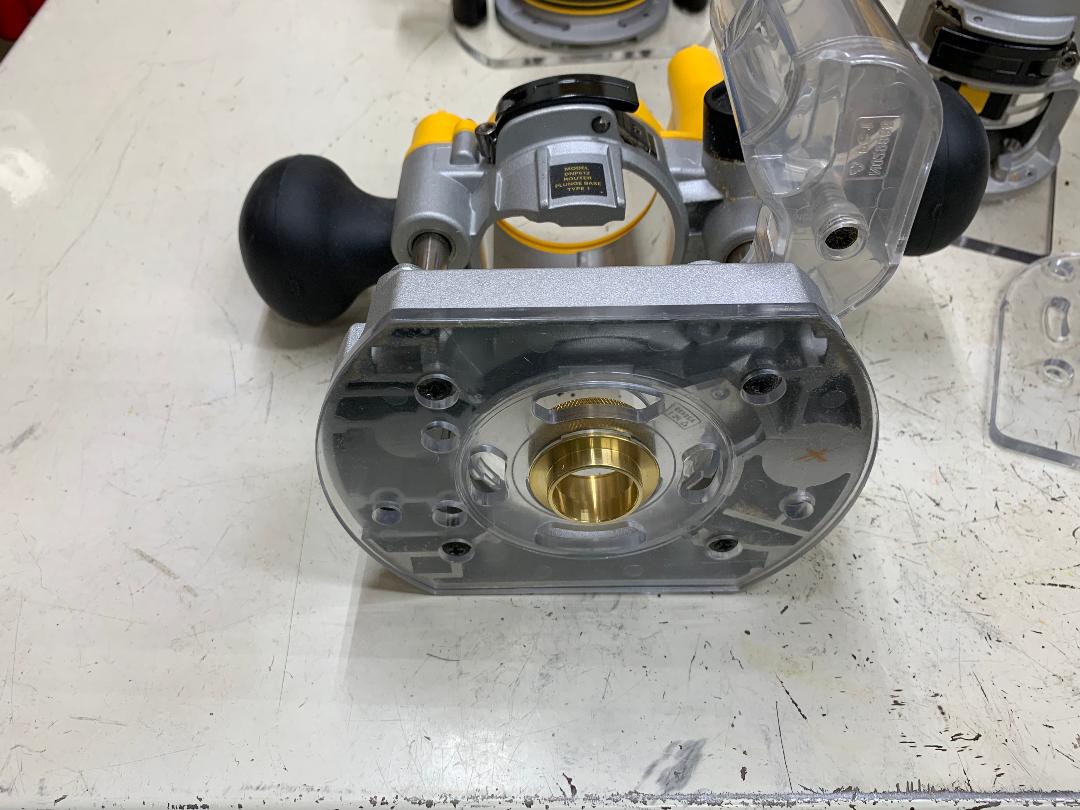

I got one of these a couple of months back and while it filled the two needs I had in mind I had to spring for the handles, a costly option but makes the router more rounded it is uses and feels great in your hands. They are pictured lower down on the same page.

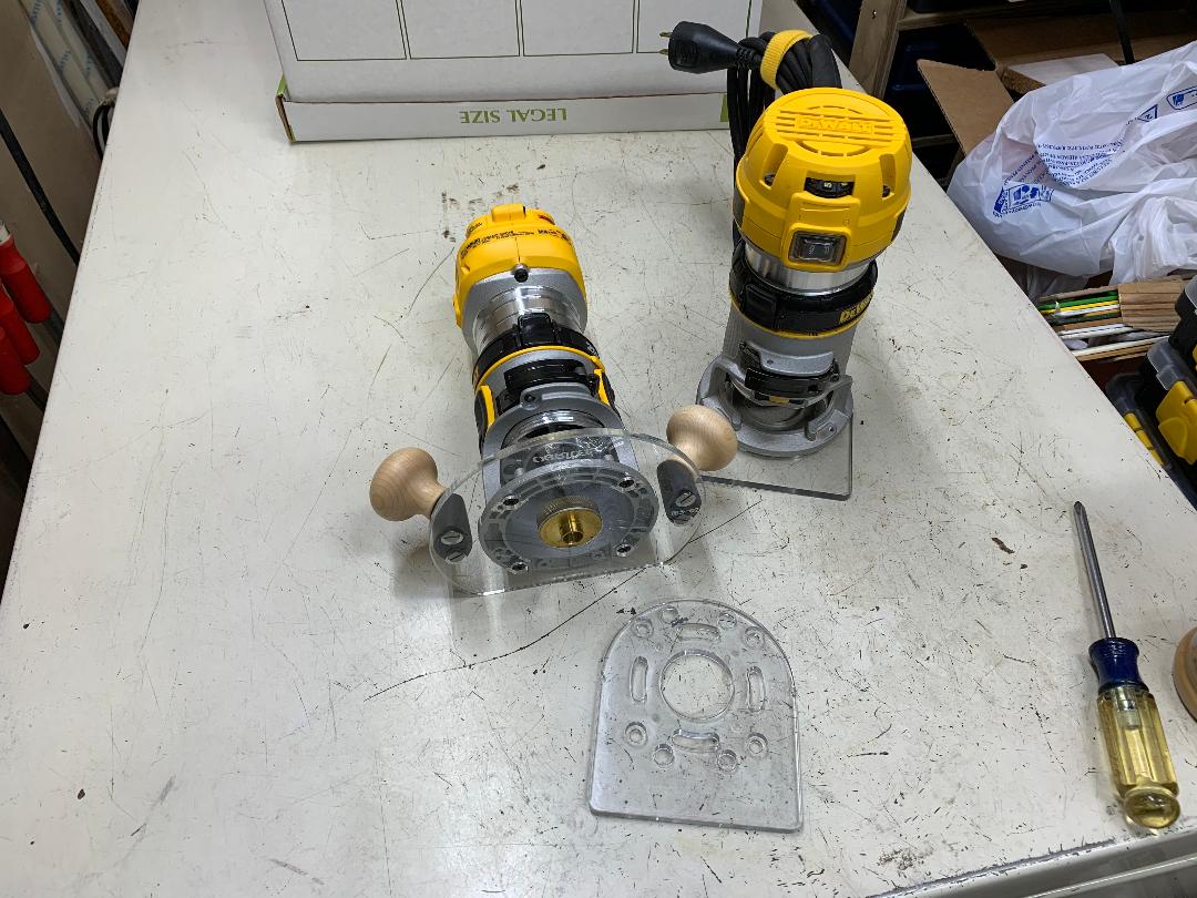

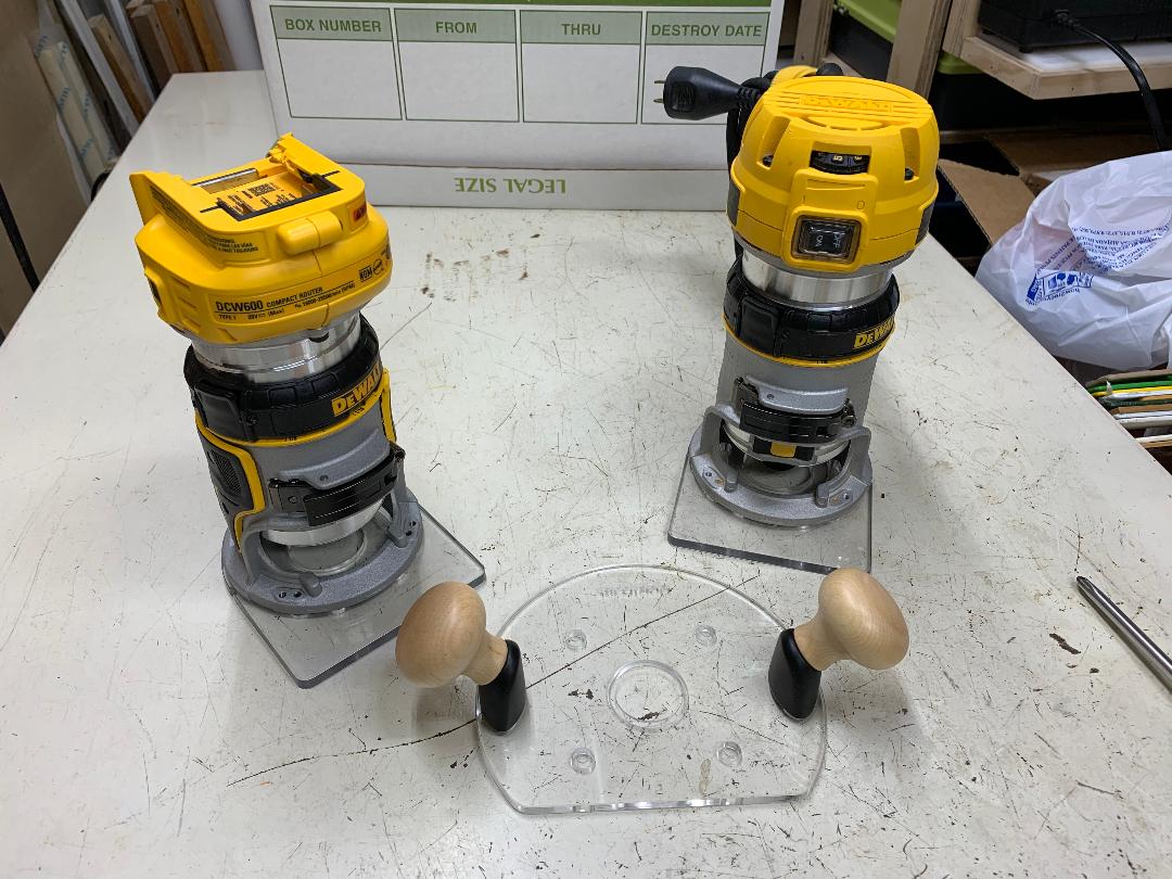

This is the pair of routers with the stock bases attached and you can see the new base plate with handles setting in front:
There are 4 screws to the removal and adding and as you can see the pc style guide bushings fit fine:
The fixed and plunge bases are interchangeable so it is now an even more flexible arrangement.

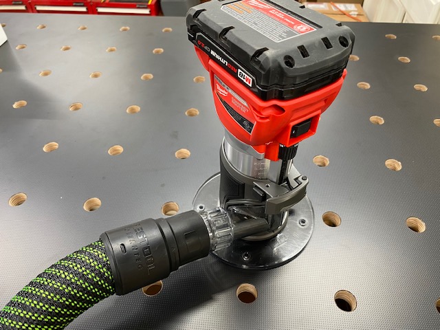

Doesn't the DeWalt DCW600B compact router have a dust collection accessory that fits on the fixed base? I believe it is part number DNP615 (https://www.dewalt.com/products/accesso ... ase/dnp615). I don't know if it comes standard with the router, or if you have to purchase it separately. I bought the Milwaukee version and it came with the dust port you can see below. The 36mm Festool hose fits it perfectly and I just loop the hose over my shoulder while working. It isn't as convenient as using the router without dust collection, but here in PHX it is too hot for me to work in the driveway for about half the year so I need dust collection.
I didn't even know that Lee Valley made acryllic base plates for compact routers. Unfortunately they don't have one for Milwaukee, but guess I could get the blank plate from them and modify it. Very cool that it lets you do template routing with their base, but I just don't know how much I would use it though. I only intended to use my cordless router for doing chamfers and roundovers, or edge trimming of laminate...

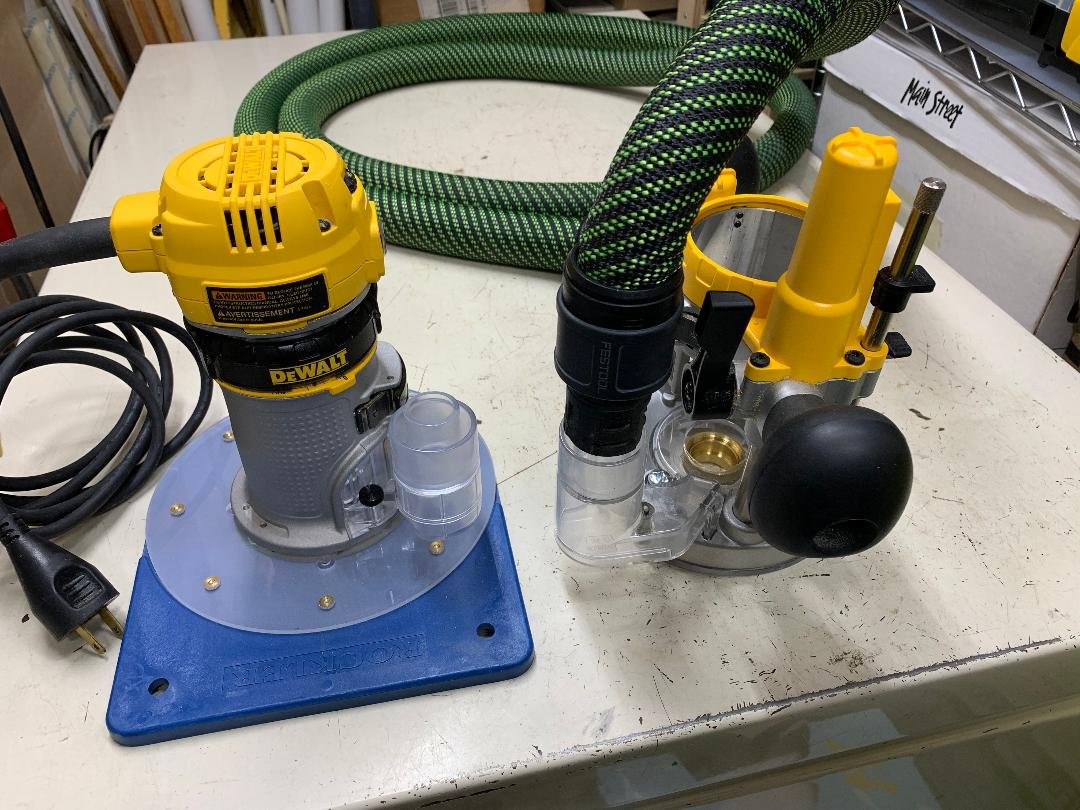

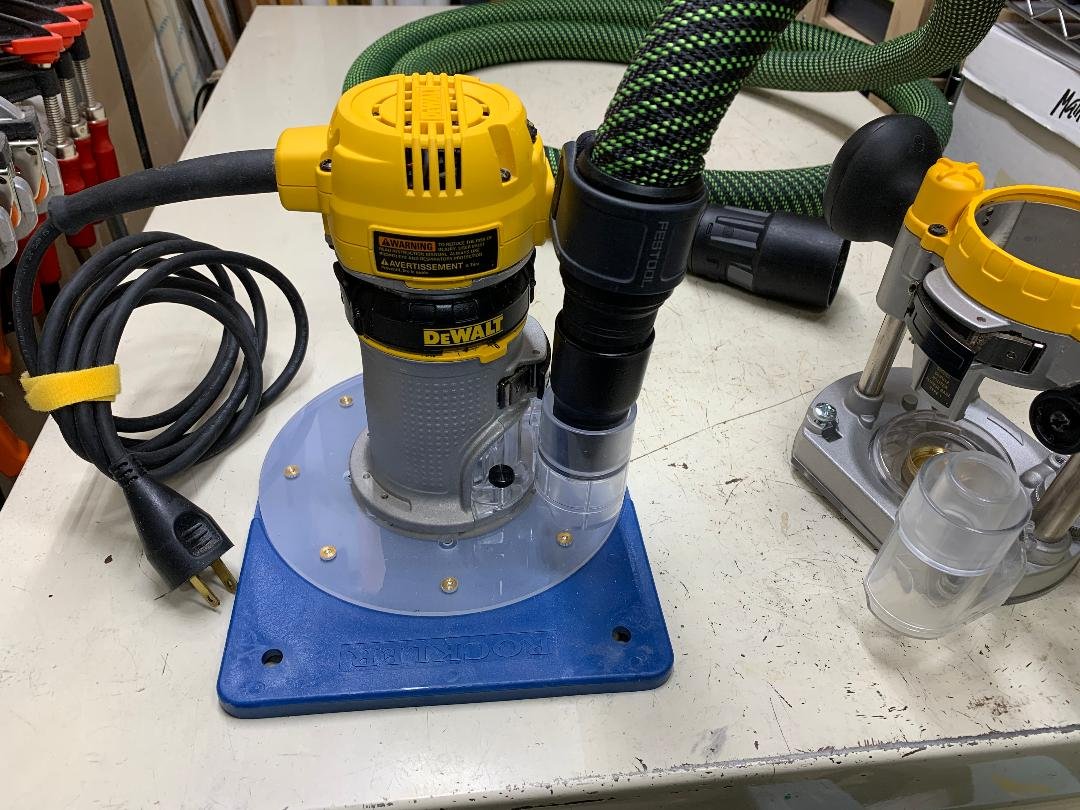

Yes they do have dust extractor hoods, the fixed base has a different one then the plunge base. I have one attached to each one and another waiting for the next fixed base to get here. They said today but it getting kind of late now??
So the port kind of fits the hose but not real well. I did find an adapter, Bosch I think that makes a better connection. If anyone needs the part number I can look it up.
Now if I could just find the time to use this setup on a couple of out standing projects.
Re: Veritas Compact Router Base Plate
Posted: Tue Apr 13, 2021 8:29 pm
by reible
This will no doubt get lost in time but for completeness here are the attachments to get dust collection on the Dewalt router shown.
The fixed base:
