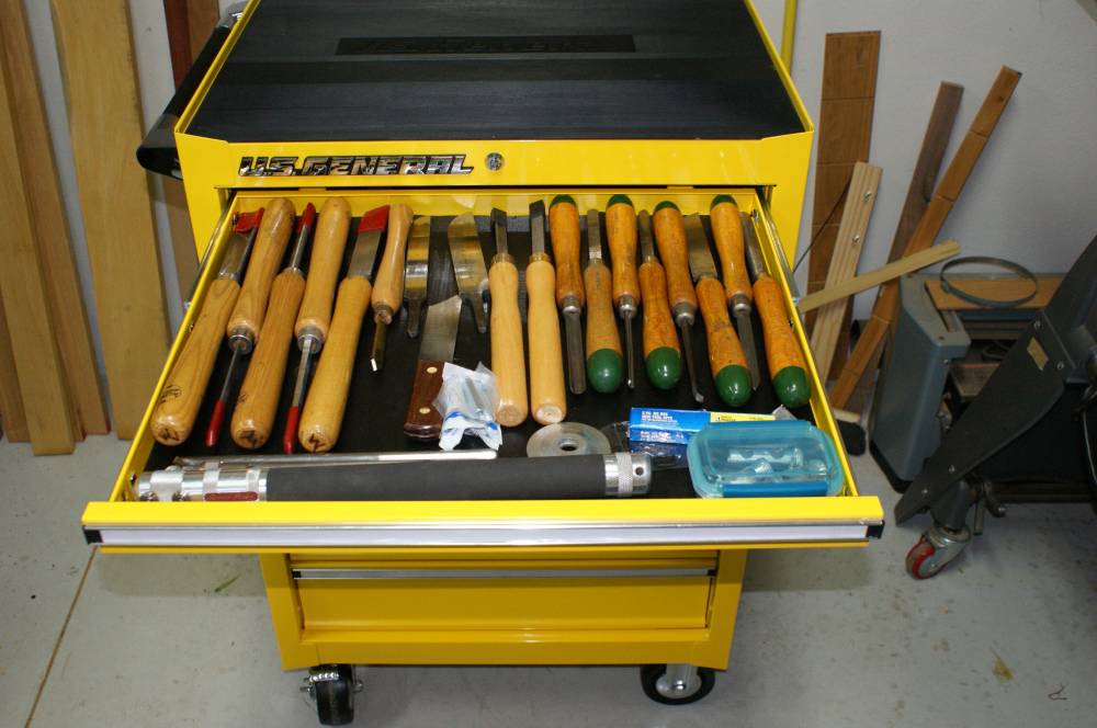

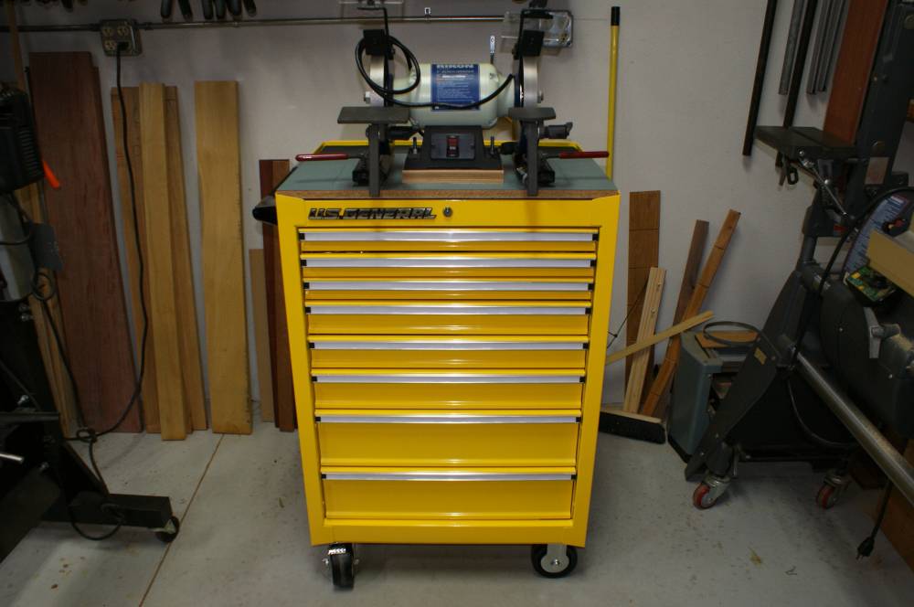

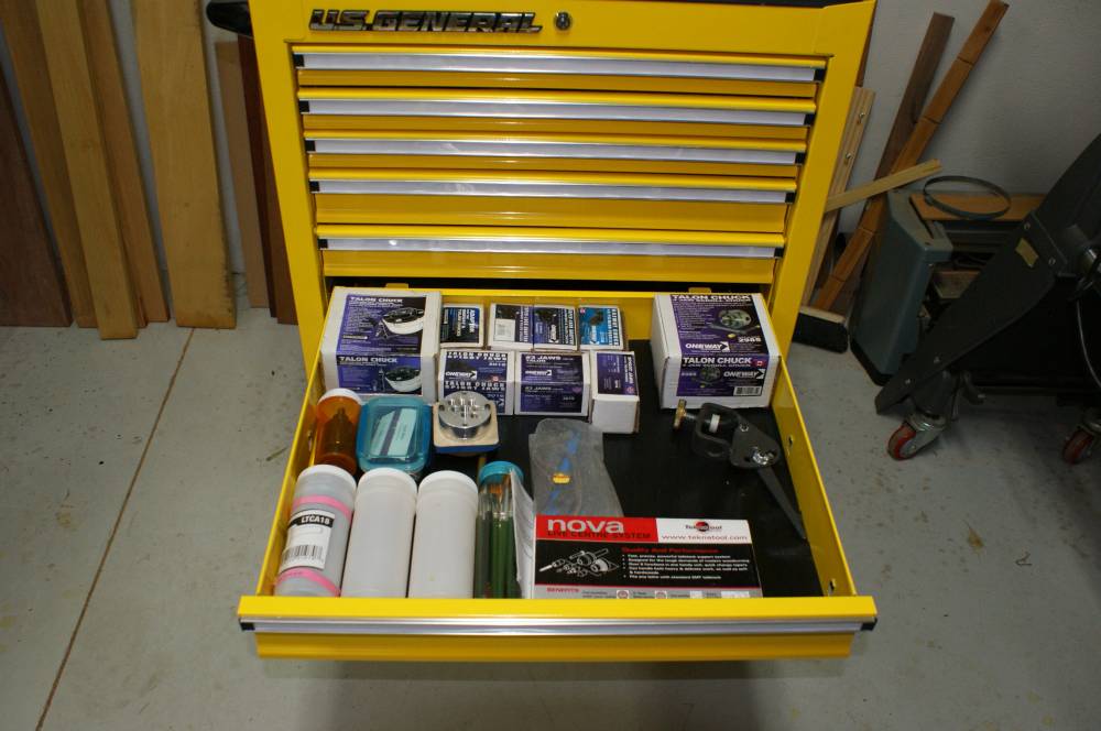

by wa2crk
Tom
I have the Rikon low speed 1/2 HP grinderand the Oneway Wolverine grinding station in my shop. I spent a fair amount of coin experimenting with grinding systems over the years and the one I have now is working out as the best. I wish I had some more guidance earlier.
Here is my sharpening station.
- grinding station.jpg (65.44 KiB) Viewed 9900 times
- deep drawer.jpg (75.53 KiB) Viewed 9900 times
- shallow drawer.jpg (75.69 KiB) Viewed 9900 times
Bill V

Thank You all for your imput. Bill V your grinder set up is WICKED nice. I like thing kept clean and tight as well so I appreciate your design and efforts. Well Done & Thankyou.
