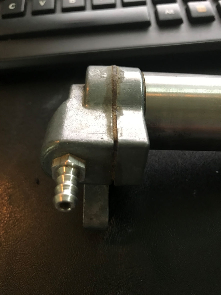

Does anyone here have experience with repairing the Jigsaw air pump? I understand it has a leather part that dries out and then the pump no longer works. I'm very interested in that part.
Is this where the leather piece is? It looks like it's sandwiched between these two parts. Is that correct?

If that's the case then how do you get this part to remove the leather piece?

Download the manual from this link. http://vintagemachinery.org/pubs/detail.aspx?id=10571
See the exploded parts diagram on page 8, ref #15
The seal is up inside the column.

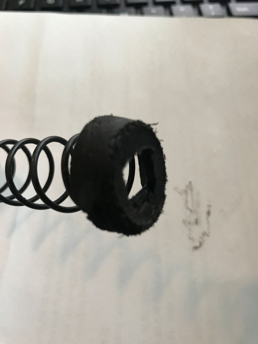

Thanks Ron. Funny I was look straight at it and never put it together that that was the part. This is going to be hard to replicate.

Have you tried just putting a bit of oil on it to soften the leather. Thats what I did on my A-34 (10ER) jigsaw See the maintenance section in the manual,
if you are making a new one, I believe the leather is formed while wet, but I have no experience on that
I have read of people just using an aquarium air pump instead, to get a better air stream. but again no personal experience.

Be aware there is a ball check valve in the lower part(s) you pictured(where the hose fitting attaches).

If the seal is not falling apart, still solid, add a few drops of oil around it and continue to use it. Shopsmith no longer sell this part like most of the Jig Saw parts.
