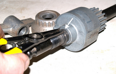

I'm not sure you really want me to show you this, Gil, but here goes nothin':
[ATTACH]76[/ATTACH]
1. Remove the snap ring that holds the quill spring housing in place.

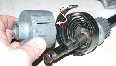

2. While pulling the housing off the shaft, work the hooked end of the spring out of the slot. Be prepared for a big, scary "SPROING!" when the spring comes free and it unwinds. Have a friend videotape your reaction so you can send it to America's Funniest Videos.

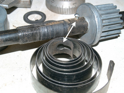

3. Using a needlenose pliers and all the patience you possess, rotate the spring so the slotted end slips off the pin on the quill feed shaft.

[ATTACH]76[/ATTACH]
4. Order a new assembly from Customer Service. It's a lot quicker than putting it back together.
